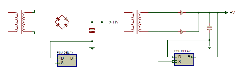

But if those switch resp. relay contact is located between anode secondary winding of the main transformer and the silicon rectifier (maybe trough a NTC inrush current limiter resistor) or even between the primary winding in case of separate main transformer for heating and anode voltage, I don't believe any potential for damage.

If you look at Dave G's article it relates to specific set of conditions - which are quite different to the OP's method of switching the power transformer secondary. So post #125 is bringing up a type of operation that is effectively irrelevant, and should have had a heads up on that matter.

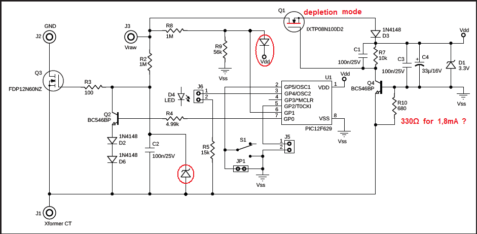

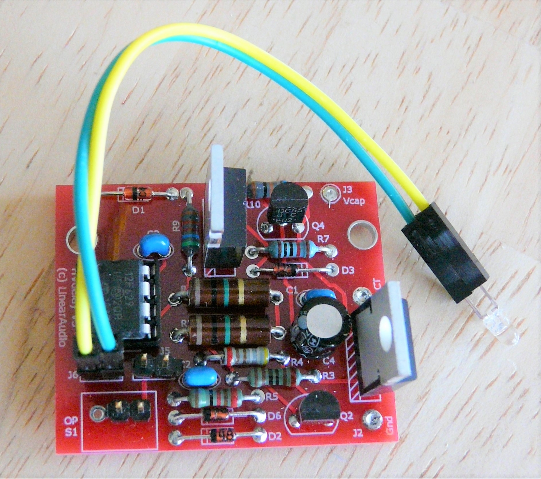

Hi Jan, bought two kits from DIY Store and in the process of putting the boards together. Two questions for the boards (v4):
1. My downstream of the delay is a MOSFET voltage regulator, this should be ok right?
2. You mentioned max 600V, what would min-V be to activate the board, say, for setting the delay time, without getting fried? Would >100VDC work?
Was puzzled by D5 on the board, but saw your previous post called for 12V zener.
Thanks for any info!

what would min-V be to activate the board...?
Tested, setting a new on-time, at 40VDC in the end, but 15VDC seemed to work just fine too. Good thing, don't have to worry about frying my fingers with high-V.
Oddly, the minimum time seems to be 22-sec/11-flashes, can't do any lower. I'd like about 10-15 secs, but this would be fine too. Have to learn to be patient...
Thanks, Jan, for helping out the DIY community!

I changed the supplied FDP12N60NZ for an IXTP01N100D after changing the amplifier it is used in to a higher (peak 540V) B+ value. The LED blinks and after the delay has passed stays on as set but the gate of Q3 doesn't get pulled up and it doesn't switch on.
It worked before the switch to the IXTP01N100D.
Does anyone have hints to troubleshoot and fix this?
Thank you very much.
