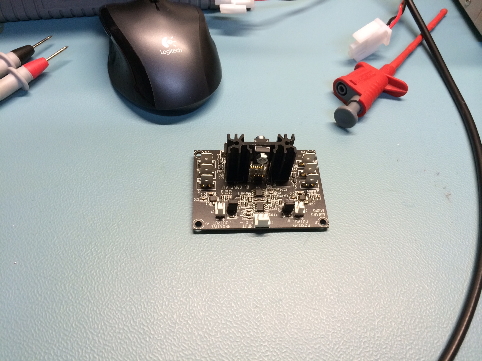

Ready for assembly and test of BL drive module

BL drive is to bridge Any type of AMP module. It works at up to +/-60vdc. The tssa V1.7 works at up to +/-35vdc . So to get higher power levels we needs to run it balanced or bridged.
The BL drive module Runs from the supply of the AMP . All power leads run to the BL drive module and get distributed to the AMP modules.
I will get exact power measurement In BL drive.
In single ended it is close to doubling the power into 4R.
It will be stable In 2R In bridged but the output power will not be doubled when running In 2R.
Smps will not be a problem. Only most smps is for more than 40v so the smps will be custom configuration .. For example audiopower from italy.
Cheaper smps is rather noisy. But we have an lc filter to the AMP to Solve This issue .

BL drive V1.1 first measurements.
First we have done some initial measurements.
DC offset with inputs shorted or non shorted:
Positive output: +320uV
Negative output: -199uV
Current consumption: 11mA
Gain measured between positive output and negative output +6dB.
Also look at the FFT measurements. I think they speak for them self.
One thing to be observed. Many designers have to long traces from decoupling capacitor and to V+ and V- on the opamp. This is addressed here ... 2mm at longest distance.

PS: thd+n is no joke or error. There is no difference.
So it would work with any power amp. even SSA frontend with its larger current fluctuation will not be a problem.
