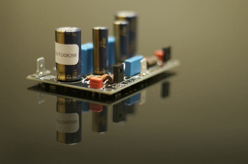

"Wonderful! Marvellous! ..."
It seems to me to sing like Ella Fitzgerald 😀
All six kits are arrived.
I'll tell you about the hp amp.
Thanks a lot, Sonnya.

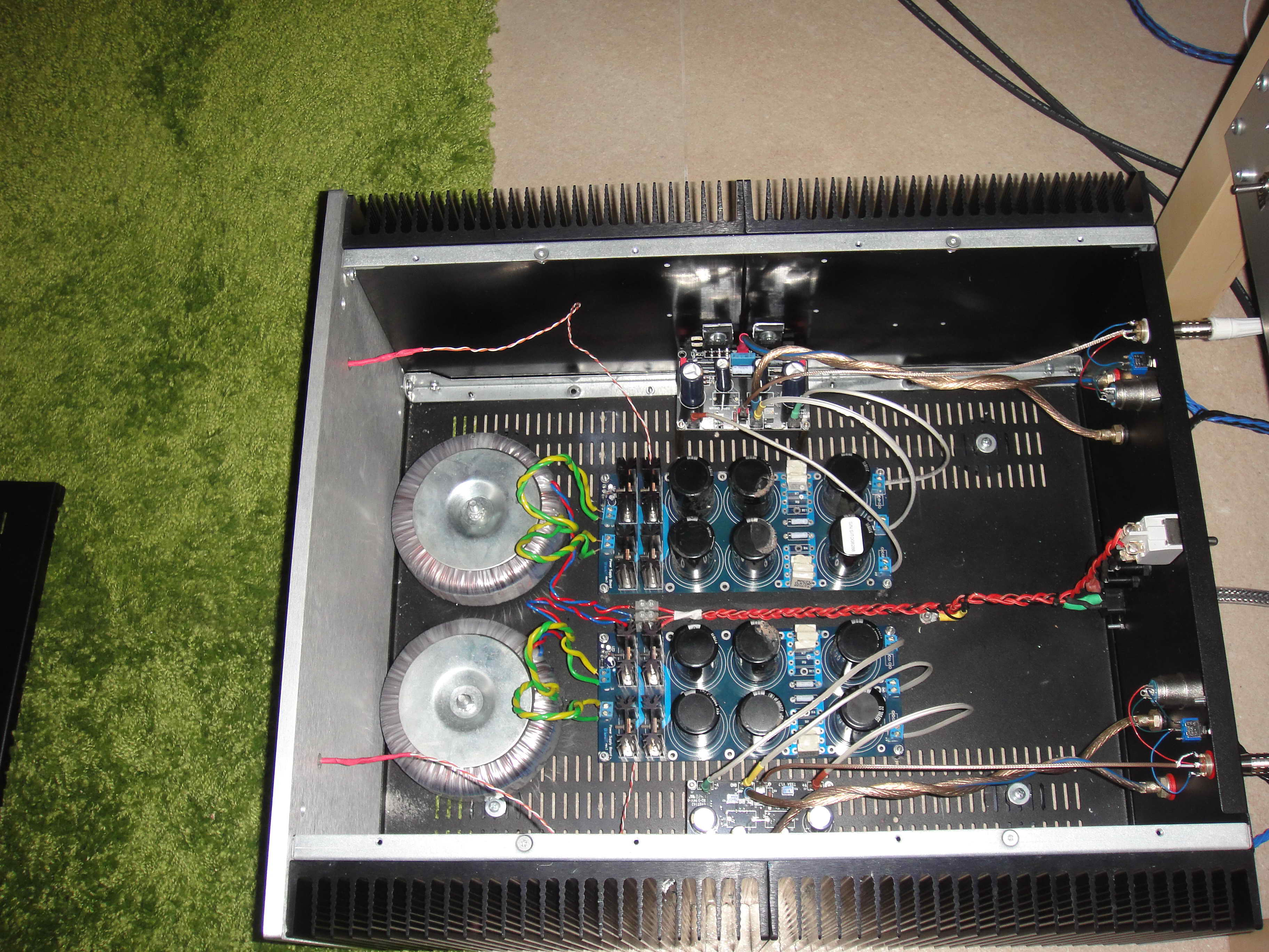

Here is my final incarnation of TSSA V1.7
Power supply is 132000 uF per channel and biased at 1 amp.
Sounds wonderful a I said before and really silent on 100dB horns.
Also I preferred it without the 1uF bypass on the feedback capacitors.
Seemed more transparent to my ears.

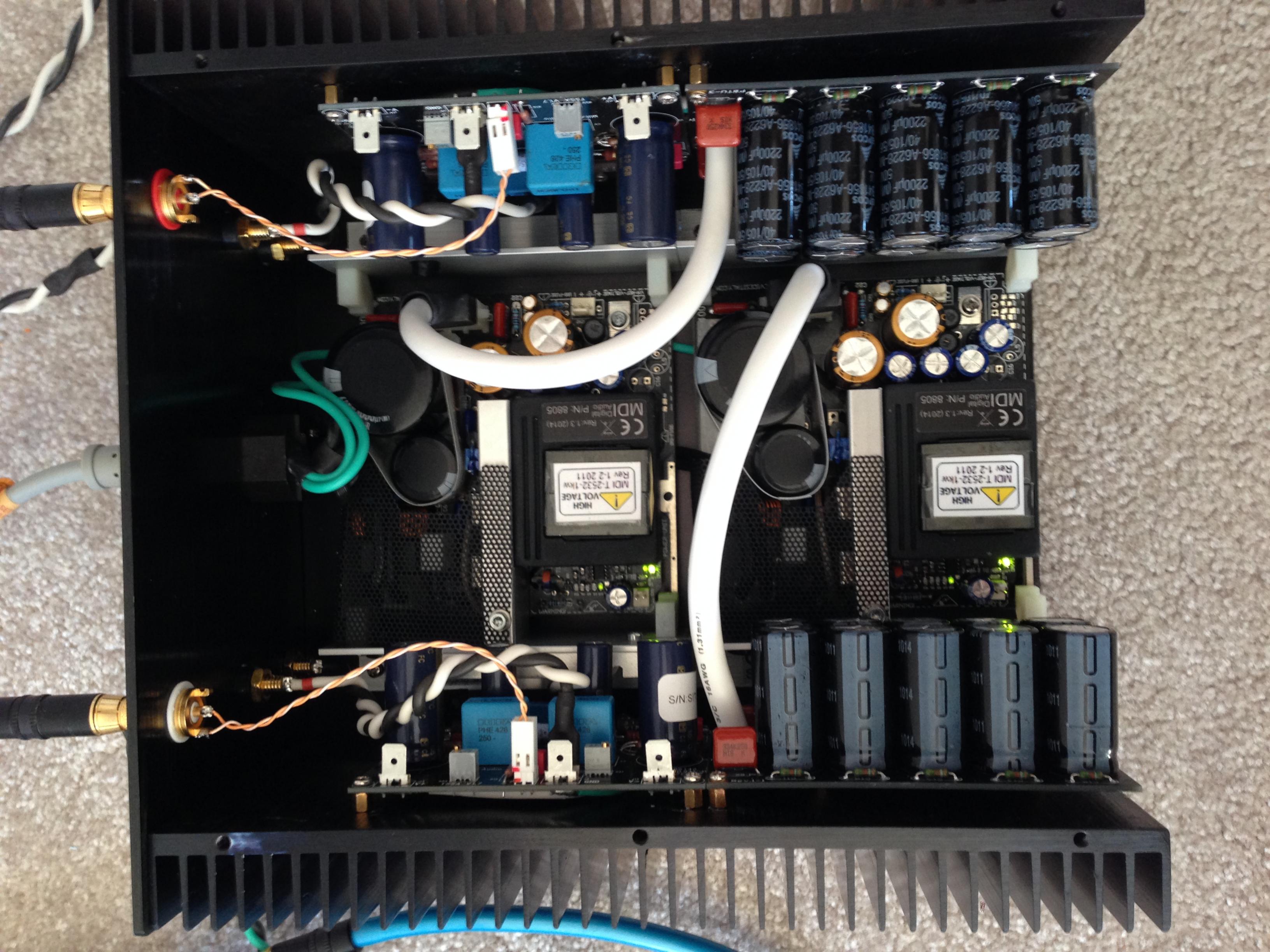

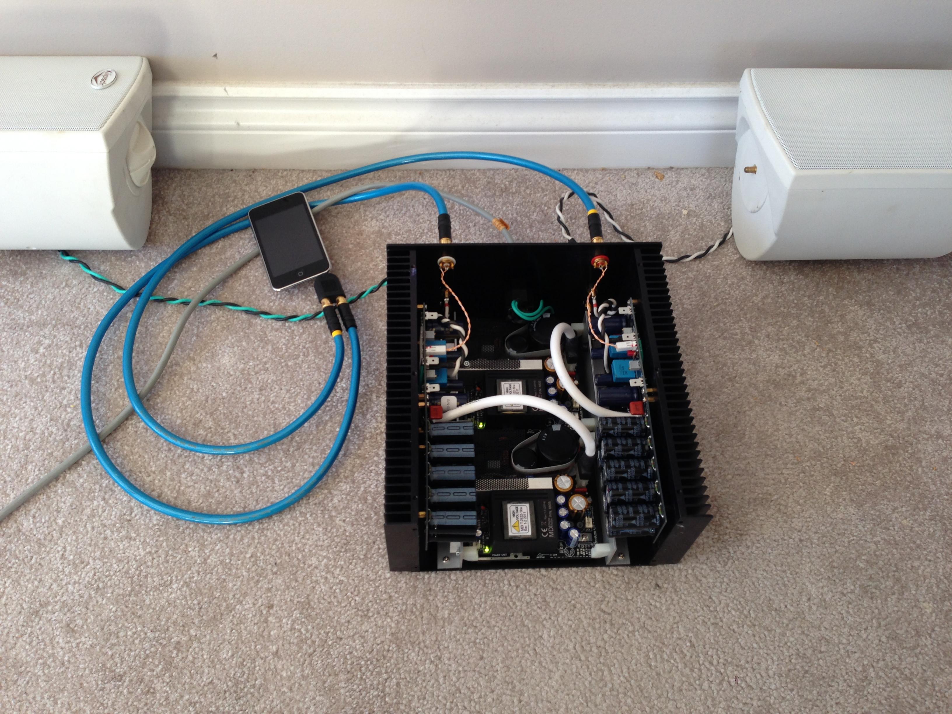

TSSA v1.7
Well Iv'e successfully made another beautiful music maker. The case was on the verge of not working, but turned out to be a perfect fit. Its running at 14*C above ambient temperature @200ma bias. It has dual SMPS DPS-400/S2/LV power supplies.🙂

It is a very Compact design you have made ... How do you Think the audiopower DPS-400/S2 works with the TSSA V1.7?
