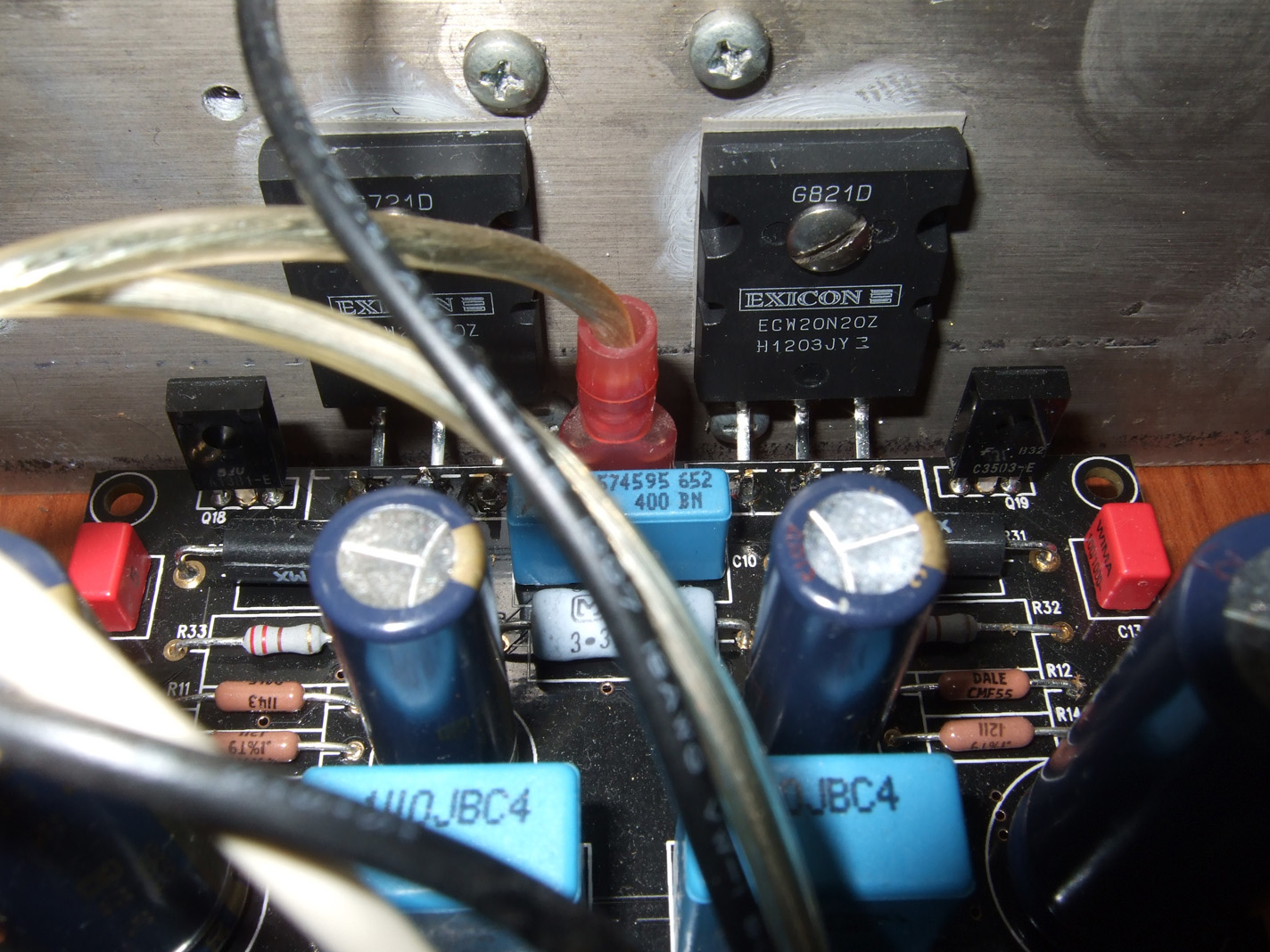

Time was high I assembled mine too. A better behaving amp version than the 1.6 for sure. Biases fast and stable -much easier than the previous- with miniscule offset. Some say use 240mA which is about 0Tc for double die parts (is it?), some say use as much as you can with MOSFETS to aid gm sag and extend the A part of A/AB class. I just went by comfortable heat criteria for my sinks so I let 450mA Ib circulate. PSU is the same, a second order Darlington Cmult with big Toshiba BJT on a chunky sink, F&T caps.
Listened only for a little, but it takes just a minute to know its a better amp than 1.6. Control, 3D, distinction, expression, are next level. Not sure if I could feel some subtly hyped mid overtone color, maybe the RIFA shunting the feedback lytics showing off a little but I should give it a week of play to say.
All in all a success. Sonny, congrats.🙂

And you use horns? Right !?
How is the noise level.
And thanks. Good you like it.
No, I use 95dB_SPL/W direct radiator 4 Ohm DIY speakers based on a couple of Taiwanese car audio ovals per side, a pro audio 6 inch French mid and a modified 1 inch Ti dome. Medium to small room still does not dictate that much of a controlled throw need. Noise level is church mouse quiet.
