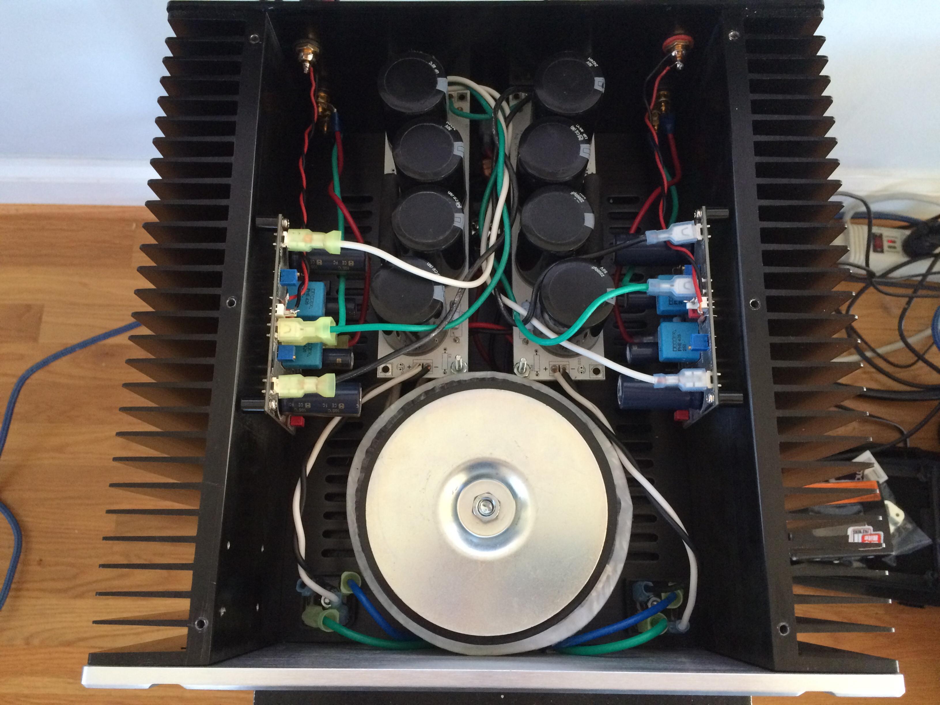

There is a new version of the TSSA V1.7 on its way. But any one can easily upgrade there V1.7 by adding the capacitor mentioned below.
Basicly we have moved the trimmer to get space for larger trimmers with more "turns".
And we have added a capacitor of 470p 100V NP0/C0G between Drain and Source of U2 (EZW20N20) it removed some low level high frequence oscillation. This high frequency oscillation i have only seen on some amp. But add it just to be safe... IT will not kill the amp though..
I have a part number for this capacitor: SR151A471JAR
The legs should be as short as possible ~3 - 5mm.
It can be purchased at Farnell, Digikey, Mouser.
From RS-Online it is : SR151A471JTR (2.5mm wide instead of 5mm)
But any 470pF 5% >100VDC C0G/NP0 capacitor can be used ... also SMT 1206 case...
Film capacitor is not a good choice here because of the oscillation frequency of >10MHz.

Can you give us the test set up conditions and test points to trace that possible oscillation in our own builds?

You mentioned the bypass cap before. It was going to be my next change.ight as well change Elco's as well. Thanks for the tip.
Used them for similar purpose in symmetrical Firstwatt F6 amp. Also used FG and RFS in that position.
Nichicon or Panasonic 16v 470uF. Not sure which. Will have to look.
In that amp capacitance value changed harmonic structure. It is beautiful amp in that it has so many ways to affect final sound.
No matter what cap you choose make sure they are low esr and esl type. C2 and c3 also needs to be at least 2200uF.
If standard types are used like "muse" the closed loop gain bandwitdh will be lower due to esl and esr values together with the 49.9R.
I will first remove bypass, then may play with type of C2/3 based on listening. Organic polymers tend to be very low ESR. Excellent job. Very pleased. Any updates on V4 or V8. Hope all is well on your end of things.
I am working on them both. Actually i am going to add monitoring circuit to all amps. I will give you all an Update on the amps tomorrow .. But i am not going to give more data away In public forum , more than what is necessary ... I am only mailing them to trusted members... Has to be that Way...
