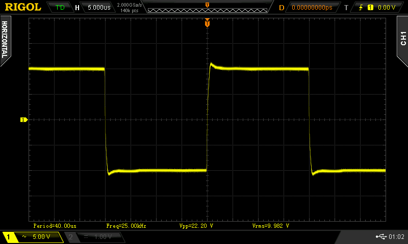

Here are the shots
As you Can see it is really high frequent... 43MHz so you will not detect it unless you use >60MHz scope
Sonny hi,
Got around to check mine too and when the output passed 38V P-P there it burst out. Could listen to the MOSFETS buzzing along too.😀
The 470pF U2 D to S cap cured it. Thanks.
BTW I still get a bit peaky corners square wave like this one. Its there if lower frequency test signal also. What best compromise method do you possibly recommend to iron it out?
