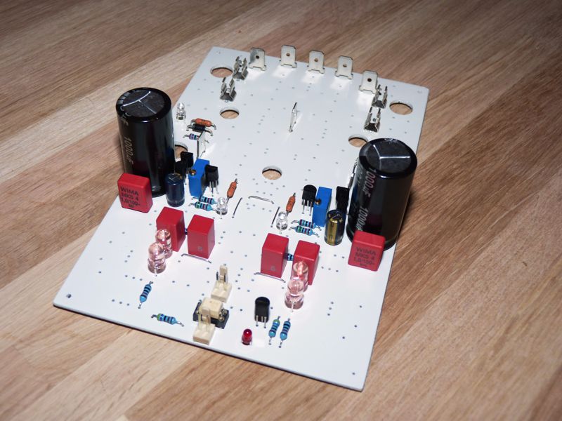

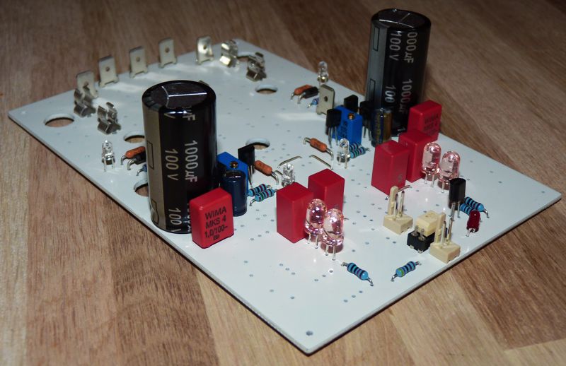

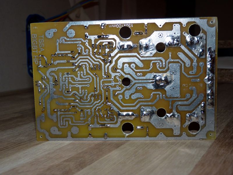

So here are start step, i soldered parts LC indicate me. These parts form the 3 CCS.
Hi Marc
According to red circles marked on TSSA BIGBT HP sch make following steps:
- connect +OUT pin to GND pin
- rotate VR2, VR3 to max resistance
- connect power supply +/-50 V and GND to proper PCB pins
- turn VR2, VR3 in a way that you measure 25 V voltage drop on R12, R21
- connect 9 V battery to J3-1, J3-2 and set value of R26 to get 37,5 V voltage drop on R4, R6
- check voltage drop on C6, C7, have to be app. 2 V each
- check voltage drop on VR1, VR4 TL431, it should be 2,5 V in both cases
- check voltage drop between pin 3,4 of TLP627, it should be around 0,2 V
- all five LEDs should lit too
By executing this procedure you have settled current sources/sinks to proper values. 😉

Hi LC,
Connections as you indicate are not yet made. They are easy as i just have to plug fuse in socket and made a cable jumper between out facton pin and gnd faston pin.
For TLP627 supply i have on my soft-start/ speaker protection board a 0-12Vdc extra out-put that i can use just by cable connecting.
I am on wrinting a new topic on TSSA BIGBT HP building we will continue further step overthere if you are aware for more clarity.
Marc

Hi LC,
OK, yes all necessary connections have to be made to power up the LEDs and CCSs.
Marc
Can you please postpone new thread until we make the amp running as planed. When it will work properly, than yes start a thread to inform the others about your amp.
