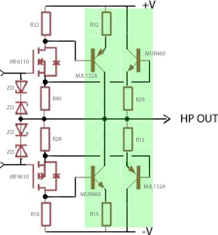

By the way, L.C, it would be interesting that you explain to readers the principle of your nice very symmetrical complementary power transistors arrangement.

What I do not understand is how the output transistors work in this circuit and how to work out the SOA for the transistors.

Give-me 5 minutes, and i will try to explain this ultimatly elegant power output stage.
On each branch (+ and -) of the output stage are paralleled NPN and PNP power transistors.
MUR460 and MJL132A. Each one has a resistor emitter (R32, R29, R13, R15) of 0.22 Ohms.
Let-us concentrate on the upper (+V) part.
When no voltage is applied to the gate of the IRF6110, this one has infinite resistance between Drain and Source.
MUL132A base is at the +V potential via R32, so, it does not conduct.
MUR460 base is at the HP potential via R40, so, it does not conduct.
Let see whats happens when we apply some V at the IRF6110 gate. His DRAIN-SOURCE impedance will decrease. So, the V at the base of the MJL132A will decrease, and, if emitter to base is more than 0,7V, will begin to conduct.
Symmetrically, because R32 and R40 have the same values, Voltage at the base of MUR460 will increase of the same amount, and it will begin to conduct too for the same reason.
Those two transistors will be paralleled to drive the current, across their 0.22 Ohms emitter resistance to the HP charge.
The ZD zeners are here just to protect the IRF gates.
This is absolutely beautiful, because perfectly symmetrical between +V and -V half waves, whatever disparities between NPN and PNP devices.
Notice that this idea will be a perfect response if we use some Power output FET devices instead of NPN PNP, to avoid the big problem of the disparity of the capacitive holes between N and P Devices. Clever, clever, so elegant !!!!
