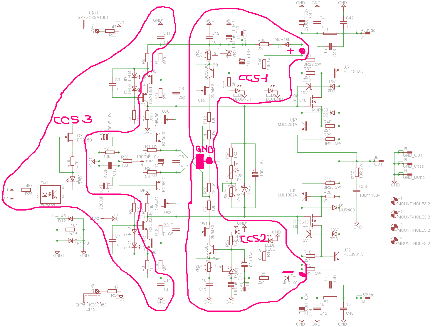

OK, please attach your sch according to PCB was made and I'll circle the parts to start with. 😉
Here it is

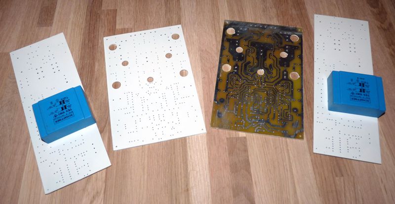

So after about 2 hours work, the 2 TSSA Pcb and the soft start PCB are drilled and tinned. They will go for white painting...
Marc
They will be perfect in white, hope that there will be no big modifications since this is still prototype only.
BTW, would not white colour stuff the drilled holes? 🙄
I just paint the component side not the underside with spray dose...
Marc
Yes I know, still can be stuffed from the top, only if drilled after the spraying?
For Quasi board i do the sae way without issue.
