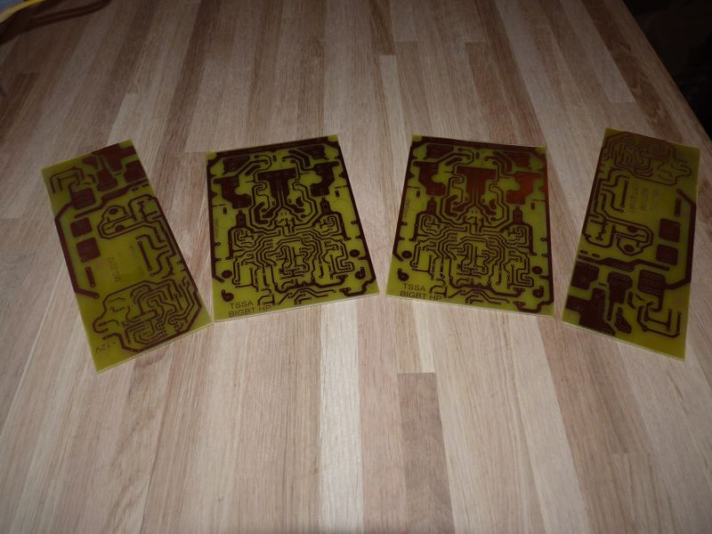

Hi LC,
You can prepare "TTSA BIGBT" procedure, i will etch new board this afternoon.
Marc
Very good, all details prepared to bring new TSSA amp into life.
I asume that all necessary transistors are matched, so we can start with CCS-s only, to set correct constant current levels needed. There are three of them on one PCB, so this will be opening part of construction.
Regards Andrej
Regards Andrej
I just have to mesure BC560 and BC550, all others are yet done.
Marc

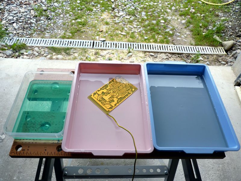

So here are the boards (TSSA BIGBT HP evo + soft start/speaker protection) and 2 shots of my diy etching procedure whith etching( H20/HCL/H2O2)/water/revalating solution(H2O/water)
Many years ago, lets say around 20, I did the last PCB by etching. The same chemistry was used and I still remember the smell and bubbles from the process, and worries that the reaction would be to fast, to hot etc. But the moment of glory was there when PCB tracks appeared from the foggy bursting fluid reaction. Always happy moment when finished, brought a big smile to my face.
Many years ago, lets say around 20, I did the last PCB by etching. The same chemistry was used and I still remember the smell and bubbles from the process, and worries that the reaction would be to fast, to hot etc. But the moment of glory was there when PCB tracks appeared from the foggy bursting fluid reaction. Always happy moment when finished, brought a big smile to my face.![]()
I like this moment to...the pcb born after spending lot of time on computer to route project. The procedure is quite easys. I do it in front of garage door so no soucy with bad vapour...
Marc
Idefixes,
What is your procedure for etching. Sometimes mine turns out great, others not so. I have never done two stage method.
Idefixes,
So
- printing with laser printer on transparent paper named "papier calque" in french
- expose under UV fluo bulb about 150s on Bungard positf PCB
- revalating in mix of 20ml NaOh + 1L distilated water
- wash in fresh water
- etch in mix of 200ml distilated water + 100ml HCL + 100ml H2O2 (Give big warning to mix in the order i gave you above it can be dangerous if not). The time wil depend to Cu to dissolve on pcb. You must controle process.
- wash in fresh water.
Marc
