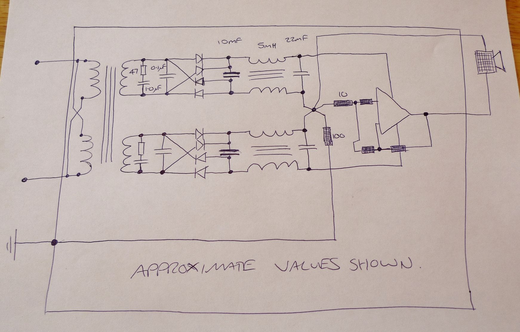

I began my experiment with choke regulation by going for simple full choke regulation ( Luddite tendencies ) but now I am thinking of letting the chokes deal with only VHF and letting more conventional regulation deal with the audio frequencies. I think this will give best overall AC & DC regulation but having said that I am very satisfied with the subjective performance of full choke regulation. I recommend chokes in all power lines from the transformers.
I always design my supplies in spice but didn't have much success with transformers & inductors in LT spice.
Two things have to be considered - how the supply behaves in use & how it behaves during turn on. These two factors can pull in opposite directions and so we have to balance between them.
If the overall DC resistance of transformer & choke is too low the supply can ring & go over voltage during turn on. If there is too much DC resistance the voltage will drop too much during loud passages. The tendency for ringing can be reduced by having the cap after the choke larger than cap before the choke.
This is a reasonable starting point for Full choke regulation:

each coil perhaps 0.1R
I use the secondaries of regular EI transformers as chokes and they work just fine.
The DC polarization will mean the effective inductance is less than measured inductance - but you can make allowances for that.
But if you would like to PM me your detailed criteria I will check out something in spice and optimize it for you.

The other CLC (with big caps) I used to do is after the rectifier, usually before a cap multiplier. Class-A amps of course, like my TSSA.
If you put the chokes before the diodes the resultant PSU internal impedance is very high so this kind of regulation is only suitable full class A which needs constant current.
Chokes after the diodes is much lower internal impedance so is suitable for Class AB & Class A.

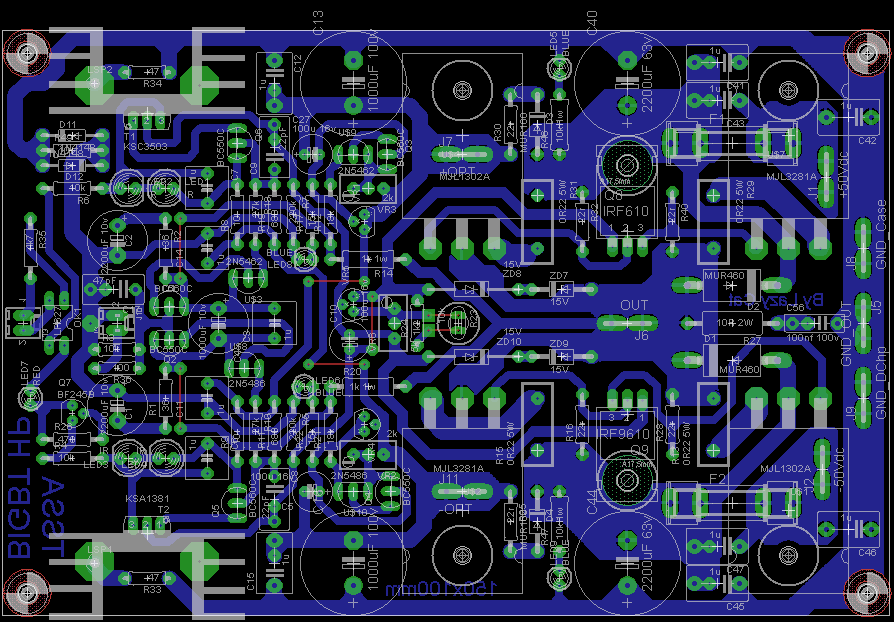

Hi Esperado,
Here's the modification for feedback resistor feeding
Marc
