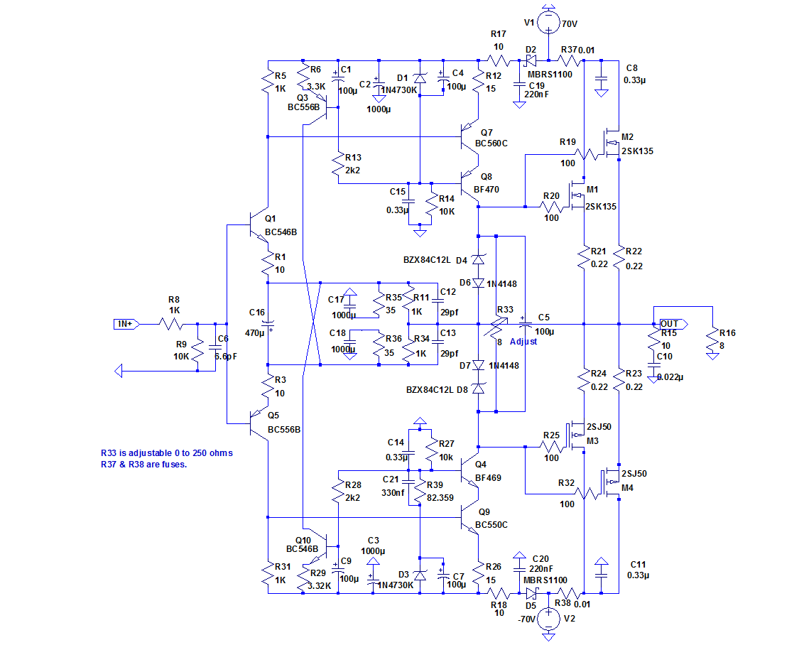

O.k. I did backtrack down to page #80 and could not find any schema posted by Christophe (I just did it again 🙂). I just see (in the previous message by Joachim) a reference to a schema, so if someone will re-post it, or show a link to it, then I will be a happy lurker again 🙂
I have the schematic.
What do you think Frans : is R33 = 8 Ohm ?
Yes, in both schema's, and that seems a bit(under statement) low (for the bias adjustment).
The mosfet in use http://pdf1.alldatasheet.com/datasheet-pdf/view/63173/HITACHI/2SK135.html has gate protection build in, so why bother with external protection.
Also, I see (now) that the gate-source cutoff voltage at 100mA and Vds 10V is 0.15 to 1.45 Volt that may just be fine with the 8 Ohm bias regulator.

About thus adjustable resistance on my schematic, it is a value for sim.. I will have a look of the value of my adjustable in real world as soon i get some time and courage..
Original schematic of the Crescendo found here:
http://www.solaris.no/electronics/power_amp/elektor_cresc/cresc_1280.gif
Value of the adjustable was 250 Ohms (unchanged -if i remember well- on my modified board.)
In the simul, value of the resistance was tuned for 150Ma of quiescent current in each Power mosfet.
Again, this mod was just for demonstration of CFB versus VFB.
I had tuned my board in real world in a first time, then closed the box with no notes.
Few weeks later, made and publish the simul as i was delighted by the improvement . Not sure the simul reflect the exact value of my real amp.
