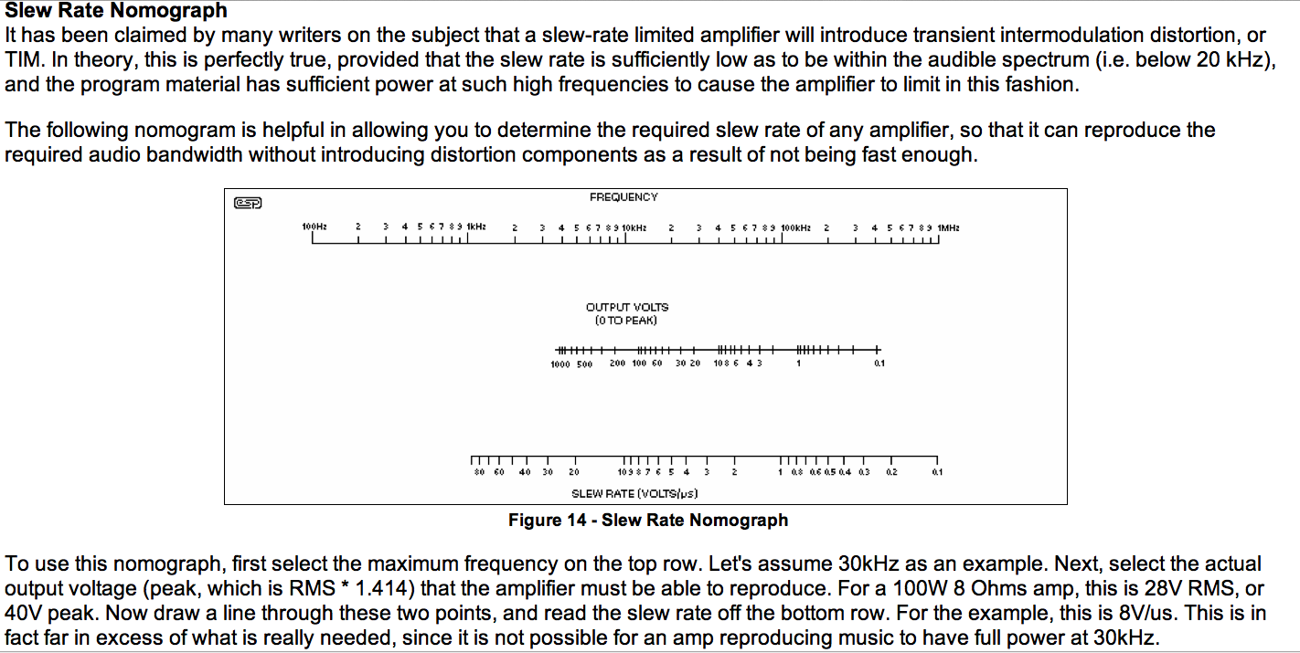

Here is a slew rate nomograph that shows how much slew rate is required.
I think Dadod knows what the difference between open loop bandwidth and bandwidth is.
I have participated in threads where we also discussed if it is more beneficial to raise the open loop bandwidth or go for massive gain in the bass. Unfortunately we did not find an agreement so i gave up.

Joachim, i don't realy understand your monograph with *fixed values*. For several reasons.
One is TIM and IM continuously *reduce* as much you are reducing the slewrate of an amp.
On the amp i was comparing Voltage feedback with so called "cureent feedback", same schematic, i simulated (and measured) the followings, with the same closed loop gain:

The nomograph is from the Elliot sound pages and he is very concervative in terms of required slew rate. There are more examples when you google the article. He comes to the conclusion that a 10W amp needs only 2V per usec
to swing the highest audible tones.

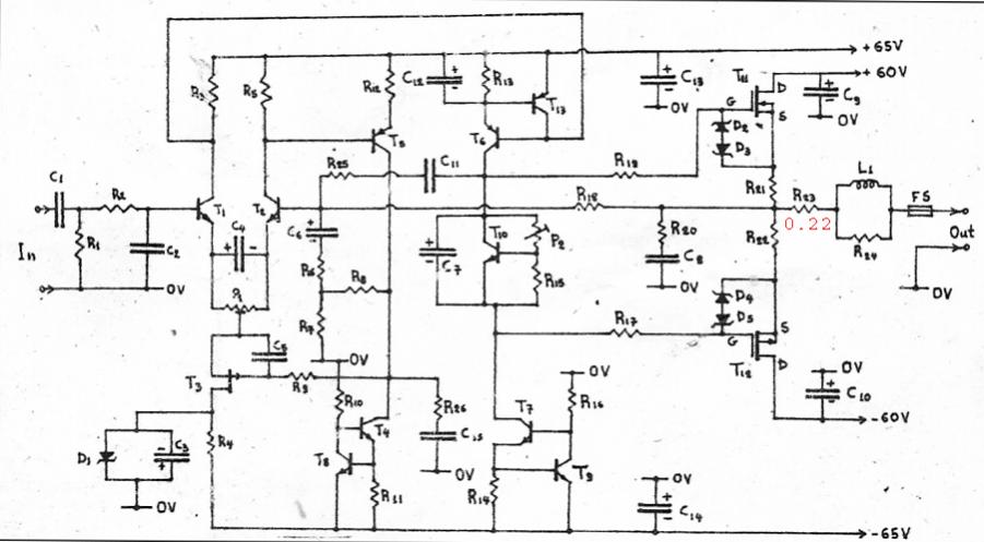

JLH 80W MOSFET amp has 0.22 ohm at the output so there is no high damping factor and still I like bass produced by it. I have closed box loudspeaker with not so efficient bass driver(Scanspeak 18W/8545-00) and the bas is so good. I was thiking to add 0.22 ohm resistor to my TT amp(very high DF) as aditional louspeaker output and in this case I can choose low or high damping.
dado

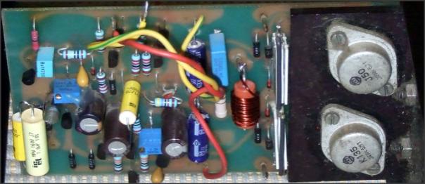

Yes, the English do that sometimes. A little less damping can sound better on some speakers. Especially when the sound is too dry.
Meaning that amp? I got one still going strong. Using it for when everything else is under planning or cruel operations.😀 Built on 80's L bracket modded PCBs that skip the 0.22R and speaker line fuse originals. I should add it and see what happens at a point I guess. Will reserve it for when the devil will find work for idle hands to do, and that is very British being a Morrissey lyric too.🙂
