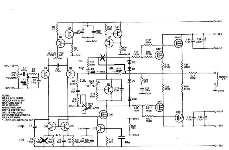

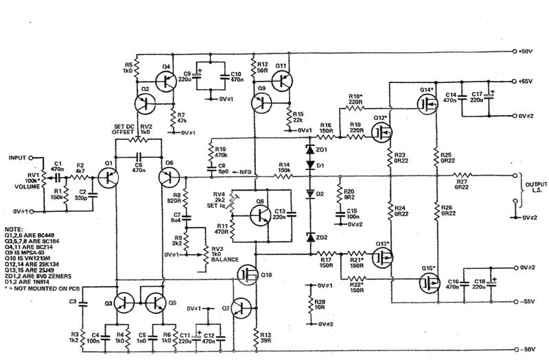

Meaning that amp? I got one still going strong. Using it for when everything else is under planning or cruel operations.😀 Built on 80's L bracket modded PCBs that skip the 0.22R and speaker line fuse originals. I should add it and see what happens at a point I guess. Will reserve it for when the devil will find work for idle hands to do, and that is very British being a Morrissey lyric too.🙂
Not that one but this one, and my moded one.
dado

Which one he published last, mine or yours with the Mosfet Vas?
Salas, the later JLH with mosfet vas has transformed into a Fetzilla :shhh:
The idea of matching P and N channels (by differing the gate stopper resistance) are also still adopted in Fetzilla, not in your older version of JLH (I think mosfet was still new for him then). Even in Dadod version of JLH, JLH used a series of 2 resistors for gate stopper. In later model JLH used only one resistor, and that is lower value than yours (330R for N, 270R for P. Yours are 680R for both). Go figure 😀
The idea of matching P and N channels (by differing the gate stopper resistance) ...
.. look like squaring the circle, because gate capacitance are varicaps, depending on the gate voltage in a different way between the N-channel and P channel.
Paralleling a cap to reduce the C delta, playing with gate stopper to equalize the low pass filter (created with the capacitance holes) between the P & N devices ?
Never found a good enough response.
So, i believe the only thing we can really do is to allow the driver to never run out of current in the worse situation with the gate resistance little enough for keeping the desired bandwidth in the worse situation too and forget about matching... Am-i wrong ?
