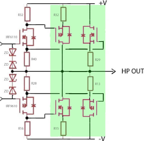

L.C., i would like to have you sentiment about this idea (May-be it was yet in your head ?) to have two different output stages technology (BJT, FETs) with the same previous stages ?
To make the things more clear, i believe between all SSA combinations, this had not be tested yet:
I presume it would need some little changes of the temp compensation in the previous stage.
I thought about it too but never tried all mosfet triple like BIGBT. This configuration would be nice to settle with exactly 50% of current splitting between the output mosfets. First Rgs could be trimmers and after finding the value to exactly split the current, can be replace by fixed resistors. The only problem would be loosing quite a portion of output amplitude in regarding to double Vgs value from the rails. Clipping can be around 5 V below the rail potential, lower efficiency in compare to regular emitter follower.

Mosfet driver would practically operate at constant Id, its Rds will change just to sustain constant voltage drop on Rgs resistors.
Agree. Not to forget we can play too with gate stoppers and, as you mention, Gate/Source resistances values of the driver.

With the driving topology, I think the BIGBT with HEXFET+BJT is a logical contender for competition with all-BJT output. But for HEXFET+LATFET, I prefer BJT driving LATFET because in the original circuit, the HEXFET is not really enjoying much current.
For very high power low distortion SSA LATFET, my plan has been to drive the LATFET with emitter driver (2N5401 or MPSA92), with cascoded VAS or non-cascoded VAS. That is what I think is more feasible to create the best sound at high power.

No problems in reality, 100 kHz square waves sharp with no ringing on 4 ohm resistor. 😉
Did-you tested-it in real (I'm exited 🙂? How do you feel -it?
HEXFET-> LATFETs ?
Is-it faster than without driver ?
I thing it was definitively a bad idea.
MOSFET driving complementary BJT can have a x10 FT than the BJT, so it do not add a pole.
We are not in this situation with MOSFET driving MOSFETs.
This added pole divide by 2 the Open loop bandwidth where we wanted the reduced Drain/gate capacitance to increase-it :-(
The added non linear GMs add distortion.
We do not need any current gain at low frequencies, where power MOSFETs are near infinite.
The low transconductance introduce a peak to peak of -10v on each rail with my parts, as L.C said..
I feel stupid, as a simple reasoning was able to bring-me to those conclusions. I was upset by the aesthetic symmetry of the schematic and by the disparity of the N and P gates capacitances of the power units.
Nice looking schematic, poor results.
