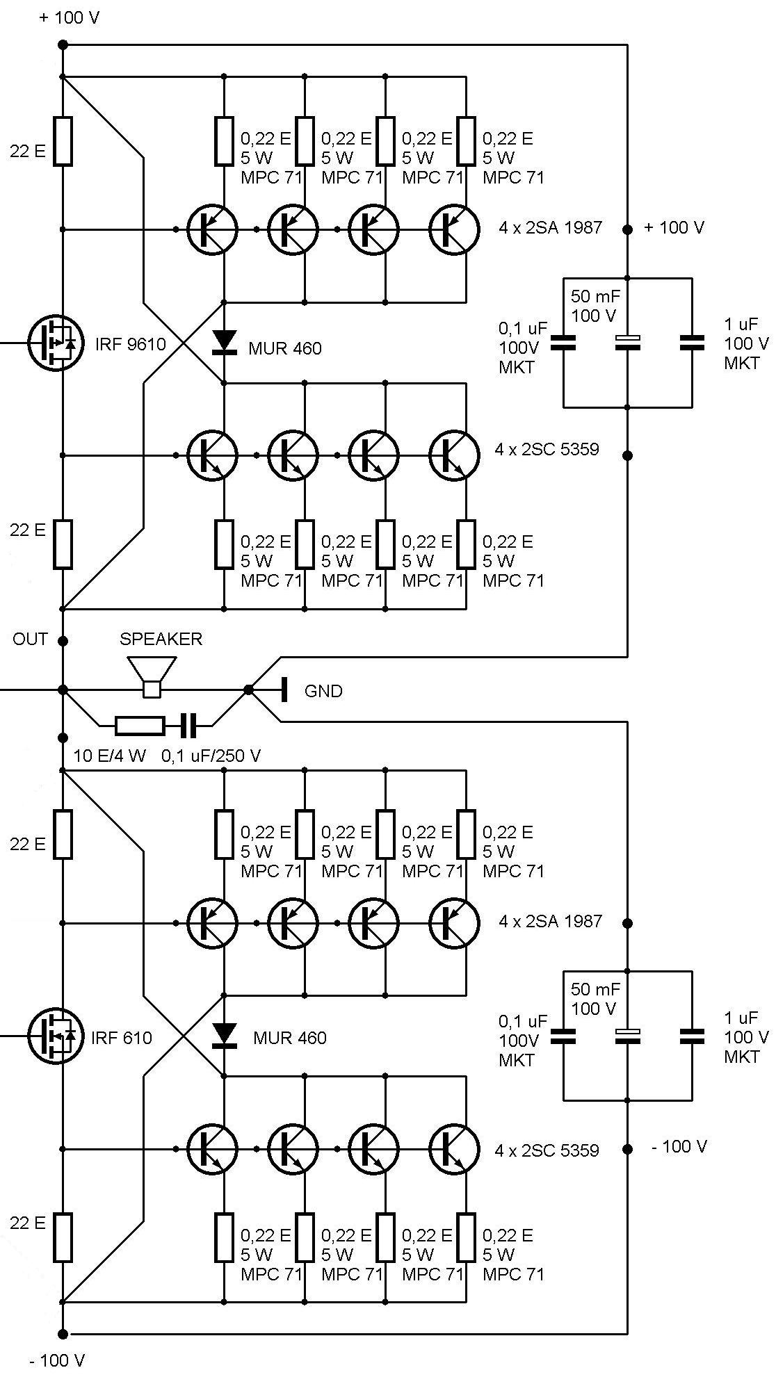

Hi LC,
Awesome output circuit you have posted - amazing!
I am not sure how to accurately connect it to the TSSA circuit you posted on page 16. Any hints for us novices?😕
Thanks.
See the analogy now? Just parallel bipolar devices as many as you need same way as on the picture. Now all bipolars around one mosfet driver have to have the same current gain hFE (+/-5%) 😉
P.S. IRF610/9610 mosfet drivers from your TSSA sch stays on positions as they are, so please ignore reversed mosfet positions on this pic because in Maximus it was completely different configuration of an output stage.

Hi Marc, no problem if it is triple BJT output stage, VAS isolation from the output current would be great, so no other change required. 😉
But as you remember we didn't pass the first task of setting CCS to correct current levels, or you already did it in the mean time? 🙄
Regards Andrej
Regards Andrej

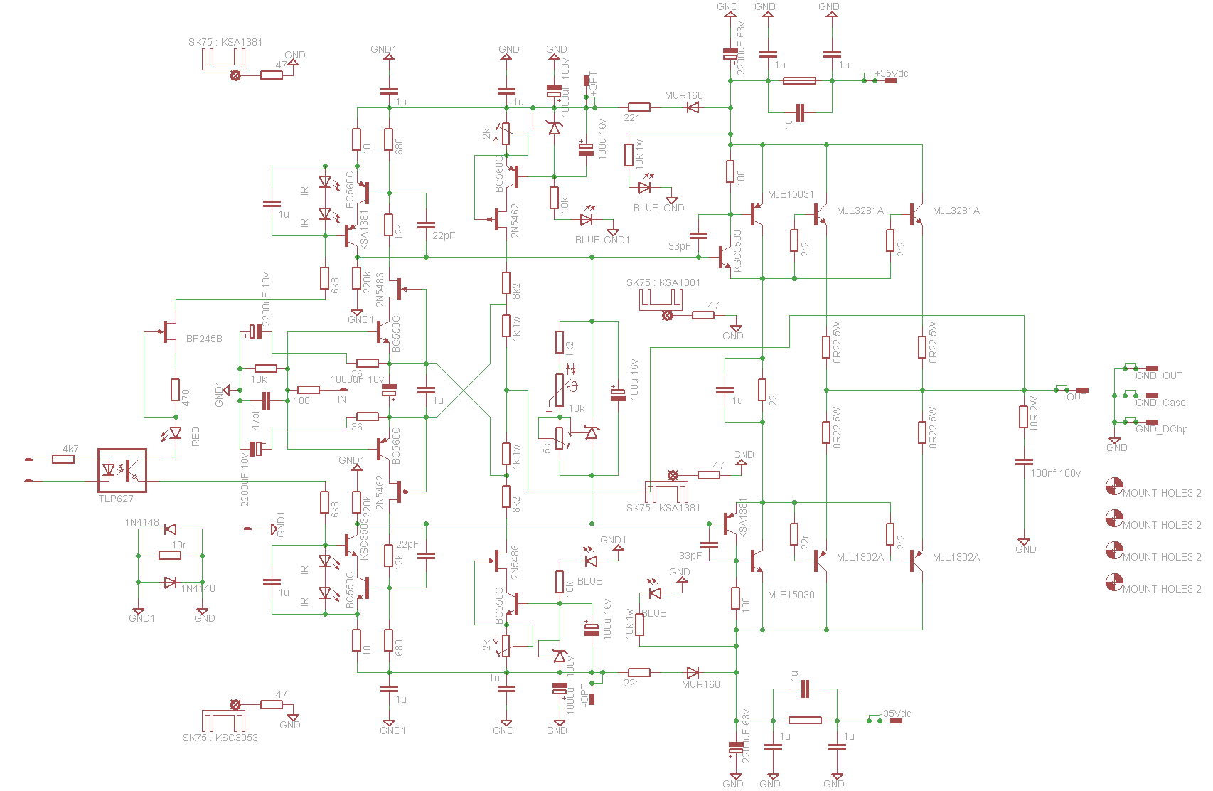

HI LC that's just "paper job" or "computer job"....i explain why i have not proceed to TSSA_BIGBT first test. I do not trust enough my actual smoothing/filtering caps and wait on some new. The soft start/speaker protection board is ok and functionnel so LTP327 can be feed.
Can you developpe :
I choose your TSSA shématic beacause you provide the table with Vrail conversion value. I just have interrogation about value toward Vrail amout on the resistor feeding Driver (MJE15030/15031)base : 100R in my schematic.
Marc
VAS isolation from the output current means, that ratio (current gain) between output current level (speaker load current) and VAS loading current or base current (Ib) to input BJT of the triple output stage is enormous. Let say for 10 A load current, VAS loading current would be only few mA, ratio more than 1000, current isolation more than 60 dB. Clear now?
100 ohm sets too low bias current for driver (second BJT in triple) it should be 22 ohm for app. 30 mA driver's bias.
LC thanks - I get it.
The extra components on the first drawing confused me.
Now to order parts from Mouser.
