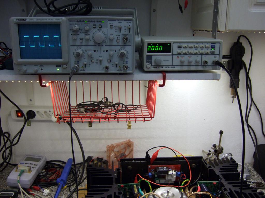

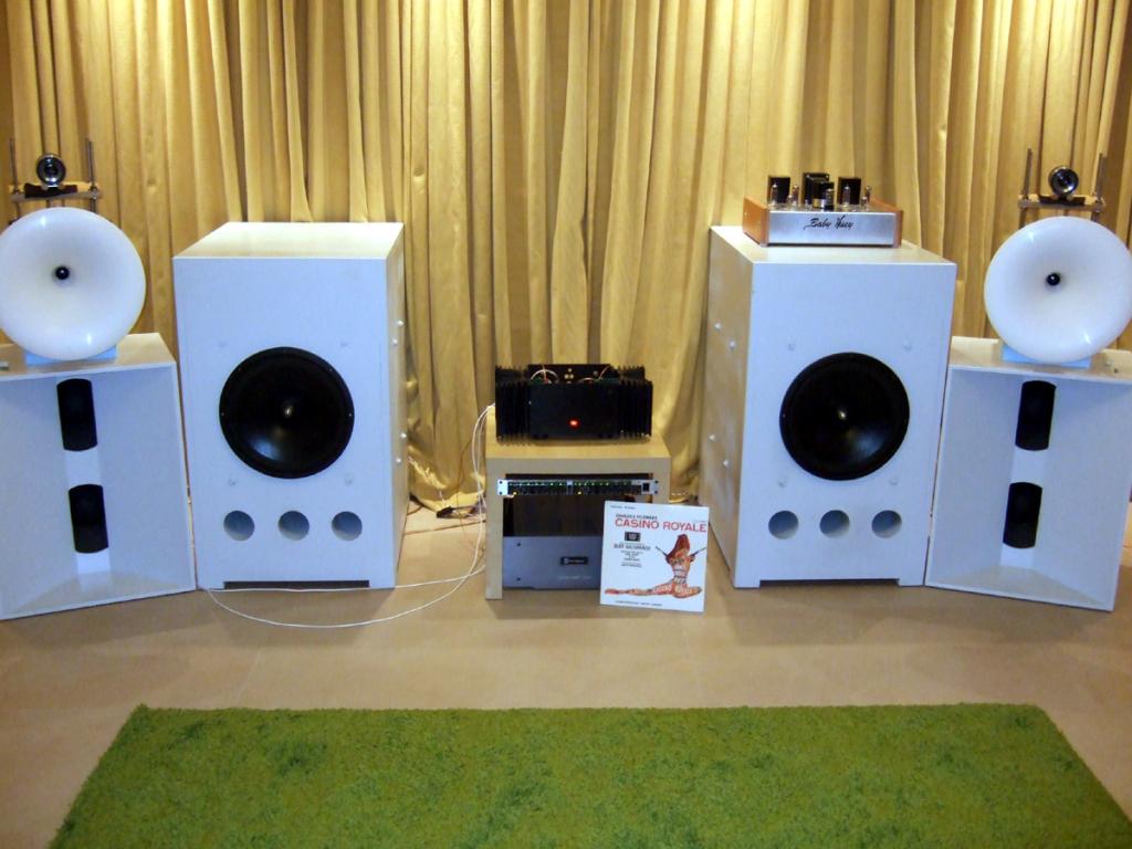

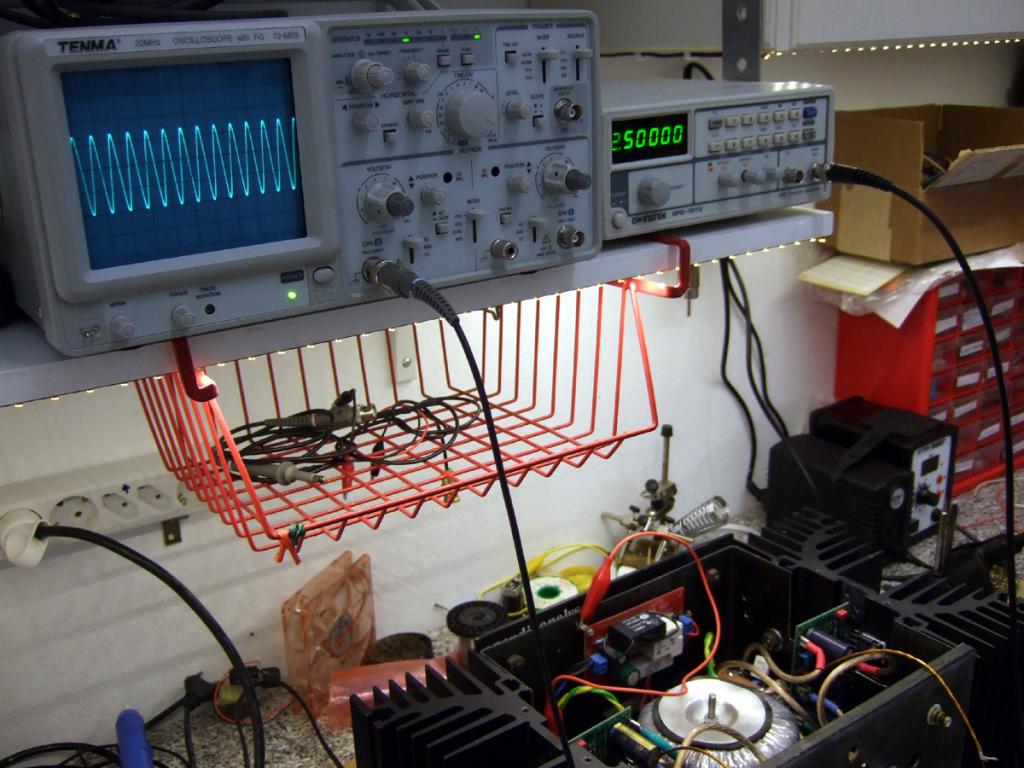

It's nice to see the insight of such beautiful DIY audio session as you thoughtfully prepared it. All predominating factors were measured and evaluated to be sure that everything is electrically OK before starting the test. As expected TSSA (Sonny's version) proved to be competitive enough to play its important role in the presented system. For this thread I choosen four pics as I think they can be very appealing for someone potentially deciding which amp to build.

Salas, apart your strange taste for vinyls (nobody's perfect :) your system is a compilation of all what a full life dedicated to audio had bought to me as the best ways to reach the best audio reproduction. Current feedback amps powering circular spherical waves horns, big diameters cones working in their non fractioning range in acoustically treated room.
The photos around-it reveals as well a big part of what life had learned to me as the best to bring joy and happiness: Sea, sun, beautiful landscapes, friends, and music...
You are a lucky guy.

Snubbing can mild out the effect but not eliminate it. If a botch afterthought, especially in a finished amp with short vias that measured 2.5MHZ -3dB, it shall expand the local loop area which is not a good risk. The 200kHz sqW pics are taken with just FC lytics on board everywhere BTW. The lead out negative widening tendency is of scope's performance, had checked that. Just a rebadged Instek 20MHZ value scope for TENMA, but phosphor gives better real time fidelity and noise VS budget DSOs before entering the better pro DSOs price range with higher screen def and update rate market segment.
