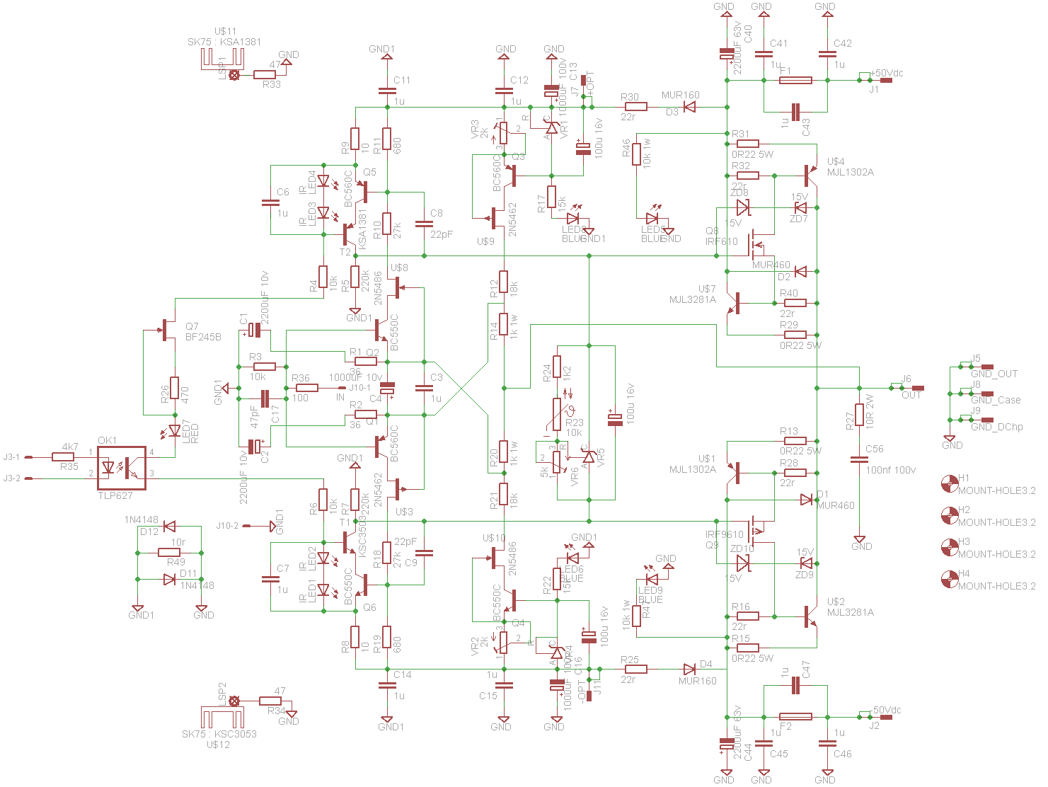

For serving the TLP627. : Confused:

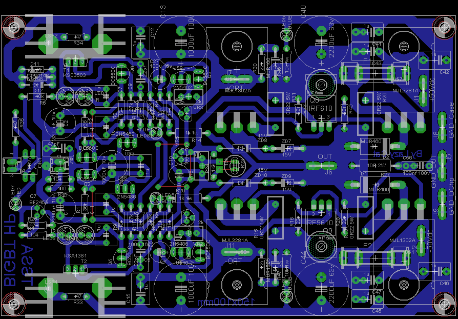

please do not find the link for the latest design PCB.Que Idefixes performed with the help of Lazy Cat.😕

See attached.

Thanks, many thanks. Do not have it in PDF format. to do with the method of the plate.

TLP627 is opto device remoted by DC detection on OUTput. The whole effect is to shutdown output stage when DC is present.
The design is not fully tested for moment (missing time). Before etching plate are you shure to be able to purchase all matched need transistor in BIGBT module (NPN/PNP and mosfet) but all little and middle transistors too in first stage?

Other than the TLP627, I have everything in my large parts collection; JFETs are similar, eg., 2N5461 instead of 5462. So will a PDF of the track pattern be made available please? Thanks.
May be in private but at your own risk as i don't want to publish something public that not be tested

Hi Samuel
2N5461 is conditionally acceptable because it could have too low Vgs at demanded CCS current, so cascoded BJT's Vce=Vgs would not have enough headroom to operate properly. I suggest you to use 2N5462 or two 2N5461 in parallel. 😉
Hi Samuel
Thanks for that info. Might as well order for 2N5462 from Element14 (formerly Farnell) as well as all the JFETs required for Sonya's version of the TSSA.
