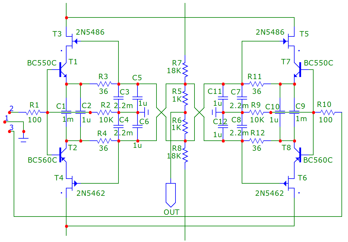

I attach the guessed bal. IP for the TSSA. Your sharp eye suggestion & comment would be much appreciated.

It would be nice if you can detail your matching process for BIGBT driver (maybe with matching circuit diagram).
(about pnp/npn input Bjt and Vas)
Sheet that was not in my mind, i just go to order more than the 10u of each note on my order...(on semi for input and fairchild for VAS), add 10?...20?...30?. I have in mind that it is quite difficult or need a udge batch of each to match NPN/PNP HFE.
I put 100unit of each on my bom list

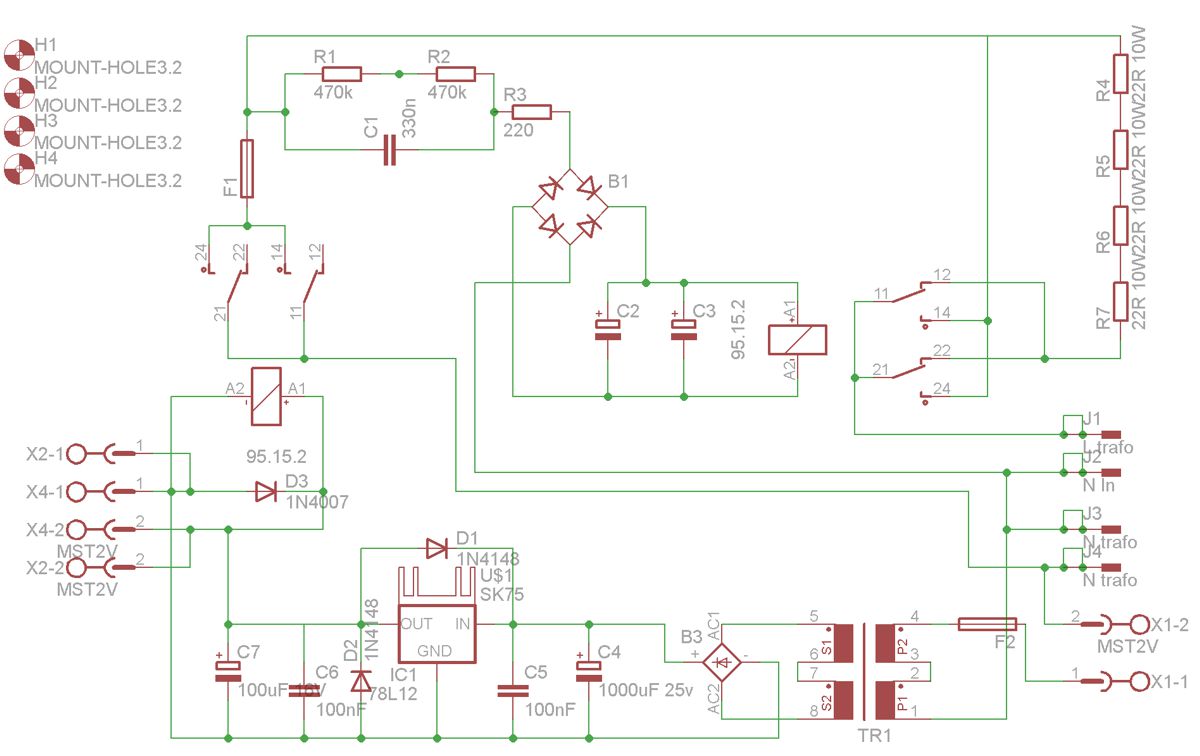

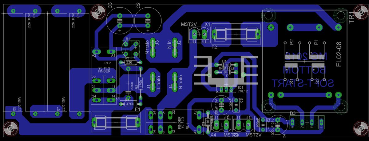

Soft start with 0-12Vdc on board power supply. Switching this can be achieve by on-off push button. It supplies the speaker protection and power led to. On board trafo avec 10Va 2x12Vac comme from industrial rubbish.
Board size : 190*70mm (a standart epoxy 200x150mm can produce two => one per block..

Quite nice to you to help me....First at all : are the amout of npn/pnp, i put on my bom, realistic to achieve good matching?
Marc
Order BC550C 20 pcs, BC560C 20 pcs the same with KSA/KSC and you will find 2 matched pairs of BC550C/560C and 2 pairs of KSA1381/KSC3503, that is what you need for two monoblocks.
Measure them with hFE selecton of a regular multimeter. They measure with Ic=1 mA and that is OK, since there's no heating. Anyway you can notice hFE going higher just because touching them for a while. The point is to have all BJTs on the same surface few minutes before measurement and measure each the same amount of time, if possible not touching them. 😉
All the same with output MJLs ...
