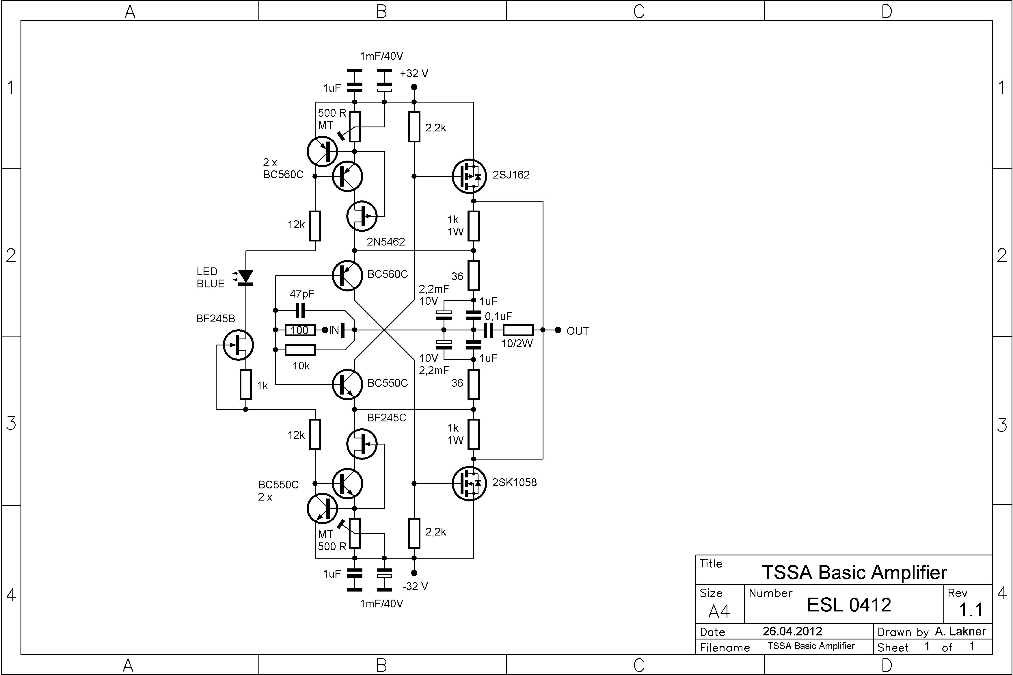

Gerhard and all interested, I finally found spare moment to make an upgrade to basic version, now with CCS integrated.
I'm sure this would measure even better than the first basic version built by Sonnya, sound quality should follow as well.
Regards, Andrej 🙂

Few more words about TSSA Basic 1.1
- CCS pair transistor's flats should be glued together
- input pair transistor's flats should be glued together
- BF245B source-gate resistor value for Id=2 mA
- 500 ohm MT (multi turn) trimmers set output bias current (0,25-2A) and output DC offset (zero volts)
Amplifier power output 50 Wrms/4 ohm. 😉

I thought that would be into 8ohm, with +/-32V 😕

The OLG will not change much. The open loopgain is more or less set by the RC divided by the feedback resistors which are => 2K2/(36R||1K) => 2K2 / 34 => 65gg
It is multiplied by: (RLOAD/(1/gfs)).
For the exicon (10N20 and 10P20) it is: gfs = 2.5S @ ID=2.5A.
65gg x (8/(1/2.5)) => 1300gg or 62dB.

56 Vpp is max output voltage swing just before clipping, so if power supply can deliver current, max output power will be 49 Wrms/8 ohm or 98 Wrms/4 ohm.
I stated output power at -3 dB, so more relaxed, unclipped, not heavily distorted one. 😉

OLG 62 dB is OK. Distortion spectral profile will be much more clear than before. What do you think, will you test it? 😎

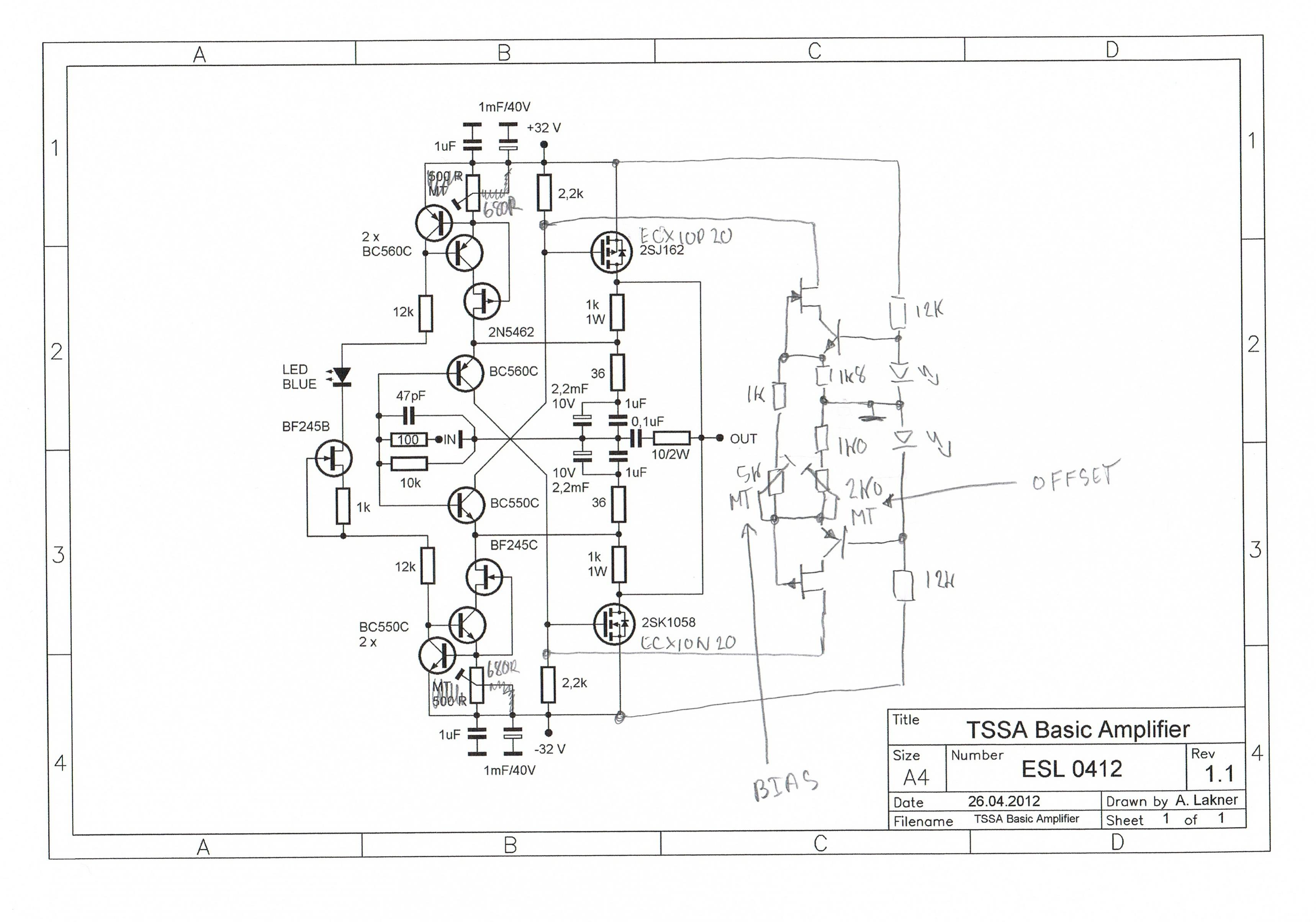

I am not a fan of pure CLASS A (It is not ECO friendly 😀 ) but i will maybe test the attached version.
This way the current through the input BJT will be the same and symmetrical regardless of bias current and offset adjustment. => Every amp will sound the same way.
