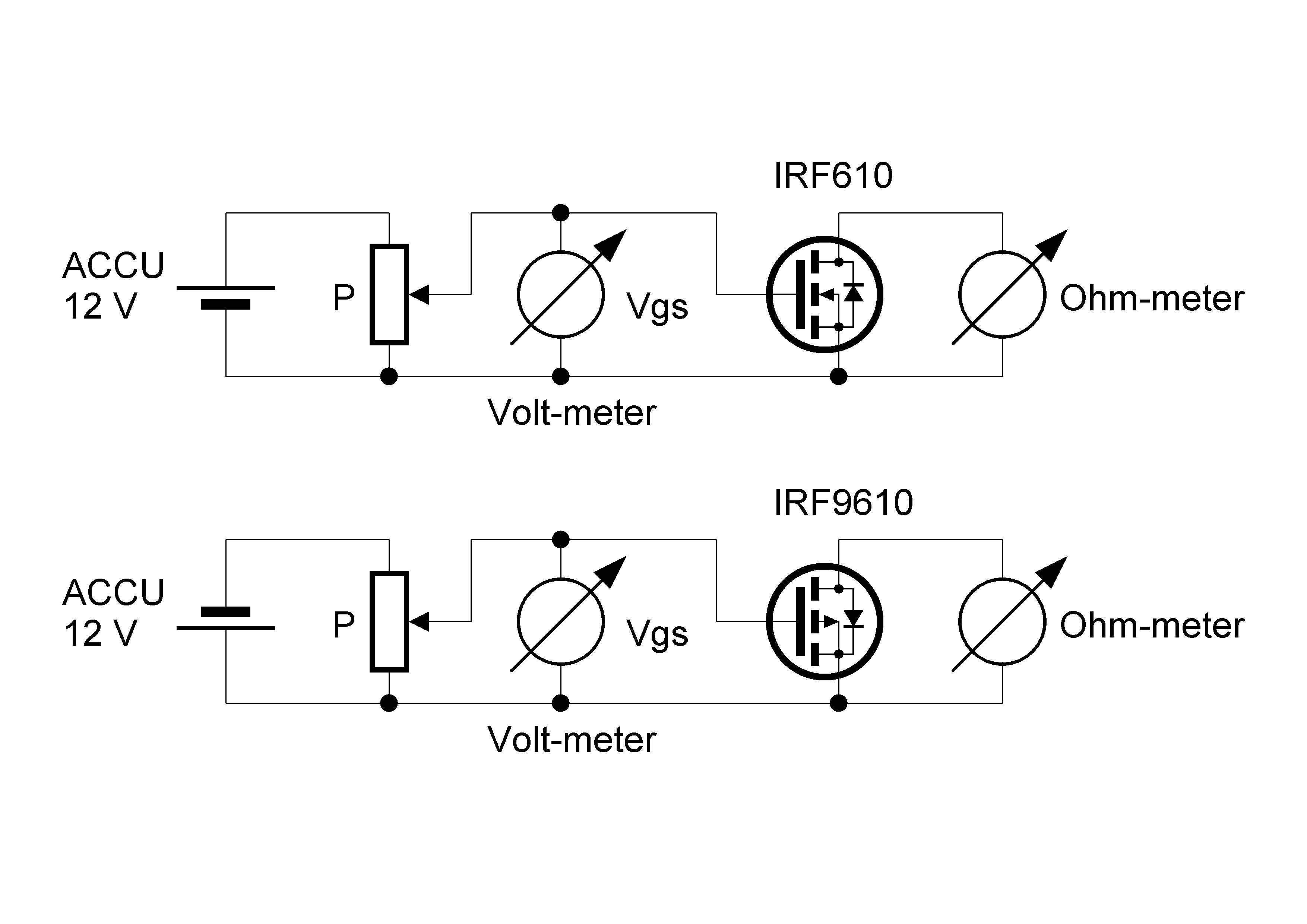

IRF matching, very simple, but it will take you some time hehe
Do not try to find or make a selection of IRF610 and IRF9610 according to Vgs voltage. That is not important. Usually they differentiate for 0,5 V but that is OK as offset setting eliminates this.
Transconductance curves of each type have to be parallel as much as possible. That you will get from three sets of measurements for each type of mosfet. Mark each mosfet with number. Start with 1 by IRF610 and the same with IRF9610.
IRF610 step 1
- take first IRF610 and set potentiometer that you read 100 ohm, read out Vgs and record the value as Vgs-initial-610
- leave potentiometer as it is and measure all other IRF610
- for each numbered IRF610 put a measured resistance value at initial Vgs in a table chart
IRF610 step 2
- take first IRF610 and set potentiometer that you read 50 ohm, read out Vgs and record the value as Vgs-medium-610
- for each numbered IRF610 put a measured resistance value at medium Vgs in a table chart
IRF610 step 3
- take first IRF610 and set potentiometer that you read 10 ohm, read out Vgs and record the value as Vgs-maximum-610
- for each numbered IRF610 put a measured resistance value at maximum Vgs in a table chart
IRF9610 step 1
- take first IRF9610 and set potentiometer that you read 100 ohm, read out Vgs and record the value as Vgs-initial-9610
- leave potentiometer as it is and measure all other IRF6910
- for each numbered IRF9610 put a measured resistance value at initial Vgs in a table chart
IRF9610 step 2 (attention)
- take first IRF9610 and set potentiometer to Vgs-medium-9610= Vgs-initial-9610 + (Vgs-medium-610 - Vgs-initial-610), read out and record resitance value in a table chart
- for each numbered IRF9610 put a measured resistance value at medium Vgs in a table chart
IRF9610 step 3 (attention)
- take first IRF9610 and set potentiometer to Vgs-maximum-9610= Vgs-medium-9610 + (Vgs-maximum-610 - Vgs-medium-610), read out and record resitance value in a table chart
- for each numbered IRF9610 put a measured resistance value at maximum Vgs in a table chart
From IRF610 and IRF9610 table charts you can select the first pair from the ones that have most similar resistance values at all three Vgs voltages. In this way transconductance curves of the first pair are closely parallel-matched. Second pair is the second most matching combination from all three Vgs measurements, etc.

To resume IRF matching described in post #261 in short. 🙄
IRF matching is reduced to a form similar like finding the most equal "potentiometers", where mechanical scale is set to a certain position by accu & P, at which Ohm-meter readout is recorded for comparison. 😉
Yes LC that was i have understanding from your process description. It's quite clear.

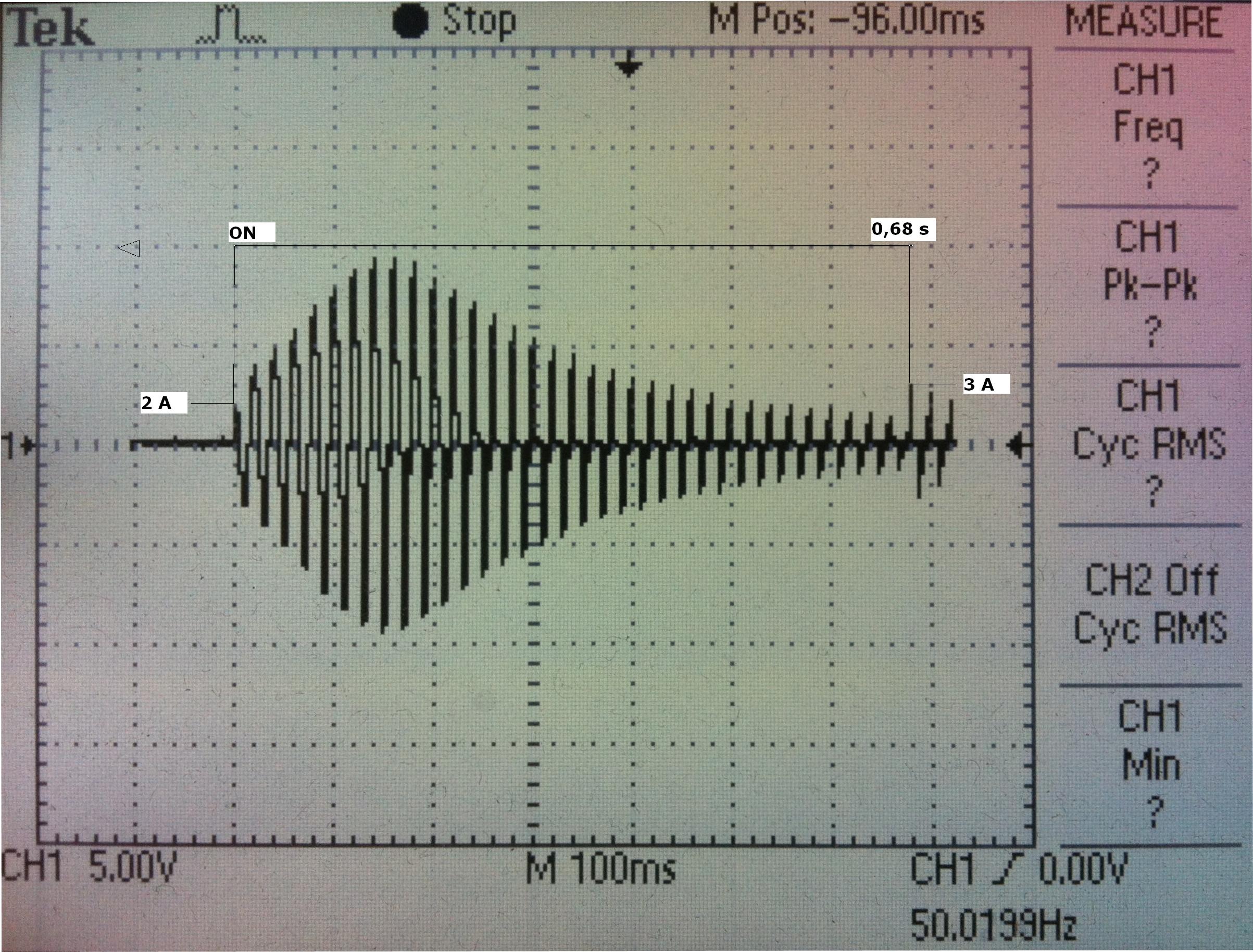

That's a good idee as it save a huge place. This could be used to build the speaker protection in the same board as softstart=> results in wiring simplification.
Marc
Huge PCB space reduction yes. Only one CL-90 soft starts my stereo SSA BIGBT HP. Attached is the graph chart of inrush AC mains current. Explanation here. 😉
Thanks for link.....I have quite similaire condition, lower rail (+/-36Vac) but higher Va rating (500Va) and 88.000µF per chanel...I will adopte for sure CL90.

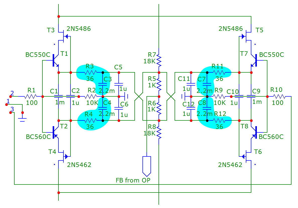

I attach the guessed bal. IP for the TSSA. Your sharp eye suggestion & comment would be much appreciated.

Hi Smiley!
As far as I can see, you will have no signal at the output. It is shunted to ground by C3 to C6 and C8 to C12.
Thorsten

My sch was intend question to LC as he knows the main TSSA sch in detail. . .
Here the pics for You to easy see my question to Andrej,
Cheers

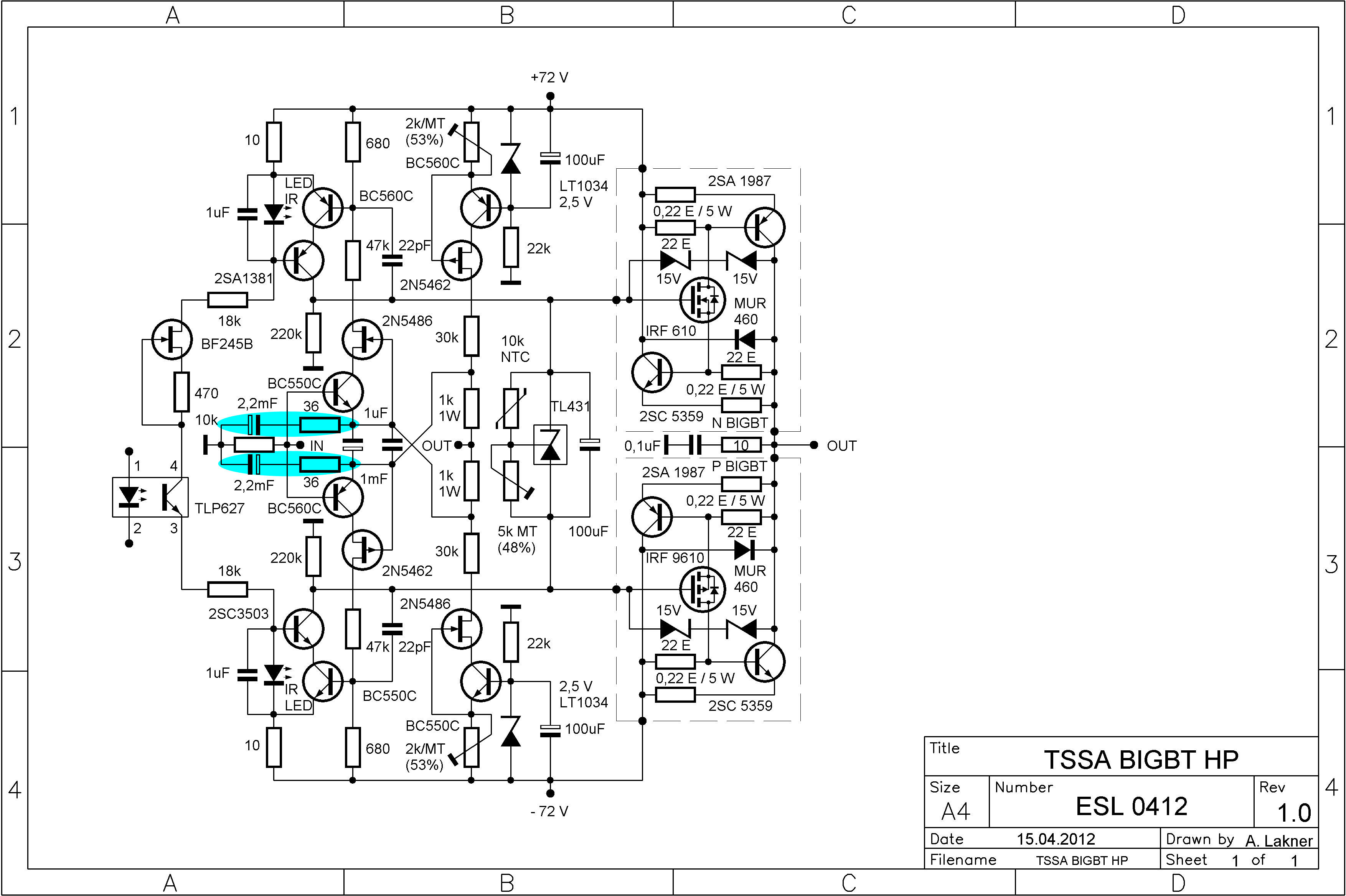

I'm just helping to select mosfet driver for BIGBT
Oh, how could I forget that the BIGBT used IRF610 😀
Hey Jay which specific hexfet are you interested in?
I used IRF9630/IRF632. I have other ("better") hexfets but I could get only the subcircuit for LTSpice simulation (SUBCKT). All hexfet subcircuits that I found on the net have strange behavior as if the Drain and the Gate is mixed up.
Guys thanks for good wishes, appreciate greatly.
Yes IRF-s, I know, cannot get rid of them, more or less obsolete according todays standards, but what can I do. 🙄
