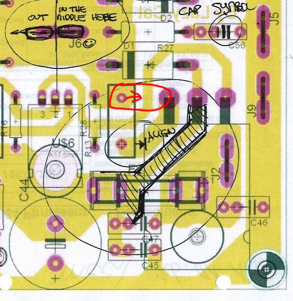

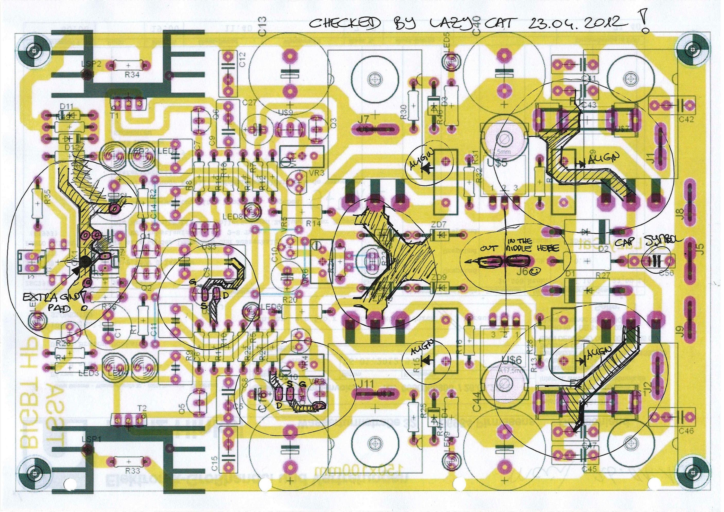

OK, here's my final check of PCB parts & wiring, also some component's position adjustments to enable wider tracks were done. Hopefully it would be managable, Marc what do you think? 🙂
Hi LC i will work on modification this evening. I was sure there was an issue with 2N. It's typicaly the part with pin layout depending manufacturer. The unit i ordered are normaly Fairchild and have different pin layout as onsemi. Is 2N5462 layout OK?
May there is an issue with 0r22 R13 new position see attachement.
Marc
Yes, 2N5462 is OK. That in red circle is base track connection, it can be thiner no problem only mA flows. 0,22 ohm were actually moved to sides because of collector connections, tracks flows 10 Ap range current and now can be wider. 😉

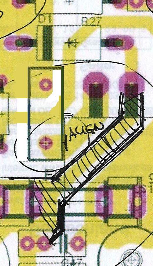

Even i swap to side resistor and reduce base tracks i risk to have issue see attachement. The collector trace is 0.07inch (1.778mm thick). No solution for moment i must think hard on.
Edit : the thing a i can do is to give more room in enhancing the board in lengh 150~>155mm form exemple. Standart board are 100x160mm so it fit already.

No, no need for PCB enlargement really. Look to attached pic, 0,22 ohm moved to a new position and base track is still the same.
Collector tracks doesn't need to be as wide as I drawn, it was hand drawing so very approximate.
First just move all four 0,22 ohm/5 W resistors to a new positions, and than make (two marked) collector tracks as wide as PCB allows you. Do not measure the width of my hand drawings it is only informational to show that they need to be wider. In any case at the end the tracks will be much wider than before modification. PCB can stay 150 x 100 mm. 😉

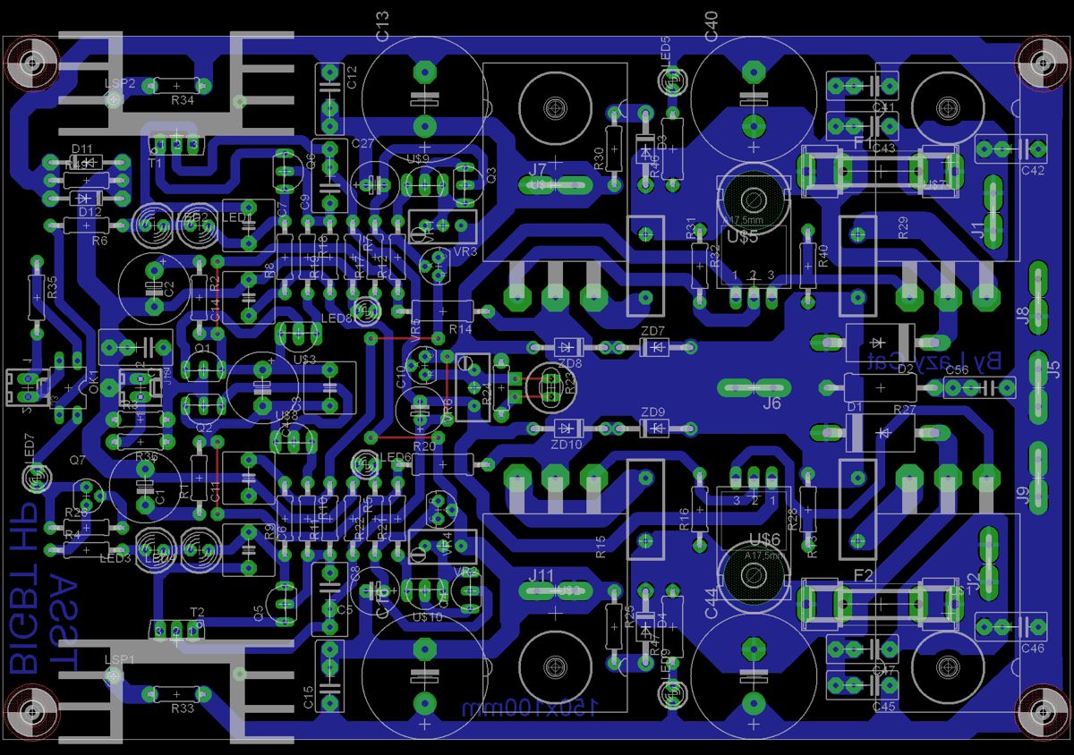

You see it was possible to make it out, at lower right corner output BJT there's still reserve to widen collector track for the final PCB layout.
PCB now looks very "professional" DIY if that is the right expression, it is so complex that topology schematic is not obvious at the first sight. Very impressive I love it, and logical question would be, when are you gonna make it working? 😀

Yes it was possible, your experience hat the final word... I know there still little space at this BJT but for keeping symetrie as i can't more at upper i let so the lower.
To answer at you question "when" : i begin a bom on mouser so the major parts. nd i need to more order to complet the whole BOM. The point i must clarify before order to mouser, is the IRF640/9640 selection process. I have on hand between 10 and 15 unit of each beut need to choose the good or purchase new if there is no good.
