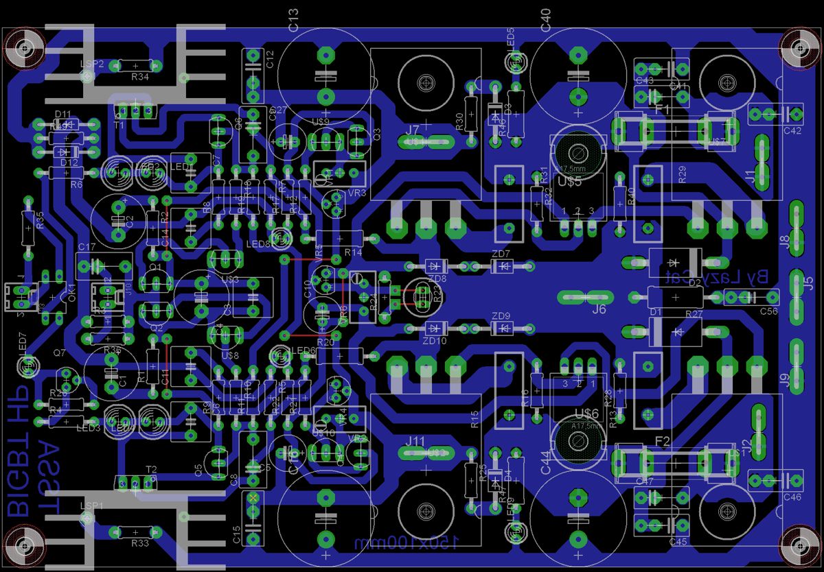

For layout I need to rework to see if i can gain space et reducing traks length, but i am in single layer....that not easy. Pearhaps i can do something with TSSA core to bring it back, more closely to BIGBT module.

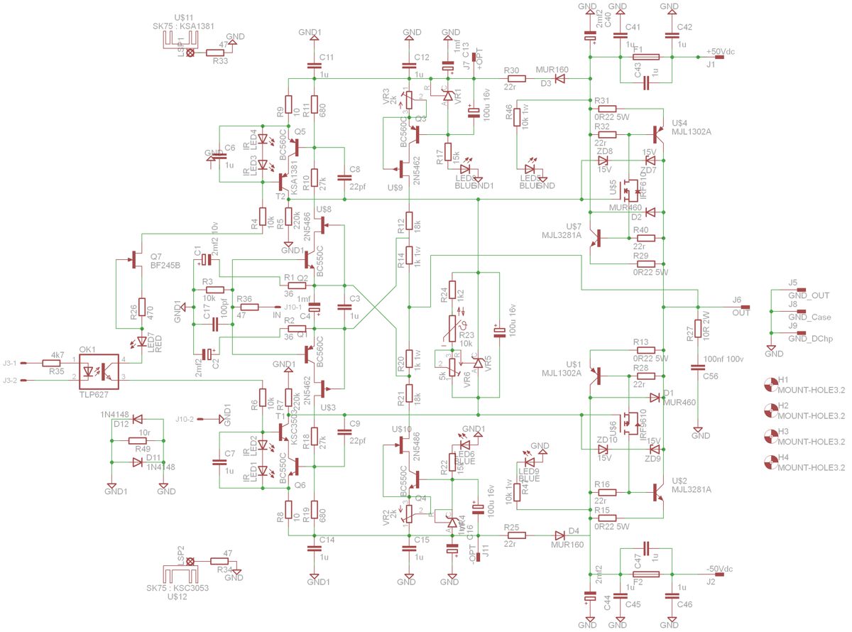

Do R3 & R36 need to be so low?
What deteriorates if 100k and 1k are adopted?
What values are C1 & C2?
2.2mF or 22mF.
I can't make out a decimal point. I prefer 2m2F instead of 2.2mF. It is unambiguous and generally recognised worldwide.
Reported to component voltage value and size this are 2m2uf or 2200uF if you prefer. Same 1mf = 1000uF

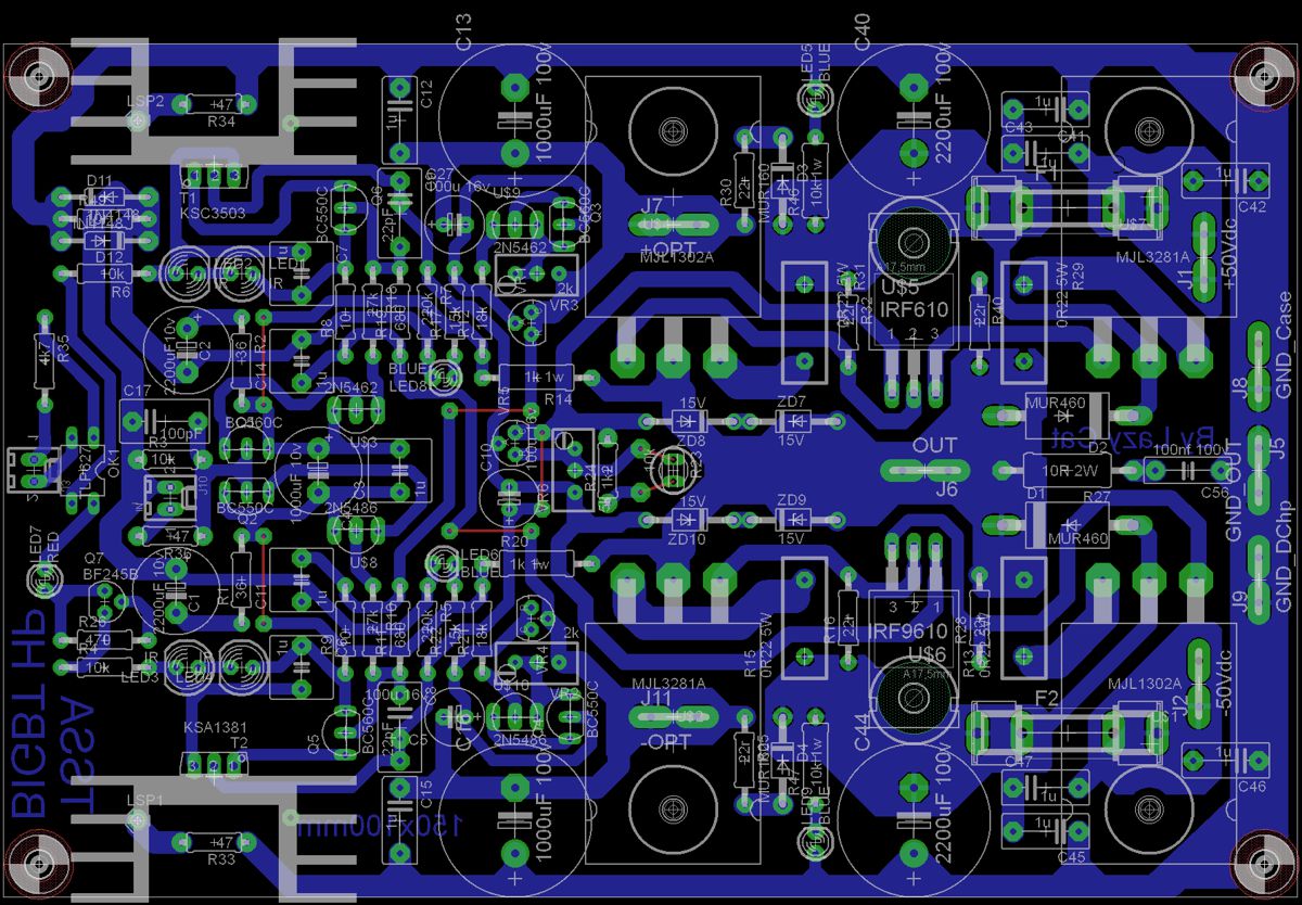

Hi AndrewT 😉
Look here's the original schematic, where you can clearly see 2,2 mF. This sort of value marking occupies less space on a schematic than 2.200 μF 😉
Here we go, R1/C1 value are these from SSA schematic form moment until value is fixed. The add of latest component don't let keep the nice input area symetry we had in previous version.
Marc
Good, good Marc, I like it a lot 😎
Last corrections from me and than I rest my case, PCB can be final:
- C17 100 pF, put three pads/holes as with C8, C9 (5 mm, 7,5 mm)
- move input connector J10 to the middle (symmetry line) and resistor R3 near R36, in that way both connectors J3 and J10 will be aligned
- move two NTC pads closer to R24, and make a screw access hole larger
- J9, J8 are not the same distance away from J5, please correct it
- if possible leave the body of IRFs on the same spot, only align their pads with MJLs, if parts library allows that modification. It would be nice to have pins aligned, also pin leads of IRFs would be shoter (this is the main reason), but please do not move the cases of IRFs
- C12, C15, C41, C42, C43, C45, C46, C47 1 uF film capacitors should have third pad for 5 mm pin distance case, which are quite common on the market
Regards Andrej 😉
P.S. Other answers will follow at the evening 🙂

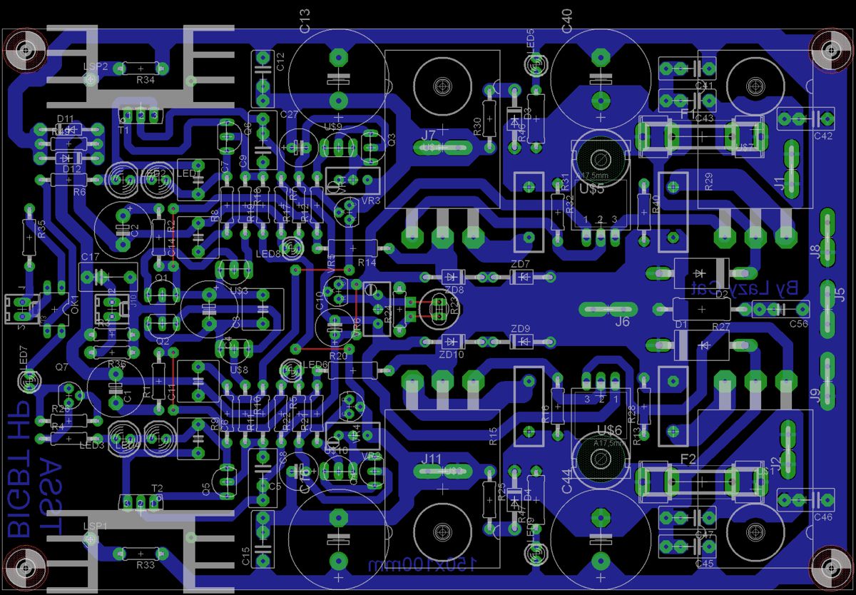

Here for update
Marc
Mark awesome 😉
Only one little beauty remark hehe, look C8 and C15, what is the difference? Something about silk screen layer and this artefact should be corrected all over the PCB. 😀
Mark awesome 😉

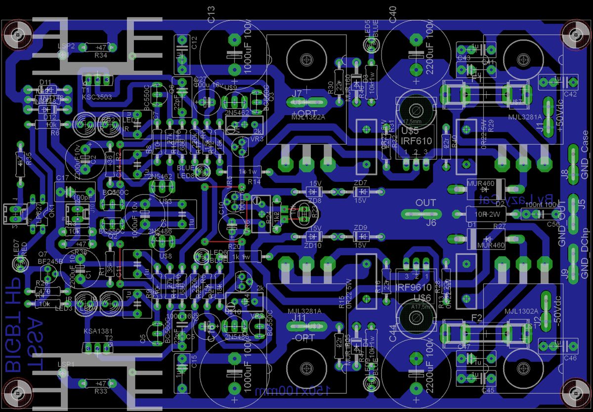

For you Sir...
Hehe you corrected C15 but at the same time something happened with C8. At other places too. 😀
this time i don't see, all symetrical above from down to top????
marc
C17, C8, C9, C44, C47, C56 capacitor symbol over the pad 😉

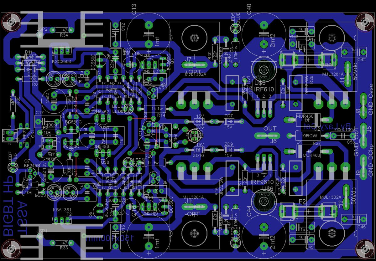

Okayyyyyyy....
Marc
Here....One thing is clear, TTSA layout was really rewarding for me. Thanks for all.
I believe that Marc. 😉
C17 😀
