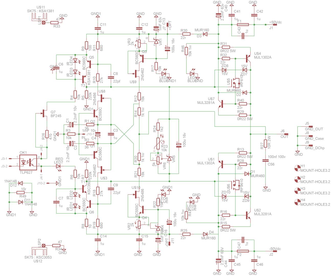

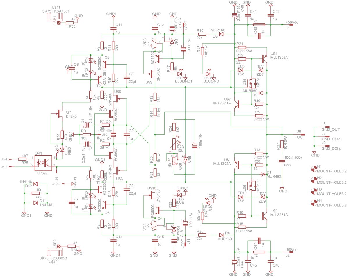

This update enables TSSA BIGBT HP to be even more universal:
- serial diode MUR160 plus 22 ohm resistor in power supply rails helps to improve PSRR
- +/-OPT pins enables to connect separate power supply for the front-end (MUR160 and 22 ohm are omitted)
- power supply LED indicators for both front-end and output stage are present
- serial compensating resistor added to NTC (serves to calibrate NTC thermal response)
- serial resistors added to SK75 heatsink's GND connection (serial RC filter)
- 1 uF/63V decoupling capacitors added close to VAS transistors supply rails
- TLP627 input now accepts 12 V remote signal (serial resistor added)
- LT1034 replaced by TL431
- R2-R9 values stated for +/-50 V power supply rails
And that's about it. 😉
In the moded schematic you swap the two 10R resistors connected to IR led to 100R right?
Marc
Marc
Temporarily, now are back to 10 ohm. 😉

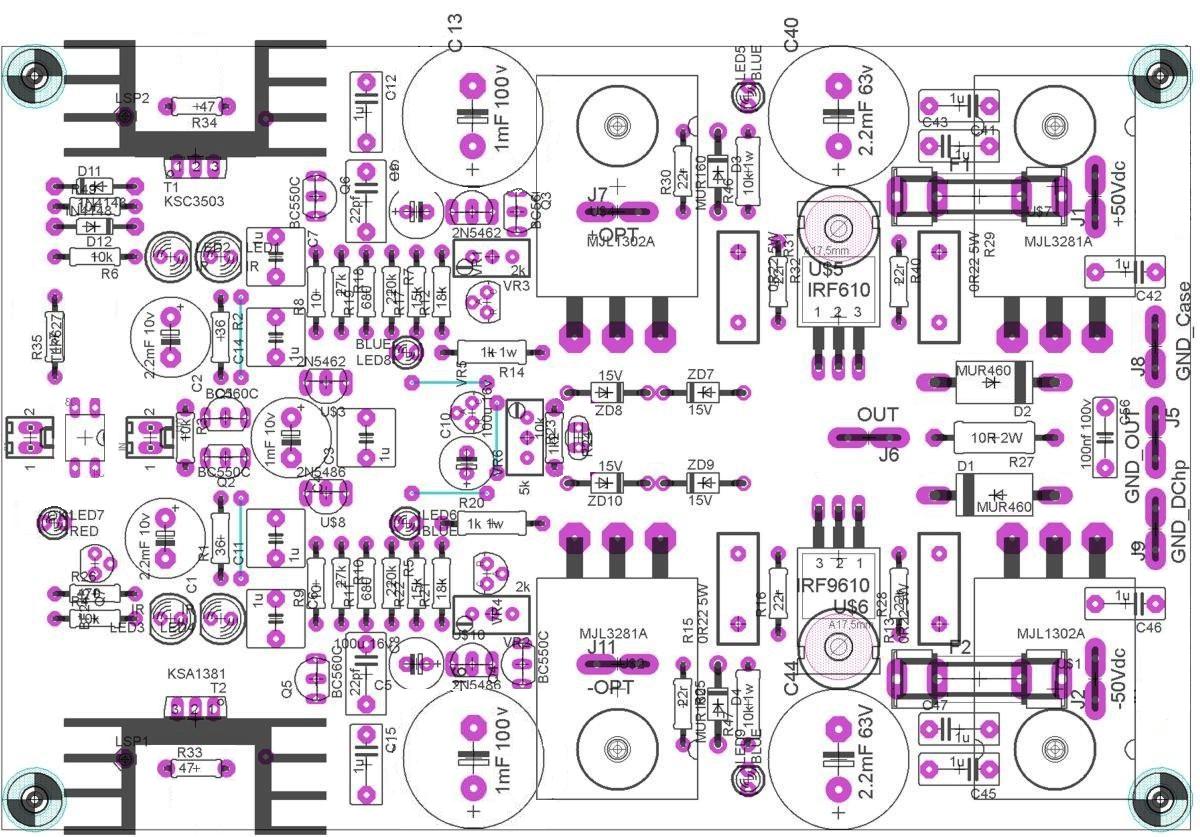

Layout related the schematic above. Output BJT are mounted under PCB but not sandwiched by screew between PCB and heatsink
Just came home from the party 😀 Marc PCB looks great, will do check-up tomorrow, regards Andrej. 😉
Hi Andrej,
Some more minor cosmetical changes to improve visual symetrie :
-position of tlp627 power supply resistor (to use with 12v)
-position of 10k at signal in.

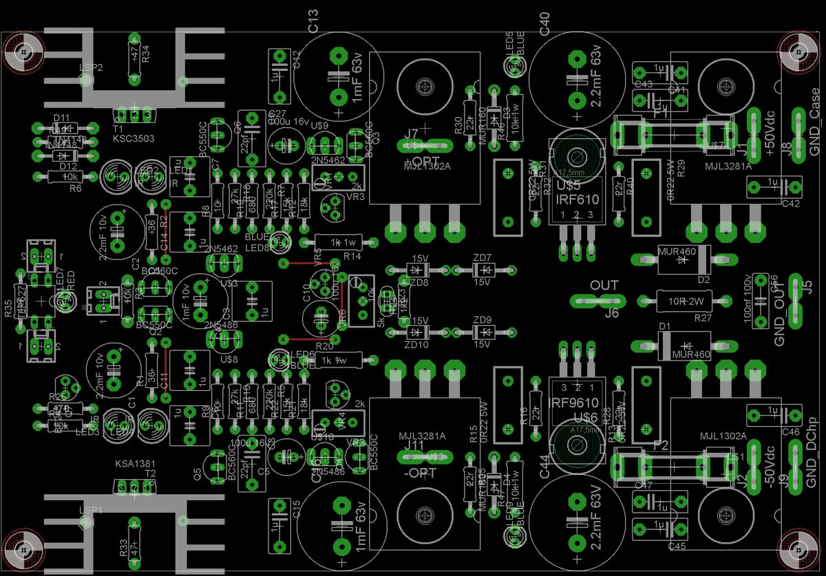

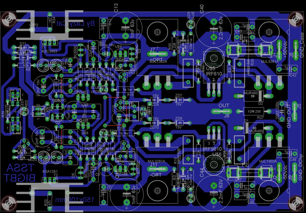

First of all I really have to express my compliments to you for all your work at TSSA BIGBT HP PCB, the board is amazing according to my standards. Look, for only one layer PCB, drawn from medium complex schematic, there's only five wire jumpers, that's is a remarkable achievement. Hats off to you Marc.
I checked schematic separately and here we go:
- Q7 BF245B, B marking is missing
- C11, C12, C13, C14, C15, C16 are now 100 V marking, if someone will connect optional front-end power supply, that is normally +/- 5-10 V higher than the output power rails. According to given voltages table, front-end rails would be in a response +/- 35-85V. So 100 V capacitor potential marking is on a safe side in all circumstances
- erase GND symbol near C6
- connector J4-1, J4-2 is unnecessary, if there is no need to have remote on/off, than TLP is simply omitted and its pins 3 and 4 are connected with wire jumper

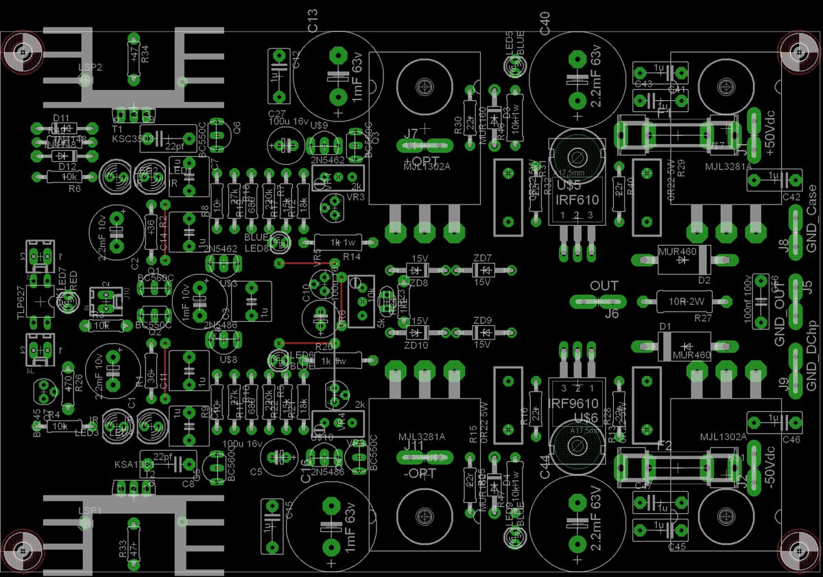

PCB check-up:
- R33, R34 rotate 90° and reposition as now, unisolated part pin too close to PCB edge (elcos can be at the edge - isolated body)
- omit connector J4
- position TLP, R35, LED7 as on pic
- C13, C16 are 100 V, now same diameter as C40, C44
- C12, C15 repositioned
- R23, R24 fliped horizontally
- MUR460 moved away from MJL-s, reposition them as now
- J9, J8 GND connectors moved to middle GND, as now better prevents GND interference currents
We are a tiny dot away from final PCB. Today I will check connections-tracks according to the sch.
Best regards, Andrej

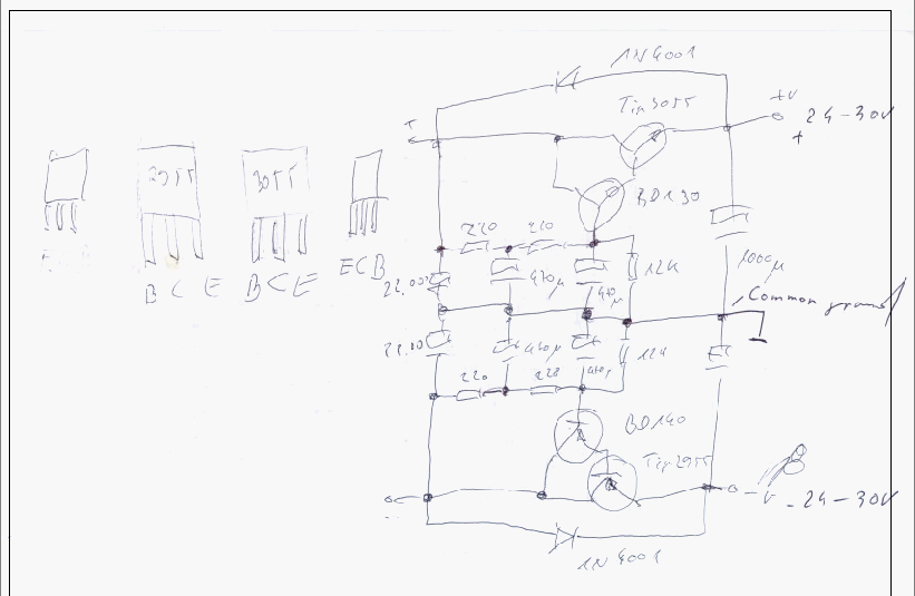

I build the super simple version of post one. It worked right away.
The sound is a bit lighter then with my power buffer ( see MPP ). By adjusting the gain in the preamp and using a warmer sounding cable i got it going. I have to listen more but the amp is very transparent.
Hi Joachim,
I'm considering this as headphone amp. Can you link the final circuit of your MPP (i found the thread but it's huge)?
I build it like post 1 on this tread. What i added is a cap multiplyer in the PSU plus an input RC filter with 220 Ohm in series and 150pF to ground.
I will publish that circuit here soon. For a headphone amp this is a bit overdimensioned so be carefull with the volume.
Yeah, I plan to run lower voltage rails like 12-15V. Have to simulate distortion first.
Tell me when you got it working. It sounds very good and worked right away. No problem with offset and bias. It runs quite high on cass a though, cool it well.
