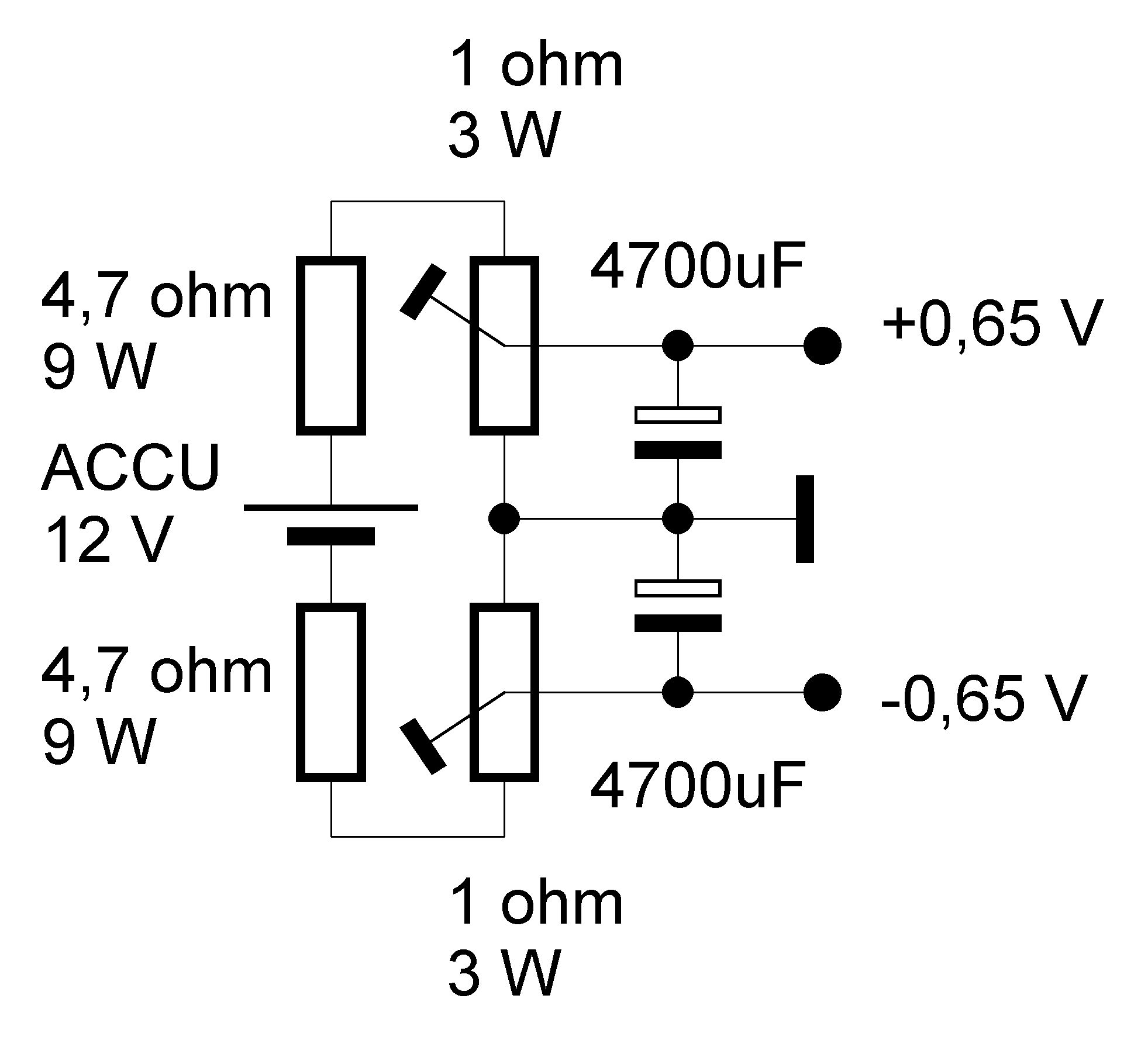

Before CCS you can try quick&dirty test from schematic attached, just to be sure this is the right direction to go.
This simple circuit will completely eliminate feedback current influence. Sound check with this test bench will also tell you more. 😉

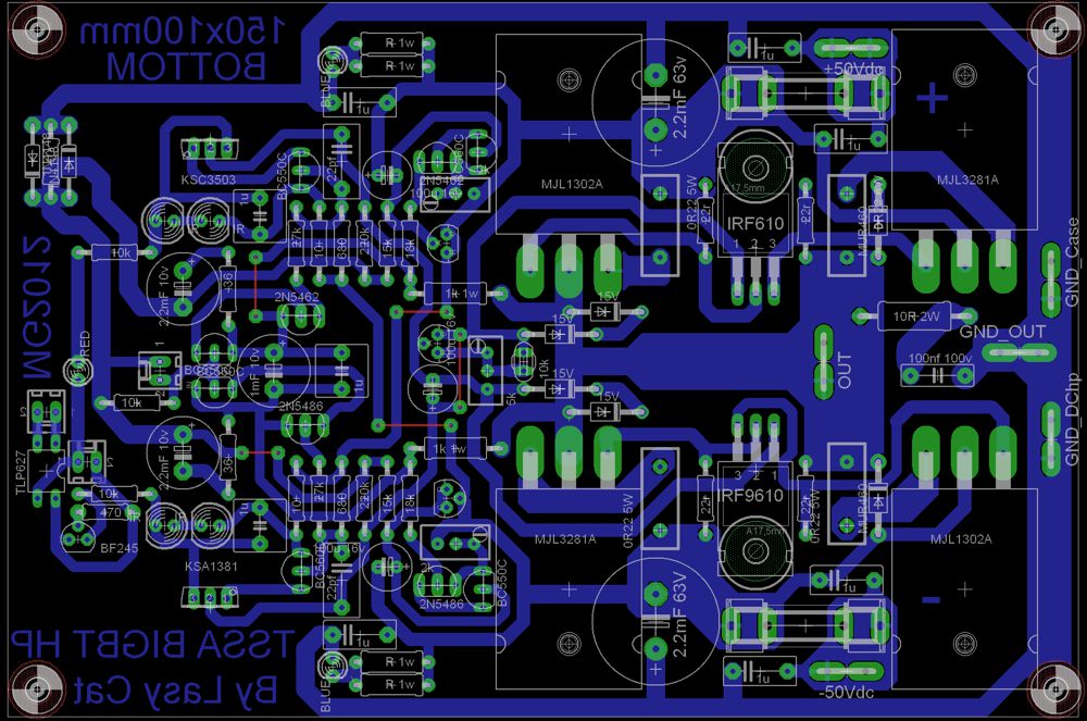

According latest LC advises on empty space and trace length...
Nice progress Idefixes. As this is single layer PCB it's understandable that you're playing inside limited options. Wire jumpers sometimes are just not enough, space optimization in this kind of PCB depends only on designer's ingenuity. You're getting close to the limits, but still some more room for improvement.

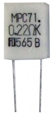

Also the output's emitter resistors should be different, MPC71, 0,22 ohm/5W, non-inductive should find place here. 10 ohm zobel resistor should be 2 W, much smaller than the present one.
TLP627 area is to crowded and too close to screw. Move BF245B + resistor to the other side and put blue LED in the middle position near the input. It's always nice to maintain symmetry from the sch to the PCB as well.
Input BJTs should be closer with pins since their flats will be glued together.
Orientation of the IR LEDs should maintain their serial position as on sch, no brainer when installing the parts and soldering.
I still see separated crowded building blocks from sch like islands, not spreading enough across the empty areas. When and if you will relax that blocks, tracks will automatically be shorter, individual parts will find more space around them. Yeah PITA job I know. 😀

Hi LC, Thanks one more time for new advices, i will rework. I would conserve PC length at 150mm as there is a 150x200 standart board. For MCP i must look on ebay as i couldn't find those brand on conventionnels store even internet stores. It's quite normal you can identify "crowded building blocks from sch like islands" as i split it into blocs. I will see if i been able to relax that blocs.
Could you give me the Voltage reating for 100µ, 1mF and 2.2mf to see if i could gain more space to adjust to real needing size?

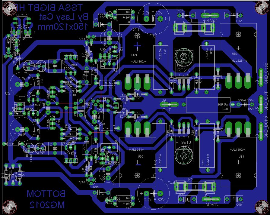

Hi LC, here's my interpretation from advices you give.

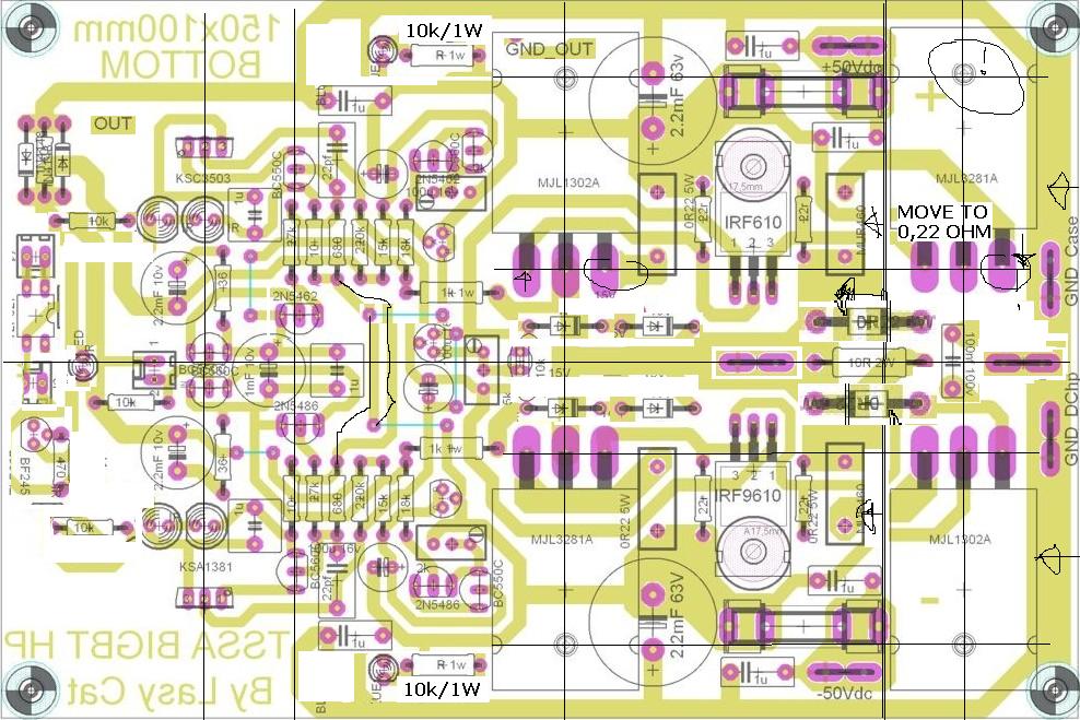

And here's my interpretation of your PCB. 😱
Explanations:
- MUR460 are size as now
- power supply indication LEDs need 5 mA, 10 k/1 W resistor is enough
- move left part of PCB to 0,22 ohm to get equal distance from both MJL to IRF (IRF exactly in the middle)
- use PCB area over outputs to spread the parts more freely (power supply pin, fuse, 0,1 uF etc)
- align outputs pins to the same horizontal grid
- use horizontal middle symmetry line to get simmetry from lower and upper part of the pcb (2N5462 according to 2N5486 etc)
- TLP section rearanged as you can see
- align input BJTs, trimmers, etc (parts in the middle) to horizontal middle symmetry line
- use wire jumpers of the same lenght, so one can prepare them as the same part in quantites
- etc
OK, I think you've got an impression now. 😀

That's good impression.....they make me progress.....when it commes to such détails it smell good (direct traduction of a french expression)....
Thanks for spending time on my work to propre evolving.
