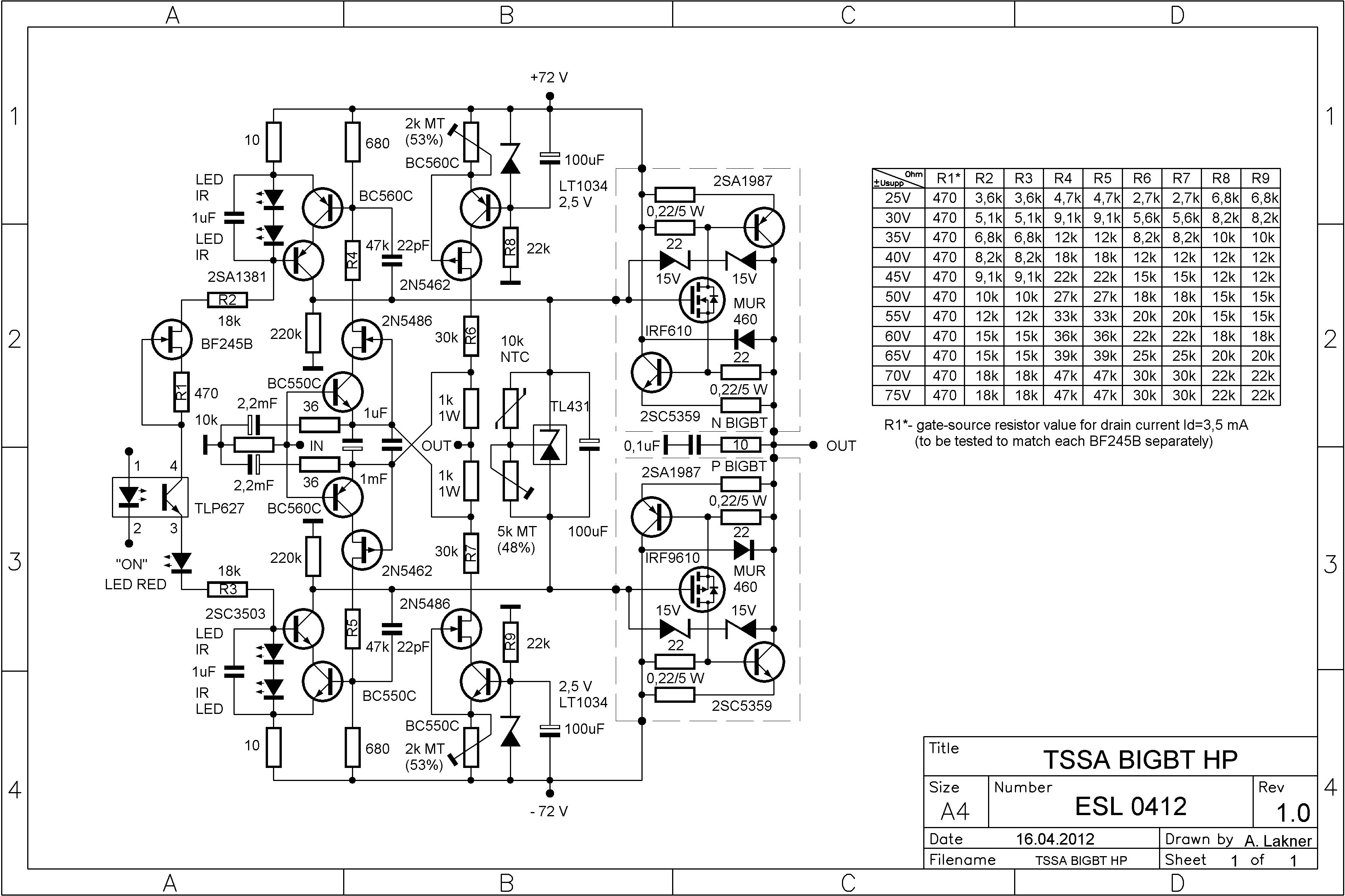

TSSA BIGBT HP update
Update released
Changes:

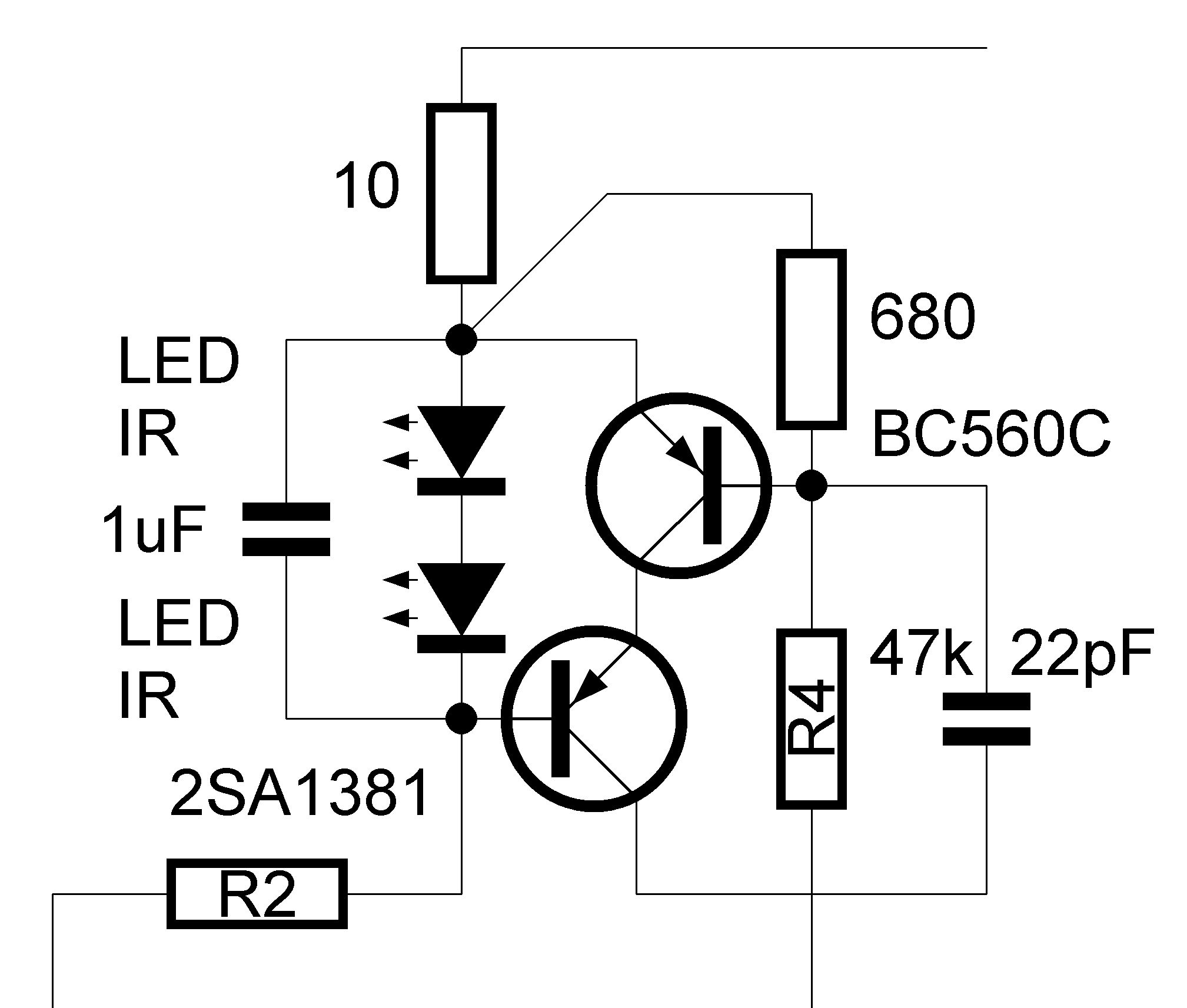

- VAS cascode - two IR LED per cascode
- "ON" RED LED added - indicates bias-on state
Regards Andrej ;)

R6, R7 are voltage dumpers to CCS, necessary to use because 2N j-fets have too low Vds/power dissipation specs. Current through R6, R7 is constant as CCS-s are capable of, so ideally no modulation should be present on these resistors. Of course it would be better to use source/sink transistors without voltage dumpers (double cascoded CCS). CCS are not ideal and there's always tendency to have increasing level of distortions according to higher frequencies. Separate measurements of CCS shows their capability to maintain the current to be constant. If you suggest to replace the resistors with improved CCS-s you are invited to do so. ;)
Possible ripple suppression would be to add small parallel caps across R6, R7, just to prevent AC modulation (low level ripple) as voltage drop on them.

what if you reverse the positions.. so you place the resistors at the rails and the current sources where they belong. then you get both....reduced dissipation and no signal induced current modulation.
Changing the position of the serial part inside a current loop doesn't change the voltage drop on that part. I think CCS has to be connected to rail potential otherwise it would loose its reference. :rolleyes:
Think you should rearrange the driven VAS cascode... make the connection inside the Rail resistors for the input pair.
Can you be more specific or can you please draw it. :)
Thanks ;)
MiiB, maybe you think about something like this? :rolleyes:
In this way VAS gain transistor has input-differential current included in its local feedback. That can be helpful in extra reducing the distortions, since it doesn't influence back, 680 ohm resistor can be practically connected to any positive potential.

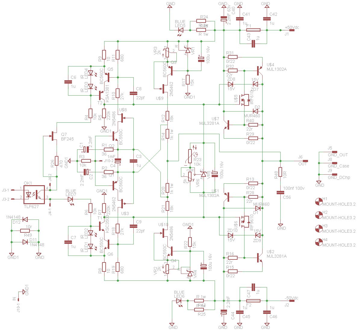

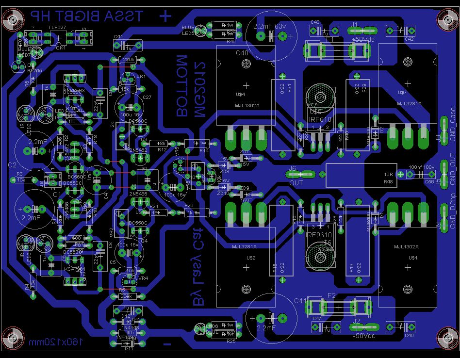

Regarding TSSA BIGBT HP PCB; is it possible to sueeze PCB more to eliminate empty spaces - quite large empty areas all over the PCB? PCB will be much smaller, more HF acceptable, shorter tracks, etc. What about VAS cascodes heatsinks? :rolleyes:

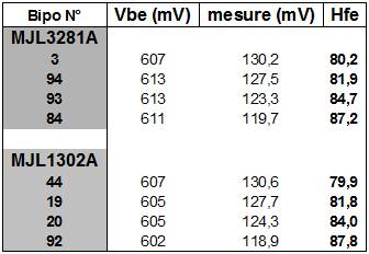

For BIGBT i have selected 4 MJL2381/1302 couple from a batch of 100u each after mesuring Vbe and HFE. I was just searching what conditions / mesure i do apply to select go mosfet candidat for BIGBT knowing I had good ones for output bjt. See attached document (pair 3/44; 94/19; 93/20; 84/92)
I take a look at NJW3281G/1302G datatsheet. They seems to good candidat for job as NPN/PNP gain matching is giving in 10%, that let good matching previsions between NPN and PNP after HFE/Vbe mesuring session.
For layout I need to rework to see if i can gain space et reducing traks length, but i am in single layer....that not easy. Pearhaps i can do something with TSSA core to bring it back, more closely to BIGBT module.
For VAS cascode i have let room around them, but i have any precise idea of the heatsink power requierement.
Marc
