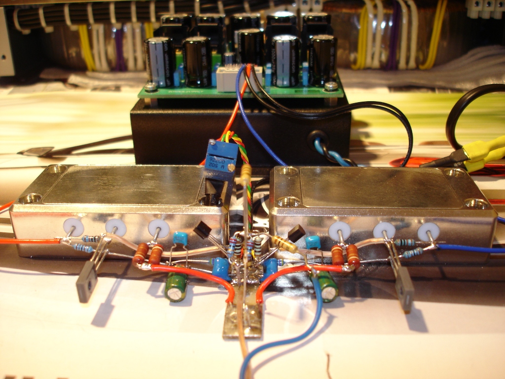

Idefixes, if you have thermal tracks than first make point to point wire nest. Mount TT-s on a heatsink, than step by step add and wire parts, similar like sonnya did. I think it is not very demanding job to do and test, before you go to PCB. You will also check if everything is OK and if the sound is acceptable. 😉
And don't forget to thermally couple input pair. 🙂
Idefixes, if you have thermal tracks than first make point to point wire nest. Mount TT-s on a heatsink, than step by step add and wire parts, similar like sonnya did. I think it is not very demanding job to and test, before you go to PCB. You will also check if everything is OK and if it's sounds acceptable.

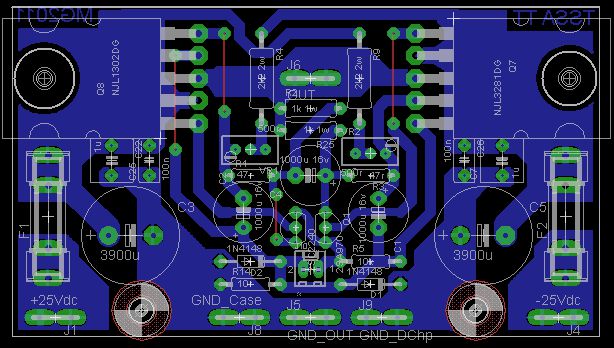

I am not aware with point to point.....and find funny pcb art work as i can produce at home... I have 5 couple of NJL1302DG/NJL3281DG on hand , 47.000µ 35V and a 400va 2x18V toroid transformer i can swap just for test from a another project
I not shure to try P2P, bad experience with tube electronics....

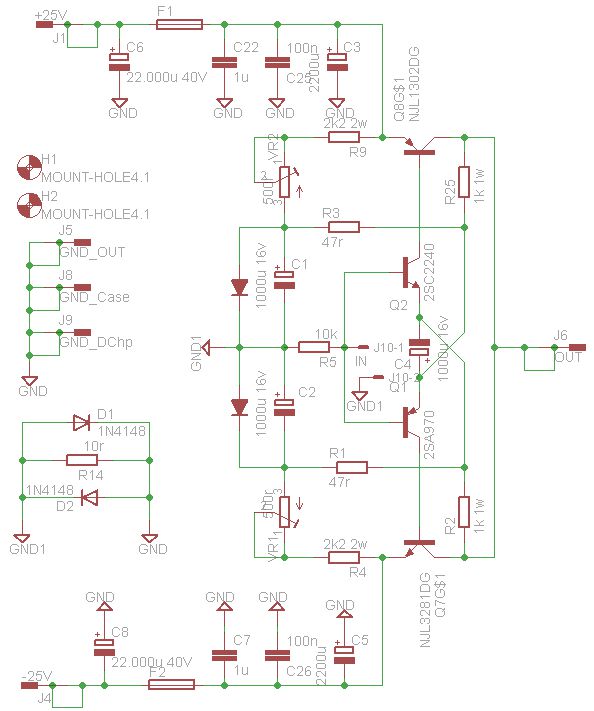

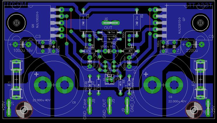

A couple of houre with eagle see attachement ... 123x69mm

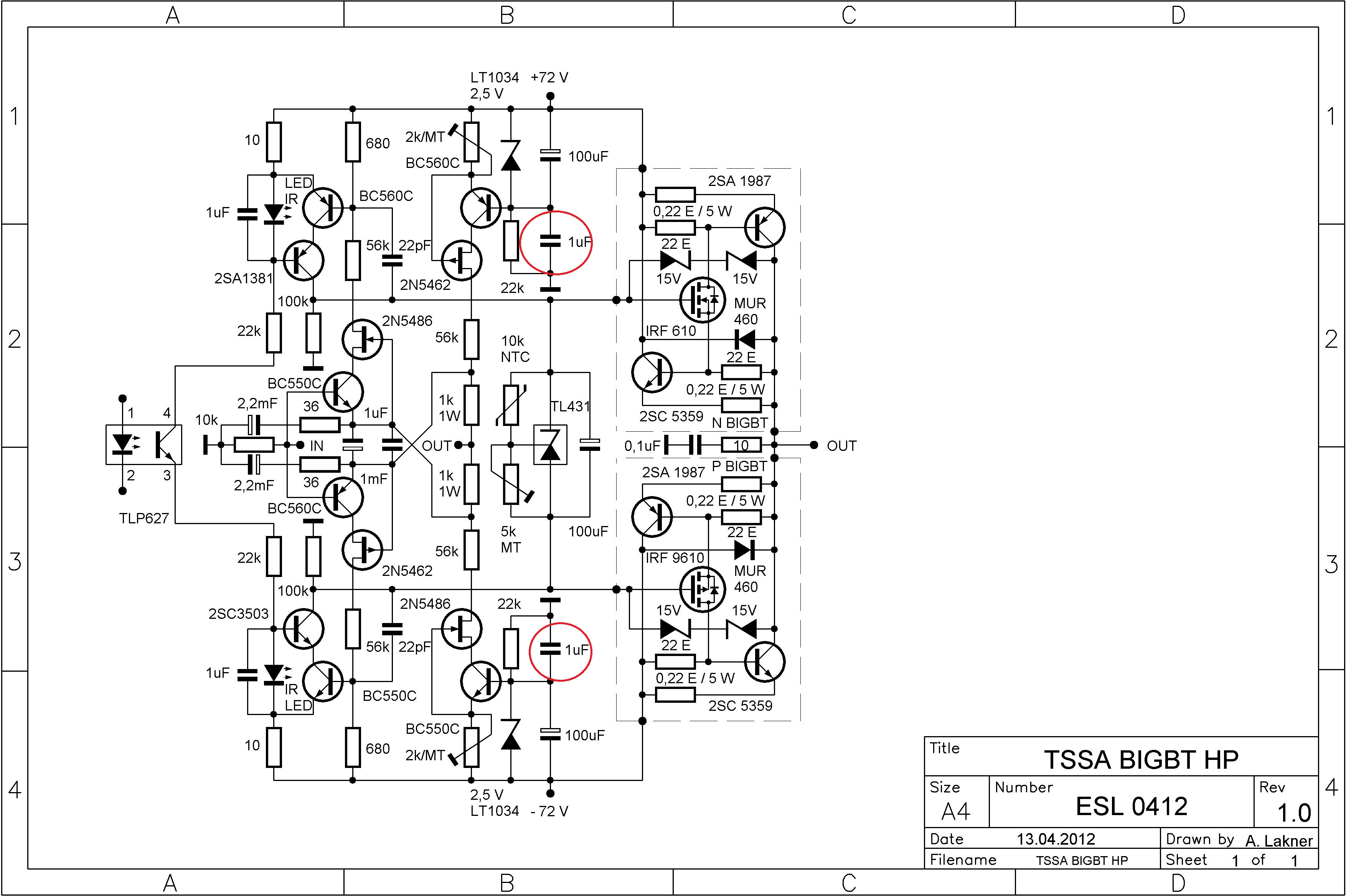

Testing/ironing out TSSA BIGBT, allowing/confirming a range of PSUS 45V-70V and issuing a board would be a happy practical conclusion of the Andrej ideas threads. What is the projected power range for those supply voltages?
the simplest !
post71 shows ~75 components.
This one is HP-high performance version, based on TSSA, logically that it has more components, performing specialized jobs. 😀
The only one named the simplest-TSSA from post #1 has 17 parts all together, successfully tested by sonnya. 🙂
Exact essence of this and SSA thread lies in Salas words:
All varieties of the SSA circuit has the purpose of thread evolution and maybe, I say maybe, from all the posts we'll squeeze out only one little diamond. 😉
Hi LC, what is the +/-Vdc rail limit to use with #57 schématic?
Marc
Definitive limiting factors are BC550/560 Uce max. and their power dissipation. Power transistors can take into/from their bases 100 mA and more, and that can be well over BC's capabilities especially if you consider SOAR. BC's can be replaced with 2SA/SC TO-126 transistors but with a little decrease in HF and noise performance. These four BJT-s are major limiting factor, also with only one output pair you can not expect to get out more than 50 Wrms/4 ohm load by any BJT selection. Please try by yourself to calculate BC's dissipation in the worst case conditions and you will see.
Lateral mosfet version has a little more headroom, but charging gate input capacitance at HF is another difficult task. Still no more than 50 W/4 ohm full power bandwidth . 😉
