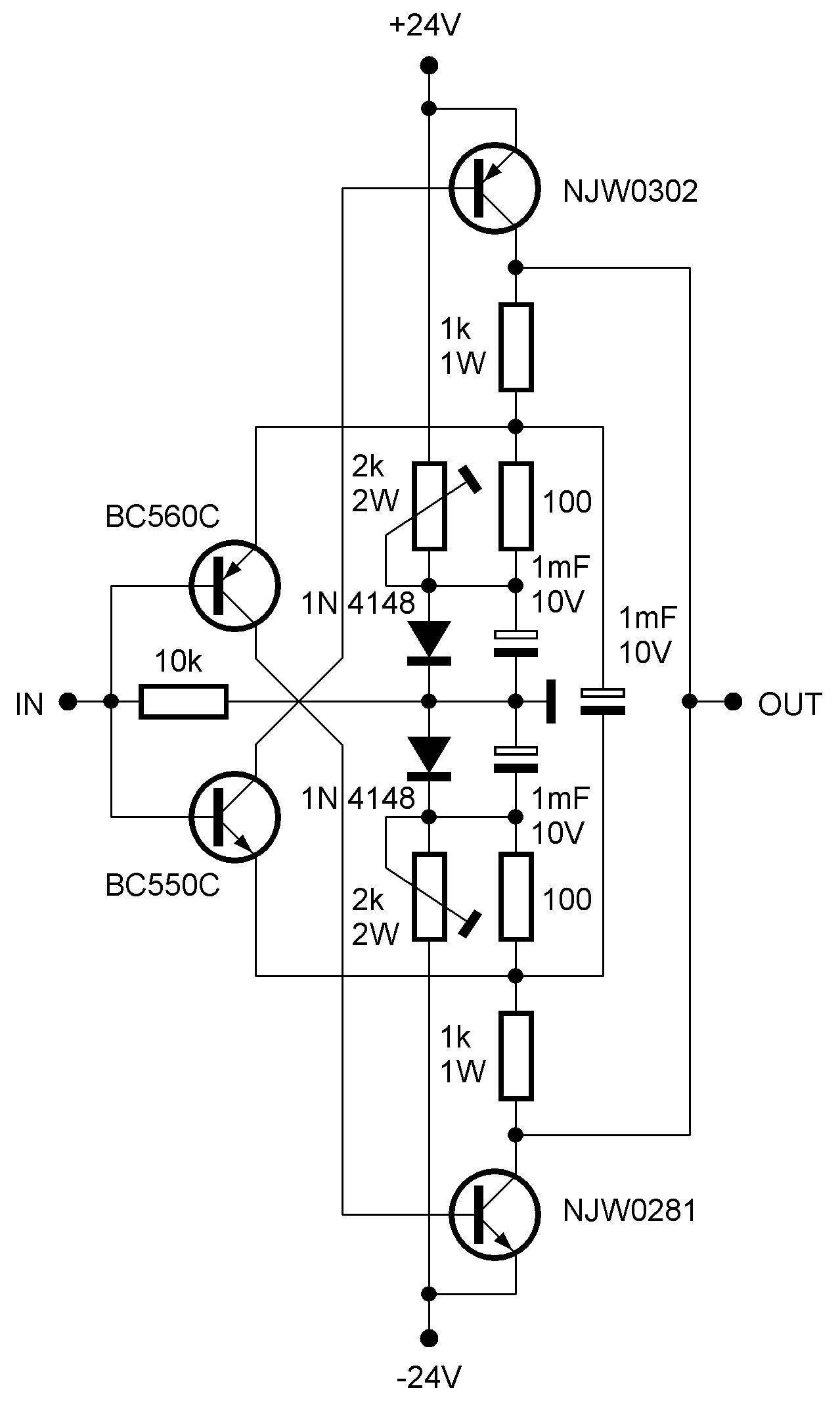

TSSA - The Simplest Symmetrical Amplifier

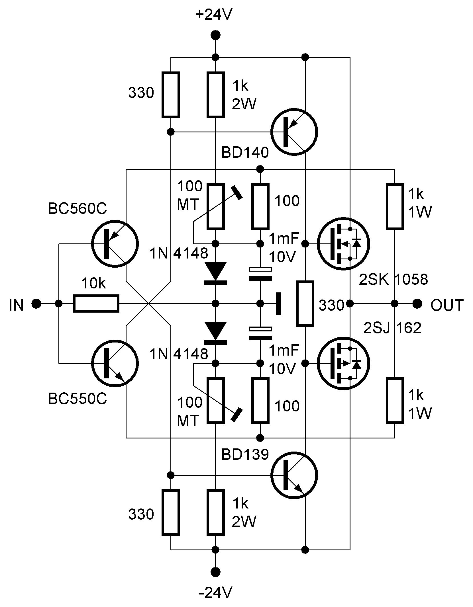

Logical evolution: TSSA with VAS. 😉
One benefit this amp has, the 1N4148 bias potential diodes thermally compensates input BJT-s Vbe tempco, thus stabilize VAS bias current. 😎
Hi sonnya 😉
Yes and also input cap, some decoupling caps etc. Intention of this sch is to show basic principle more clearly, it is not final product sch.
Did you test TSSA first post sch yet? This feedback bridge doesn't have any injecting current, which imediately brings two benefits, thermal stability plus no modulation of injecting current, simply because it isn't present. 😉
Aha thanks, missed them, were posted in between I wrote ... 🙂
Hej not bad at all considering four trannies only and to be symmetrical. Input BJT-s, splitted feedback bridge and biasing are working properly. Lowering distortions is a matter of more sophisticated schematic. 😎

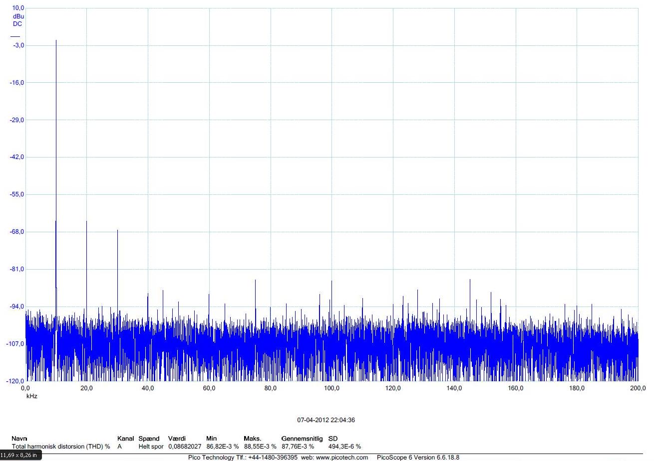

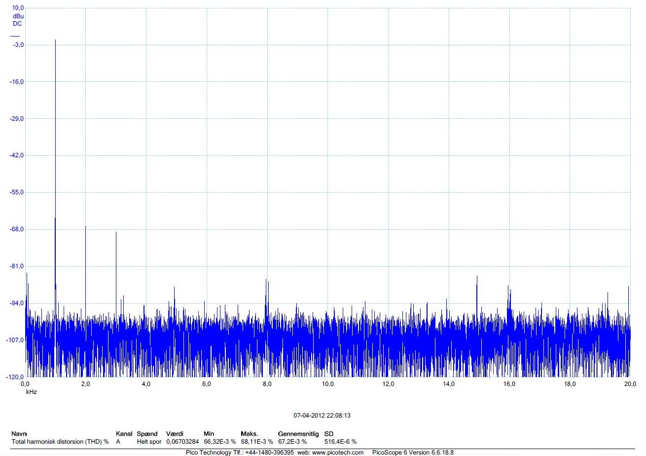

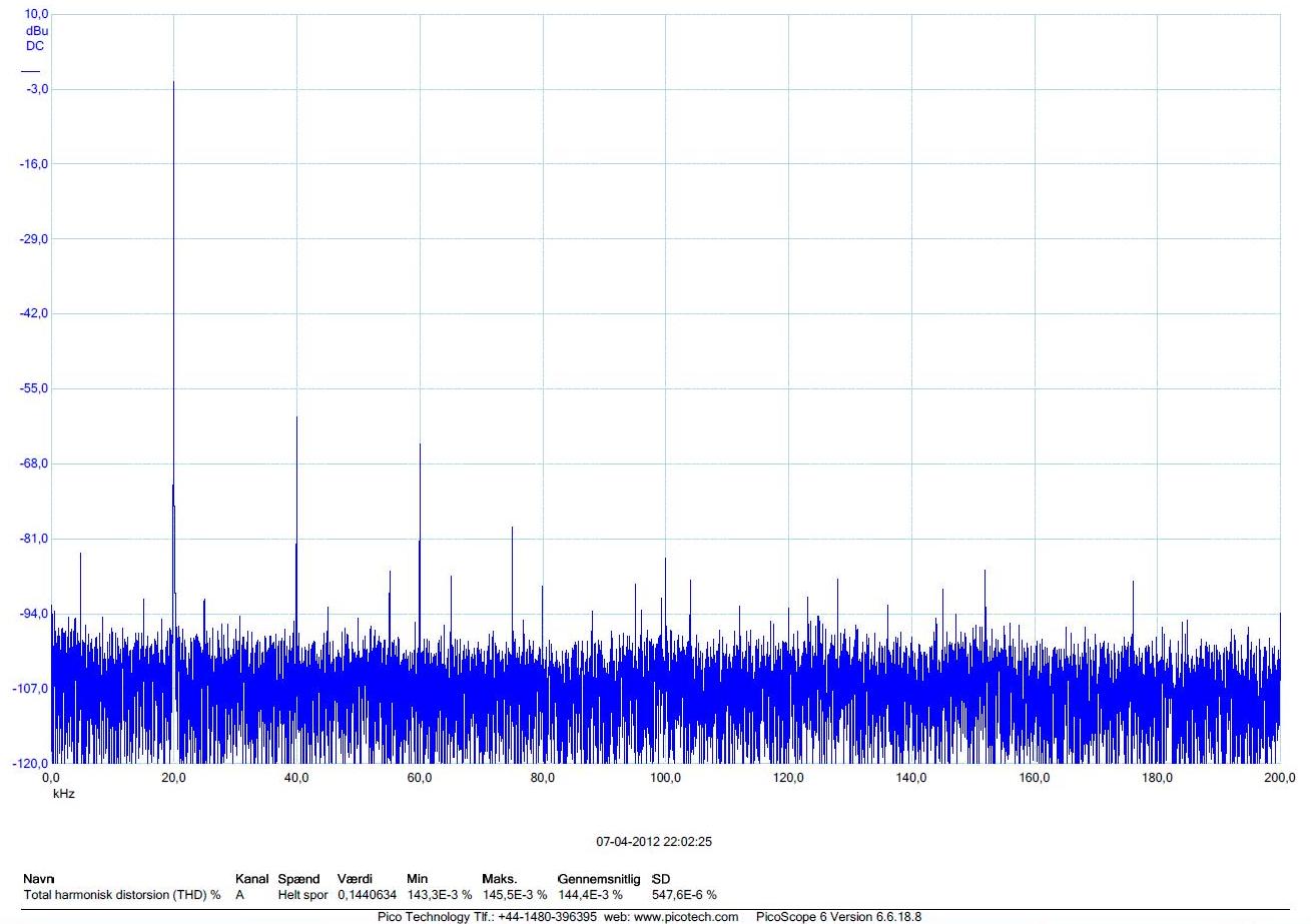

TSSA schematic from post #1, built by sonnya, all together four transistors only and as you can see from the pics very promising results. :wiz:
