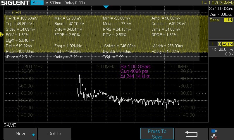

Trying to measure noise With Siglent scope
Reactions: thumb
You may be getting some noise through the power input in the supply, or if grounded through the ground via the OSC. You could go differential.
You're starting to get into the territory where the OSC = speed vs 8bit, then compared to the audio spectrum analyser where less speed (1-200KHz roughly - a sound card/USB ADC) and 24bit vs RF spectrum analyser which starts at 9KHz and goes up and up. There's no one tool that does it all.
I have a SDS1202x-e but below 80-100dBV on the FFT I would prefer a differential 24bit ADC acquisition card.

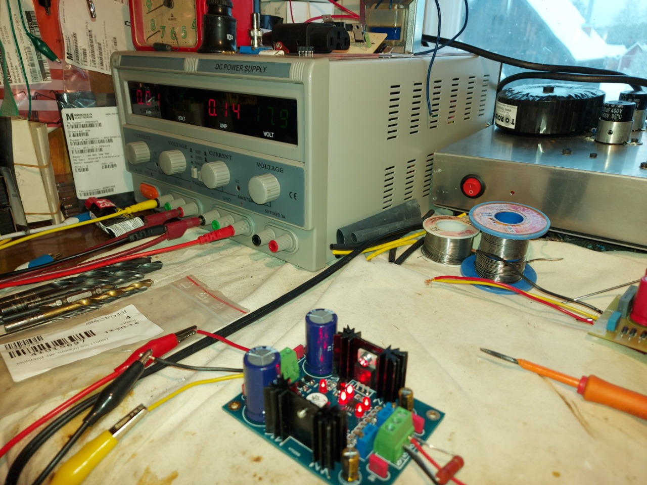

The setup:
My first take on the FFT,but I find it a little strange that the pk to pk changes when I change the amplifud on the scope.That makes it a little hard to get a grip on what is the right value.
And I dont know how to read the FFT to.....
Yeah - but you didnt show how the scope hooks up to the output of the regulator. I see a load resistor, a red and black wire. Then where's the probe?
As I recall, noise measurements on a power supply are all about how the scope probe connects to it. We'd use a scope probe tip socket, with 1/4" lead lengths on both tip and ground connections. That socket would have been soldered directly across the load resistor leads, as close as possible to the output connector.
Ok the probe is set on the red wire the positive,the wire is about 4-6cm long.
And the crokodile grund is on the black wire.maybe i should connect i on the resistor leads?
The best would be a screened BNC wire soldered directly on the load resistor, and the load resistor as close as possible to the PSU output pins.
Connecting the scope ground clip to a ground wire on the input of the supply invalidates any measurement.

Yes,I have an older probe that I can cut and solder direct on the resistor.

With bandwidths in the ballpark of 100MHz and 8bit ADCs the resolution is quite poor. What you see is noise outside the interesting audio band, often caused by the scope itself. And the numbers you read are pretty useless being unrelated to audible noise. Generally I consider the scope inadequate for audio noise measurements, just the wrong tool for that purpose. Any sound card with a software like REW or ARTA is way better.
The old probe cable was broken ,so I removed the shorts cabels from The psu an connected The new probe disrectly to the loadresistor.
And The lowest I can get is about 7mA.
Its flickering betwen 6-9mA.
