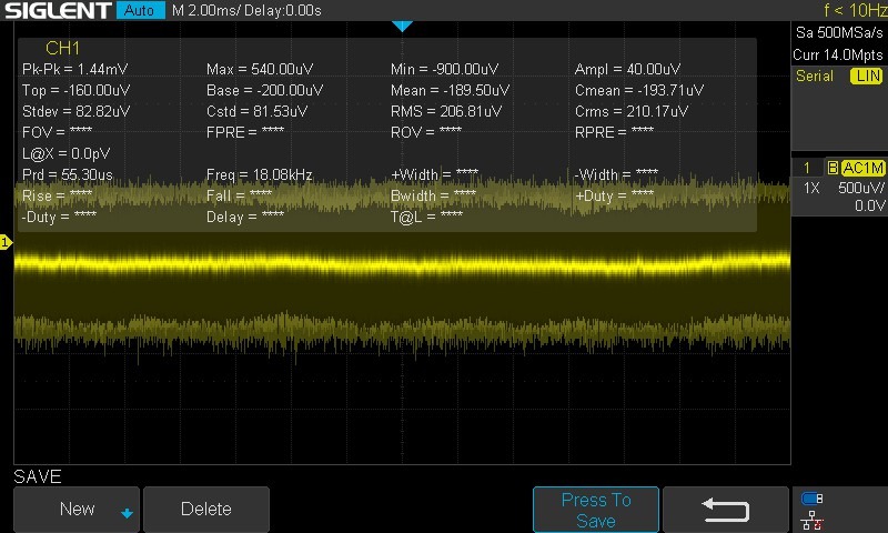

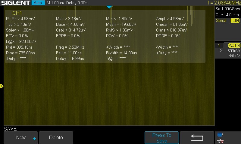

Here it is with the probe shortcutted,and a bandwith limit at 20Mhz.

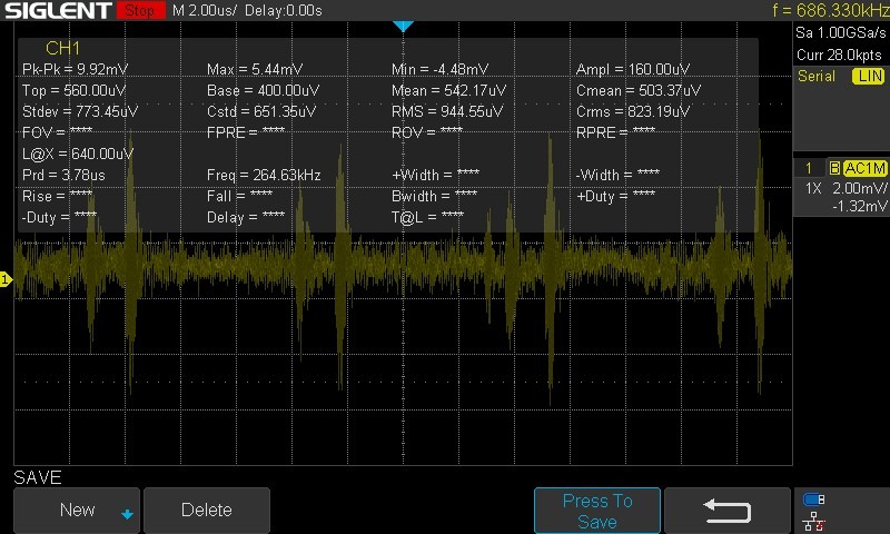

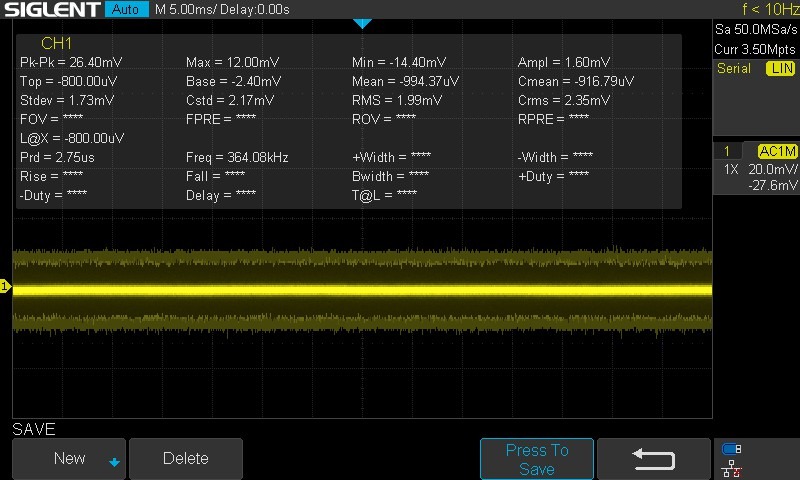

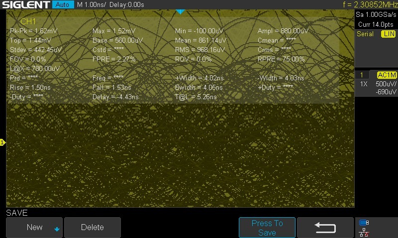

Here it is PSU,the module with a 120mA load. The Pk to Pk value is flickering never still betwen about 10mV to about2mV
