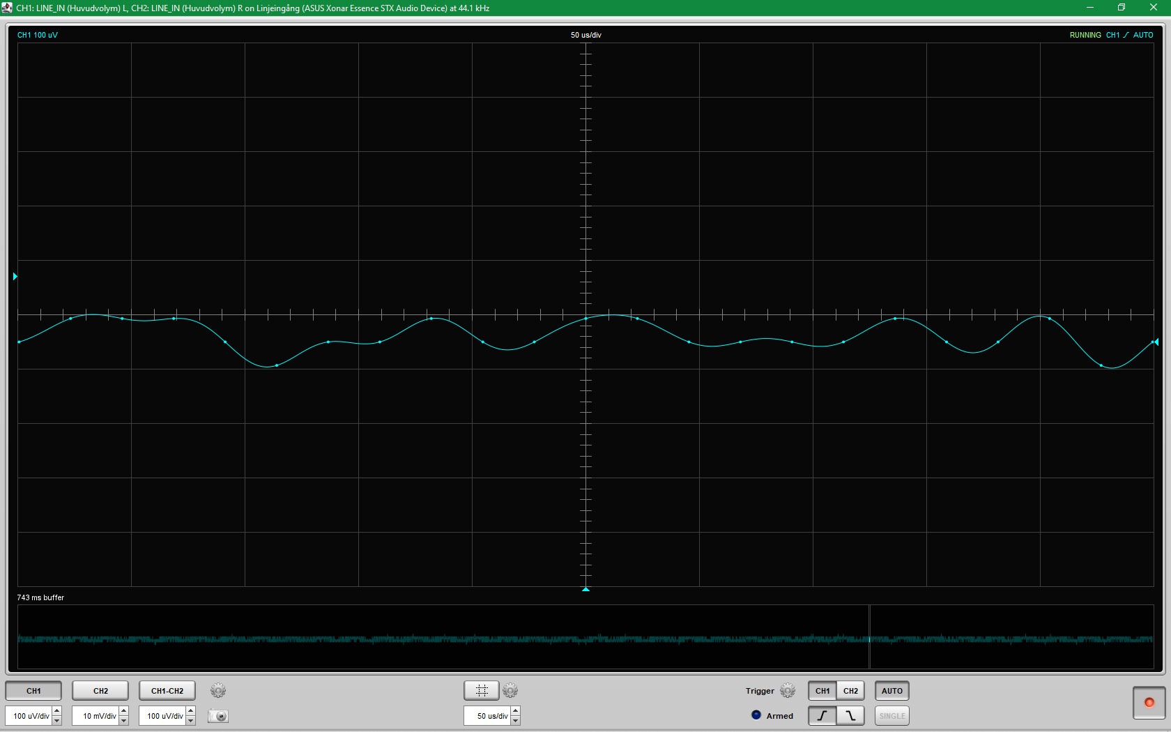

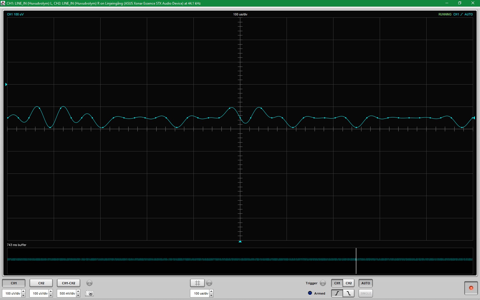

This is what I get with the input disconnected and all the software volumes set to zero.
Does this make sense?

Or, if you have a decent SG, set it for a -67 dBm output and the scope for 50 ohm input. And be very careful about noise introduced from other sources such as lighting, wireless APs or computers - anything with a switching supply. Also, as Jan pointed out, 100uV is a good noise level from a linear supply and a very good one from a SMPS.

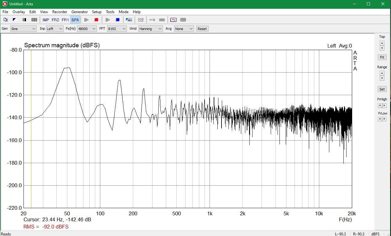

This is a messaurement I did on my PC nothing connected to the sound card ,and the input grounded.
The 50 hz is quite large here,could it be that one I see on the next meassaurement?Wich is also PC with grounded input.
I've yet to see an FFT built into a scope that was worth the powder to blow it to hell. Sound cards usually do better. Noise is difficult. If the level is low, there won't be enough gain to see what's going on. When I look at noise I use an analog scope and a differential plug-in with filtering (lest what you want to look at be buried in irrelevant high frequency noise) and a gain as high as 10 uV/division, though audio never requires going quite that far. Looking at noise without filtering is a fool's errand and putting a number to noise always requires specifying the measurement bandwidth. A really good project is to build a scope preamp with some filtering. It can be a 1-opamp project with a couple batteries. That will give you something that moves the noise into the capabilities of the scope.
The 50 hz is quite large here,could it be that one I see on the next meassaurement?Wich is also PC with grounded input. View attachment 1046228
