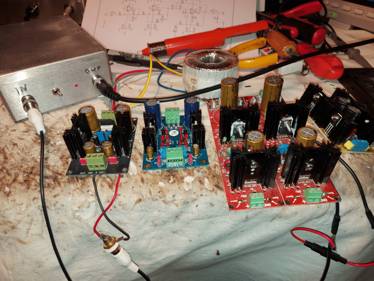

I am trying out the measurement amp.I am trying it on 4 regulators,heres the regulators from best to worst.
And the winner is :
A cheap ebay shunt regulator...
The result:
LM317/3337 reg :0,00024v
Ebay reg 2 with leds:0,00006v
Quanghau shunt: 0,00003v
Ebay shunt Winner :0,000004V
Hope I got it all right.
I calibrated the amp to my scope so it is to be taken with a grain of salt,but at least I can se the noise of the PSU´s.

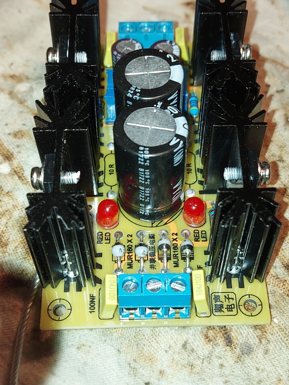

And the winner is :
The result:
Assuming this is a broadband measurement, what was the measurement bandwidth?

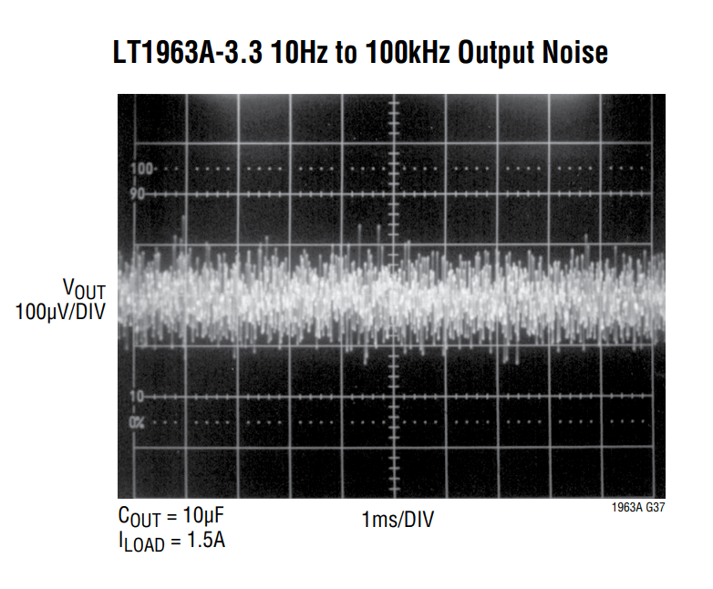

A couple of points on measuring noise gleaned from doing it for customers for 30 years:
1. Start with proper scope probe technique which means not using the ground clip lead ever, like this.

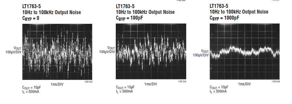

2. If you want to measure the output noise of a really low noise regulator, the sadly departed Jim Williams showed the way with App Note 83. After his death Todd Owen picked up the ball and App Note 159 has a somewhat improved circuit with 80 dB of gain and 150 nV RMS noise floor. The circuit in Figure 2 is a real challenge to build. Start with a nice big tin of cookies.
