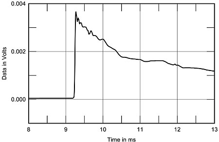

Theoretically, ( I would think ) full range speakers should ALL have a good step response...unless something real ugly is happening.
Most of them (full rangers) do not have that good of a STEP. Breakup of the cone being a good reason to start messing it up among other things.
It isn't easy to produce a good step, certainly not with the dynamics and SPL you'd want too. That triangle in Stereophile isn't even that good. Look at a measurement from a Dunlavy speaker at the listening position 3 or 4 meter away from the speaker instead of the usual close up measurements. That's where it starts to being good.
That's quite a bit better than the one in the article.
Chasing it myself with my line arrays, not totally there yet
I can produce a cleaner one with a different EQ target (mine is sloped down to HF) so the start is more like the triangle in the Dunlavy STEP. But this is where I started after correction with DRC. It will hopefully get better. But in listening it makes quite a difference to a crossed over speaker. And not only on a few songs either. But you've got to really want it, because it won't come easy if you want the SPL etc.

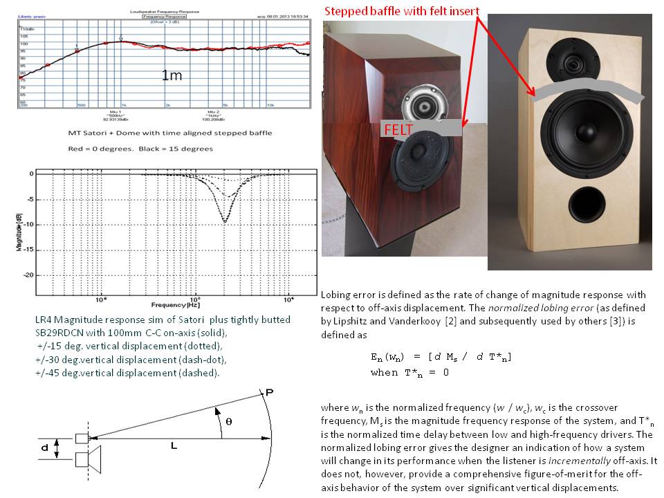

I'm not trying to phase equalize or time align anything, unless I see a big suckout in the frequency response where I sit to listen, in which case I'll switch the polarity on one of the drivers and measure again. I'm one of those people who doubts if I can hear a time alignment issue if it hasn't caused the FR suckout, and it isn't between about 800HZ and 5kHZ, where the ear is most sensitive. I believe it to be a very small issue compared to many other issues in a speaker system.
The way I see time alignment issues is that they cause off-axis beaminess around the xover freq., which is undesirable, but depends on the acoustics of the listening room as to whether it's a big issue. Going 4 pole active at 7kHZ would obviously be way better on paper, but I'm not convinced it's such a big issue once you're above about 6kHZ.

I think that if you were in an anechoic chamber, you might hear a difference between time aligned and not, with a somehow perfect recording. In a real-world situation with room acoustics and program source wild cards, I think it's really just about whether or not the off axis beaming interacts with room acoustics in a way that's even worse than how the room screws it up anyway, even with perfect time alignment.
I suspect that the ear-brain mechanism (which I've studied a bit) analyzes the various frequency bands discreetly (every 1/6th of an octave I've heard), and then interprets them together, if that makes sense. As a survival based protection mechanism? For most of history, as our brains evolved, we always needed to instantly recognize the sound of a dangerous animal stalking us, regardless of what the acoustics of the environment did to the phase or time alignment response.
