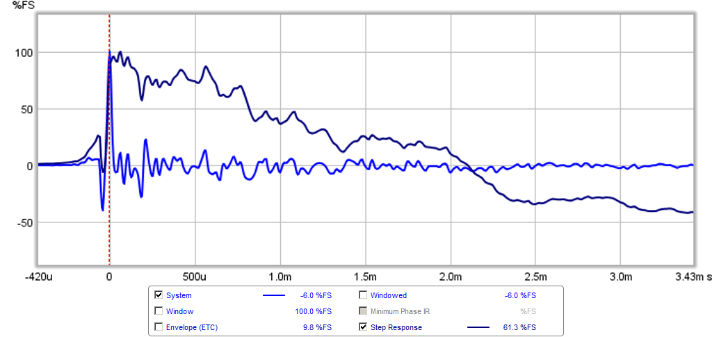

This is a Z baffle dipole with a compression driver on the front firing driver. There is no gate applied and measurement is at 0.5m so any reflections would not be in the 4ms time frame.
It really surprised me how it worked out. It took small incremental time delay adjustments to get the skinny tweeter peak to line up to the leading edge.

I don't think you are doing anything wrong, it's just that a triangle shaped step response is very rare and hard to achieve with a multiway unless you work at it and use the appropriate cross overs and have very wide bandwidth drivers.
My guess why it is working on the KaZba is that the woofer bandwidth is very wide and working almost like a fullrange, the tweeter is time aligned and adds the peak at the leading edge.
I don't think you are doing anything wrong, it's just that a triangle shaped step response is very rare and hard to achieve.
Agree totally. But this is why I find it so hard to evaluate step response plots. It either looks ok, or it looks a train wreck, with little between. I imagine that to the ear, the improvement is far less black and white. I.e. A middle ground step response, probably sounds less severe than the plot would have one believe.
There is an audible difference when you achieve a good SR. It is very evident with percussion. If you don't have it, you may not know what it sounds like and never miss it. Most people have never heard it I think with conventional speakers - they hear it in live music and know that live sounds live. When you hear it on speakers it sounds more realistic and live-like.

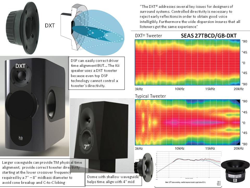

This 3-way Troels thread discusses solutions for:
1) 4" true-midrange as the key driver
2) 0.75" - 1" dome tweeter
3) 8" or 10" woofer
4) physical TM alignment vs. Xover tricks
5) how crossover phase shift affects sound quality
There are a few physically small NdFeB 0.75" -1" dome tweeters which integrate a very shallow waveguide which both provides time delay and directivity control. Tymphany BC25SC06-04 1"
There are a few "no-mounting" dome tweeters which can be inserted behind a shaped front baffle which provides time delay and directivity control. Tymphany OX20SC00-04 3/4" Fabric Dome Tweeter
DSP can easily correct driver time alignment but… The latest tech Kii speaker uses a DXT tweeter because even top DSP technology cannot control a tweeter’s directivity.
