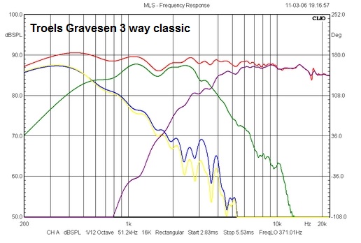

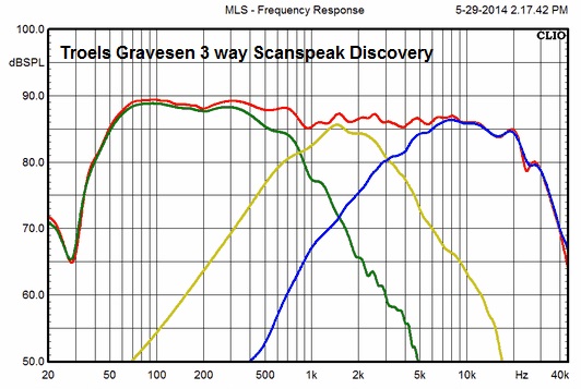

I know this thread is now some 4years old but was hoping someone could shed some light on the 3W discovery crossover component values. I see that system7 has tried to replicate them, but it looks like the images of the crossover design are now gone? Does anyone know crossover value? Thanks in advance, Brett
No, No, No. I wouldn't publish even my notions of the values in the ScanSpeak-3W-Discovery.
That would be robbing him of his livelihood. All Troels' children starving. Unable to afford medical bills for his momma... 😱
What I was saying is that armed with the Steen Duelund filter theory, you find most three ways start to look the same.

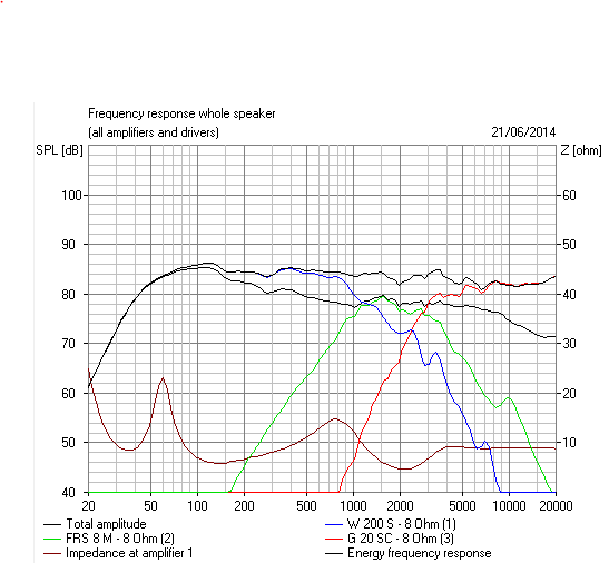

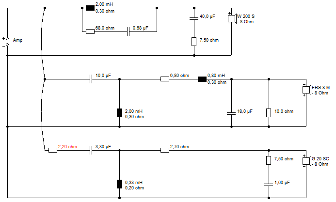

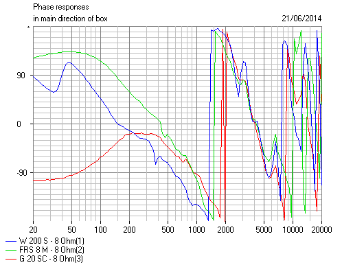

Minor complications include bafflestep and tweeter time alignment. But Duelund filters line up phase and amplitude very well indeed. This was a similar project in Visaton Boxsim:
What it's saying is you really just have to replicate the slopes, adjust for loudness, impedance and frequency response and maybe allow for time-alignment, and they are really all the same. Below are the missing parts of the theory which imageshack let me down on. Hope it helps.

Hi Steve, thanks for that. That has really helped me a lot. I've read all the articles, all makes sense really! I noted that troels' has included 2 capacitor values on the build page, so I think I'm on the money with all the values now, I started with the two known values and worked backwards from there, then tried to match his posted response. Boxsim really does make life easy, doesn't it 🙂 next is to build it and measure the real world results
