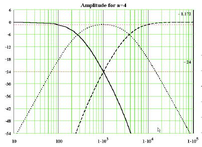

Don't forget that a fullrange can usually make a rather good mid. Without knowing what you have, I can't make a more detailed suggestion. But the Duelund theory is right.
That's one of the slopes you can do, if you do this 4th order and time aligned to whatever degree is practical. I like that one. 🙂
We are all newbies to audio really. 🙂
Thing is, all designs are a compromise IMO. Certain laws of physics say say you can't do an even order filter (LR2 and LR4) two way without a power suckout at crossover. Above and below axis. Or you do BW3 and accept that it lobes above or below axis.
Steen Duelund was a bit of a genius in realising that a three way has to hang together with all three drivers and depends on time alignment. If you do it right, you might go 8", 4" and 1" and get everything nicely aligned. And in a way, there is only ONE crossover frequency. Usually around 1.5kHz.
There are various solutions in 4th order Duelund theory. A wide midrange, or one that just fills a bit of a gap between woofer and tweeter. The wide midrange is mostly 12dB/octave second order. Simply speaking, some of the crossover components become redundant.

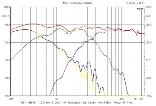

Troels Gravesen designed the hugely popular SEAS 3 Way Classic.
It leads to a third order tweeter to align phase.
His wheeze was to then time align the tweeter into the Scanspeak 3W Discovery and use LR2.
When you build a 3 way, you can almost predict the success of the sound from how closely the curves approximate Duelund theory. I think the 3W discovery inevitably looks better than the SEAS 3 way classic. But both good. And both do a great job of aligning phase on ALL THREE drivers.
Without overcomplicating things, there are some other shallower and steeper optimised solutions too. But this works.

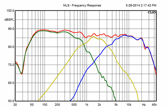

I am getting ready to set up a (budget) test bed for playing with cool time-aligned 3-way XO's. I have a 12in woofer (Beta 12cx or dual TB W5-876SE's), an assortment of great wide bandwidth full range drivers for the mid (Vifa TG9FD, TC9FD, SS 10F/8424, etc., and if needed I even have a Heil AMT for the tweeter), and a Dayton DC28F-8 silk dome tweeter. I will be using a miniDSP in 1x4 mode and tri-amping, so I will have any XO at my disposal. Plan to put the woofer and mid in simple open baffle, or maybe sealed for the woofer. Based on the drivers I have, I am guessing that the singular XO freq will be 1500Hz. If anyone has pointers or advice, please let me know.
I really want to learn how to play with these Duelund XO's or the B&O hole-filler XO.
The DISCOVERY 3-way seems to be a good place to start and it looks like a solid 1500Hz XO point:

Looking forward to the further findings of your experiments. The Discovery seems to have a somewhat prominent woofer output from 65 Hz to 900 Hz in comparison with mid and tweet. Curious to learn how that compares with totally flat.

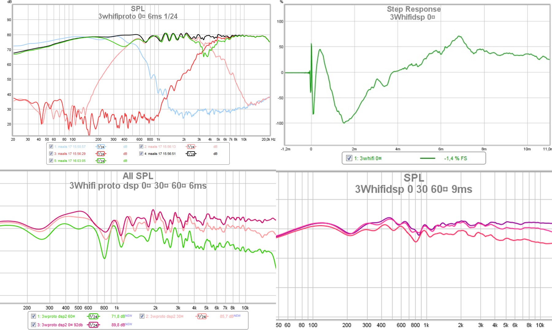

I had this proto some time ago. Double 8" SEAS, Audax 4" and Fountek ribbon. Minidsp and in this version LR4 filters. Bass response is sloping too fast but it comes from vertical directivity of the double system. Center xo close to 1500Hz. Notice the excellently smooth horizontal directivity! Sound was fine but I had just one speaker.
Oh, I tried also LR2 but it didn't sound so good. Perhaps it was just careless fine-tuning but I have had similar experience with other projects. Too much ovelapping will lead to more IMD, demand for perfect slopes is higher?

Duelund's Idea: Duelund wanted a multi-way speaker where drivers are ALL in phase at all frequency (as exactly represented by his Mathematical model).
Regarding the above transfer function, to be a Duelund's filter, the bass/tweeter slope must be approximately LR4 (or staggered LR2) and the midrange must be approximately LR2 bandpass. What we see in Troel Gravesen's is a full LR2.
