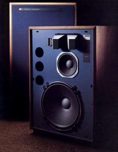

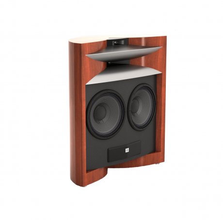

Have anyone compare Troels Gravesen The Loudspeaker 1-3 to a high end speaker from B&W, Sounus faber, JBL?
Hi! At some point, the question is silly 🙂
I cannot answer as you want. But if you have a decent audio rig and a medium/big room those kind of speakers will blow your mind, especially if you value live concerts.
If you are an audiophile like guy, those are not for you 🙁
I'we listened JBL 4333A in a 4X5X2.7 meters room (small I would state) and they sound awesome (belongs to a retired recording engineer). Also I have listened, in a quite big room, the Genelec 1038B (active loudspeakers) driven by a very good valve balanced preamplifier, and the sound was 'reference' (not exactly in the audiophile stile, I would say). Genelec sounds almost perfect in every way, lacking just a hair of ultimate 'audiophile' excitement, while the JBL has more bloom/texture in bass and midbass. Both examples are big speakers, using 15" low frequency drivers, delivering outstanding dynamics. Both are intended to be studio tools - designed for mastering . I am using my own design two way 15" and a 1"+ SEOS15 waveguide (both are Beyma drivers) in a 125L cabinet, and I am more than content with it in a small room.
