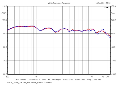

Listening at low volumes, for my taste, you don't need a bass boost at all, I just slightly modify the gain of the subwoofer amplifier. . I'd like a bit more extension at the higher frequencies, but I'm not sure if it's due to my ears or the preferred TG curve. He has repeatedly said that excess glitter "sells", but that it is not real, he prefers the BBC curve, with a downward trend from medium to high, and approximately 18 Khz, according to the graph. attached to the DTQWTII, it drops quite steeply.
It placed three levels of tweeter attenuation with fixed resistors. That was a few years ago. I chose without hesitation the R with the lowest attenuation (1.8 Ohm), but I think that at any moment I will eliminate it ...
On TL3, he opted for a continuously variable Fostex attenuator for the horn. This is how it was used in the good days of JBL, Altec, etc.
