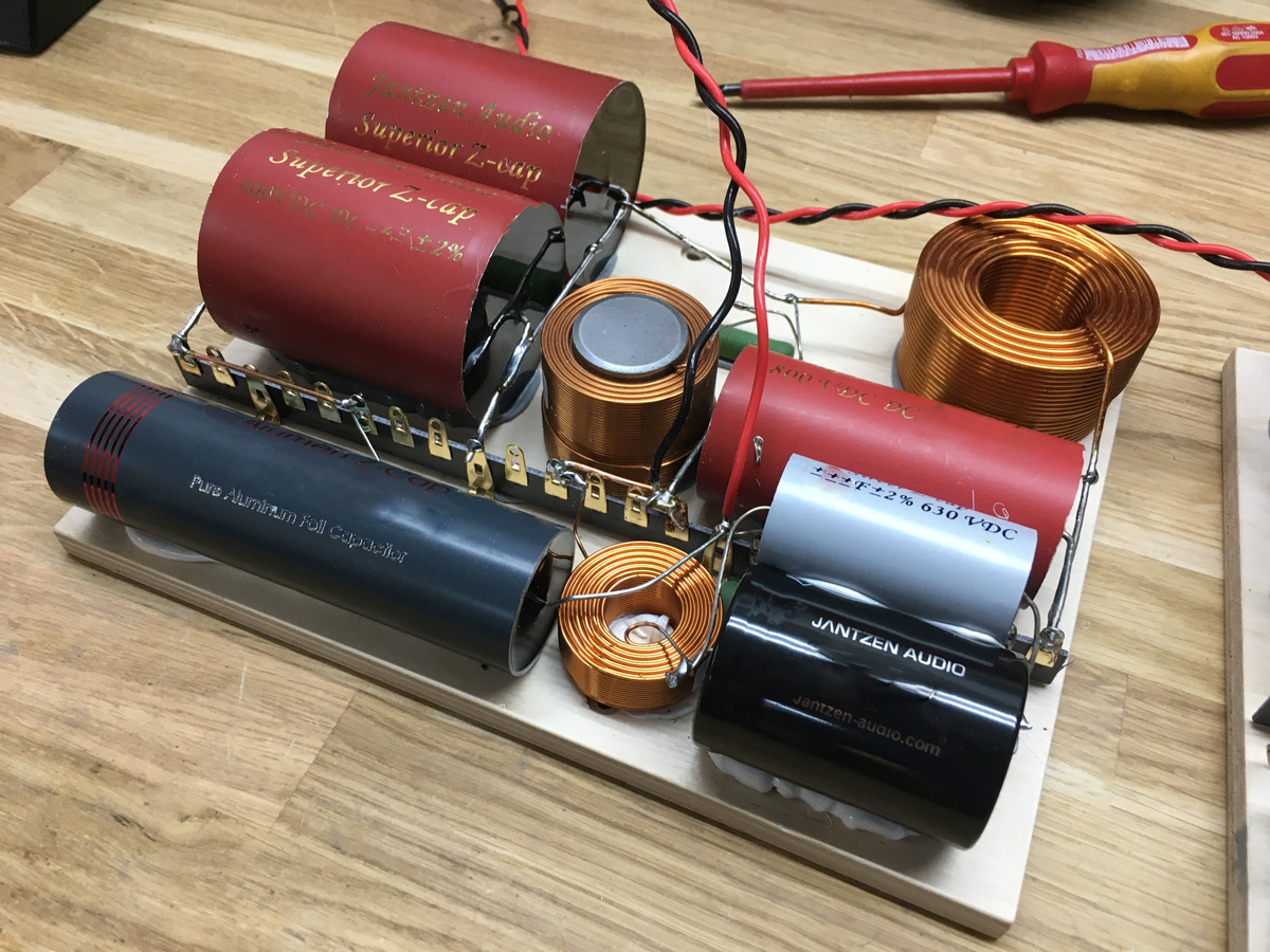

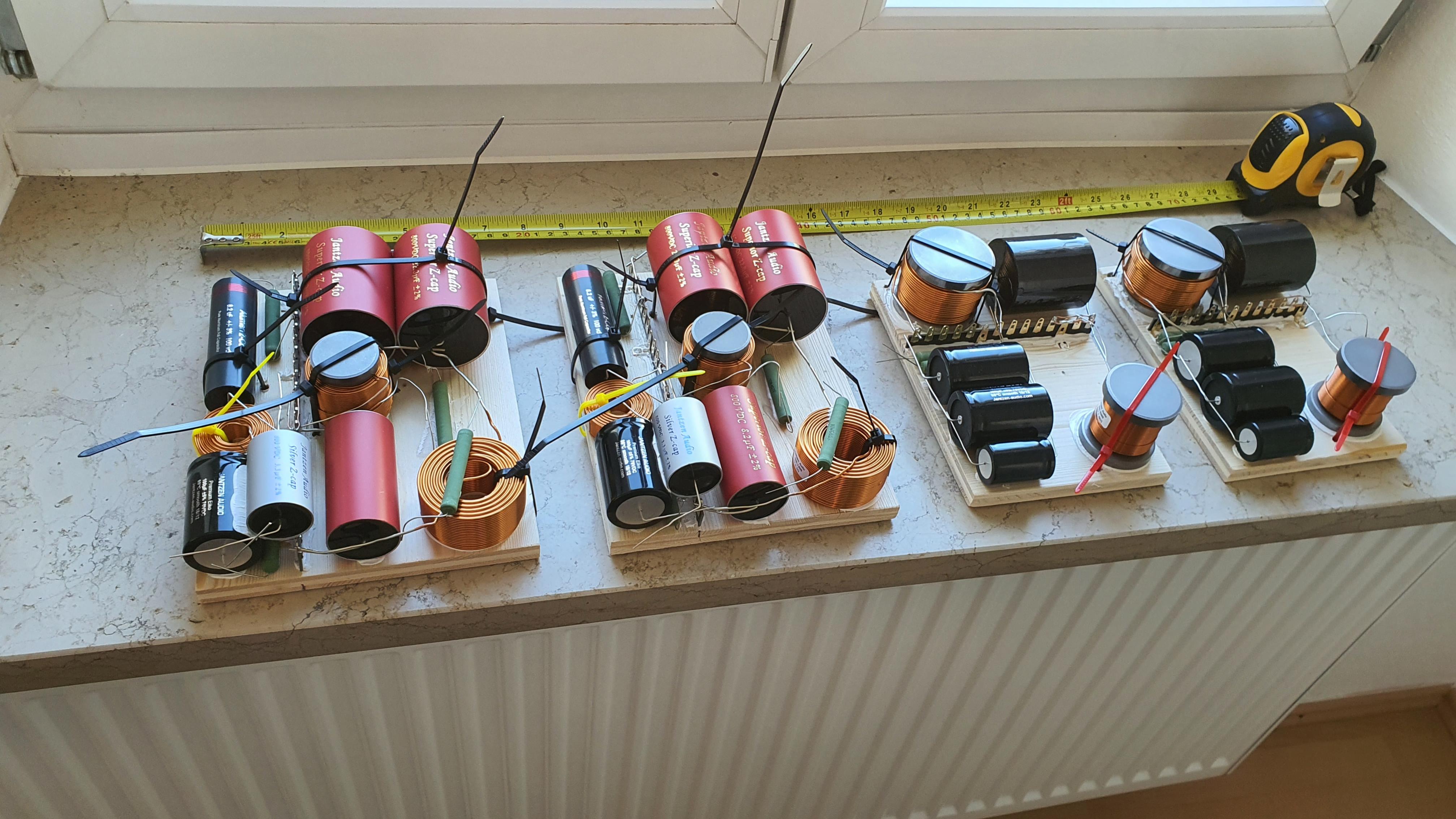

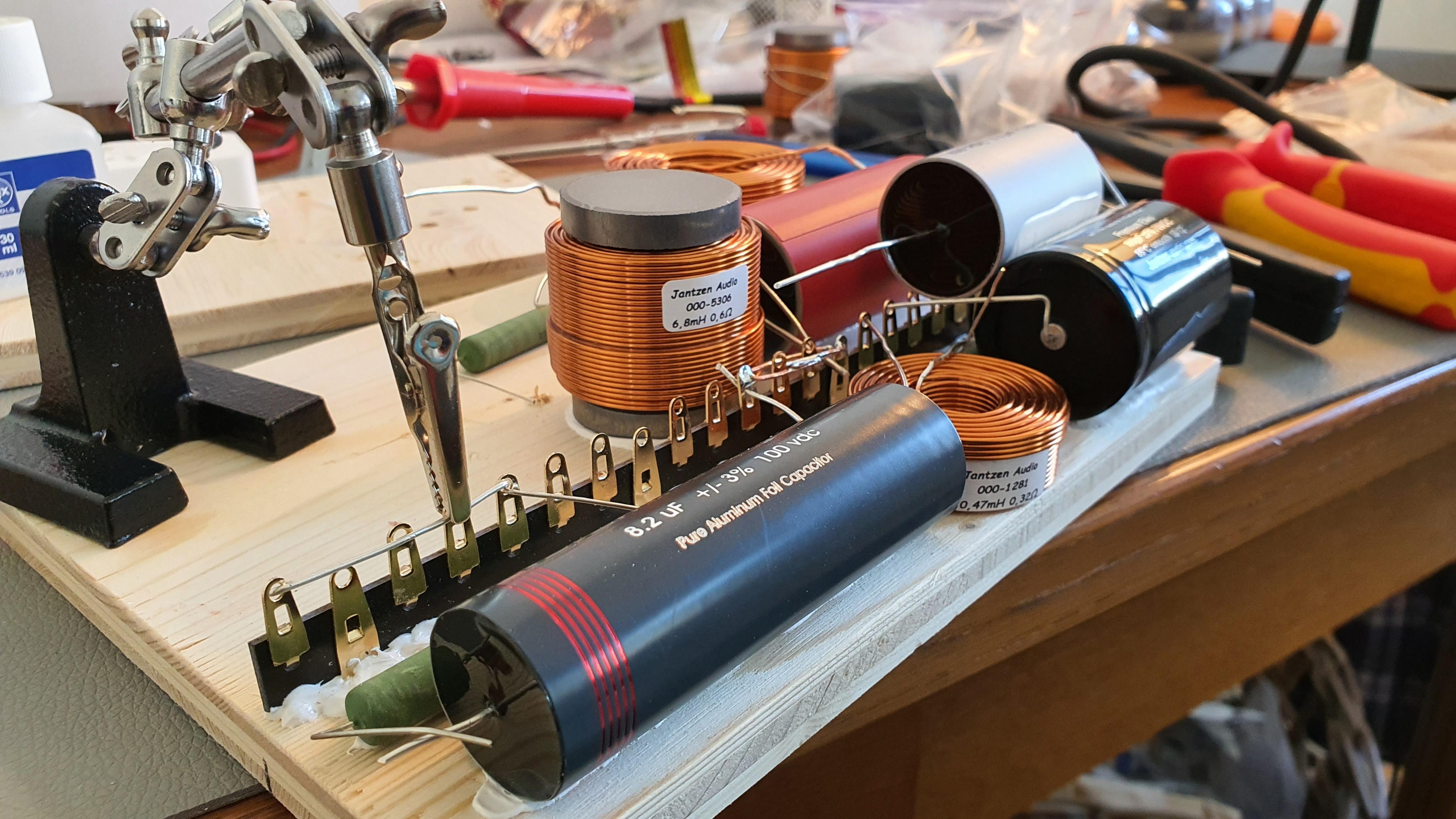

I worked on my xover today, exactly as Troels was describing them on his website. Soldering this week.

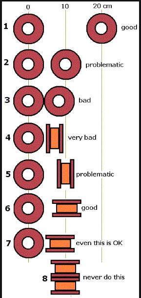

You might want to reconsider how you arranged the coils. They should be perpendicular to each other to reduce crosstalk.
Thank you, it is exactly following Troel's description though, what should be changed? Could it stay on the same layout/plate? Thank you.
edit: pic from Troel's website
You can do better than Troels' photos.
Yes: put 'em outside!
You can do better than Troels' photos. As I wrote before, make sure the coils are perpendicular to each other.

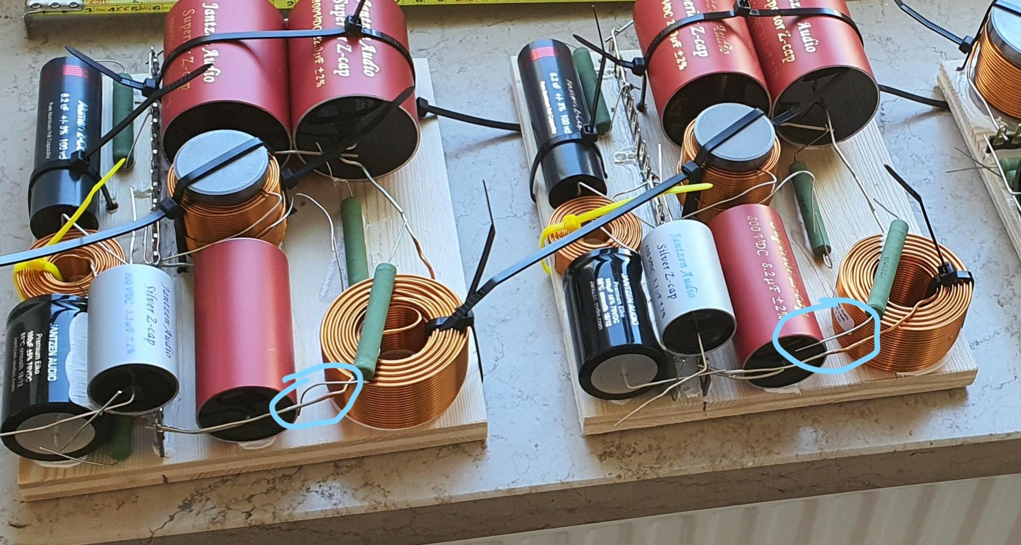

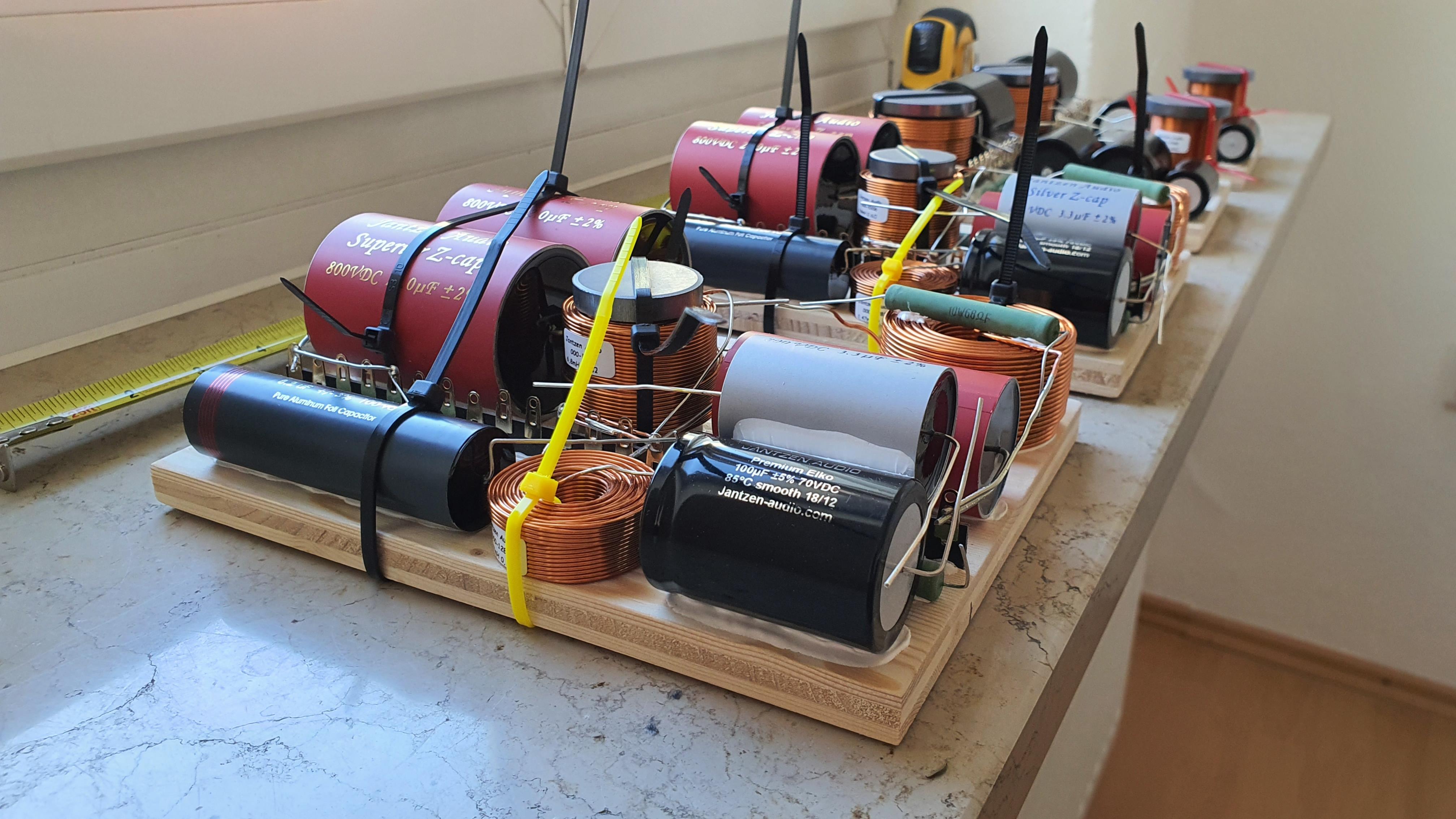

Edit: So should I move this (red) coils to the outside like showed on the pic?
IMO leave that coil where it is. Troels had no problem with it in that position.
However if you want you can turn the small coil, on the left, in an upright position. Then it will be 90 degrees to the coil in the middle. You need to glue/ cable tie it so it does not fall over.
In a different photo I saw a resistor cable tied to a cap. Hopefully that resistors does not get hot. I would not do that.
Generally people use larger wattage resistors or resistors in parallel when using big amps. This speaker is efficient so perhaps big wattage amps will not be used. Just my two cents.
Do you mean this marked cables?

capacitors
I meant the resistor of course.
