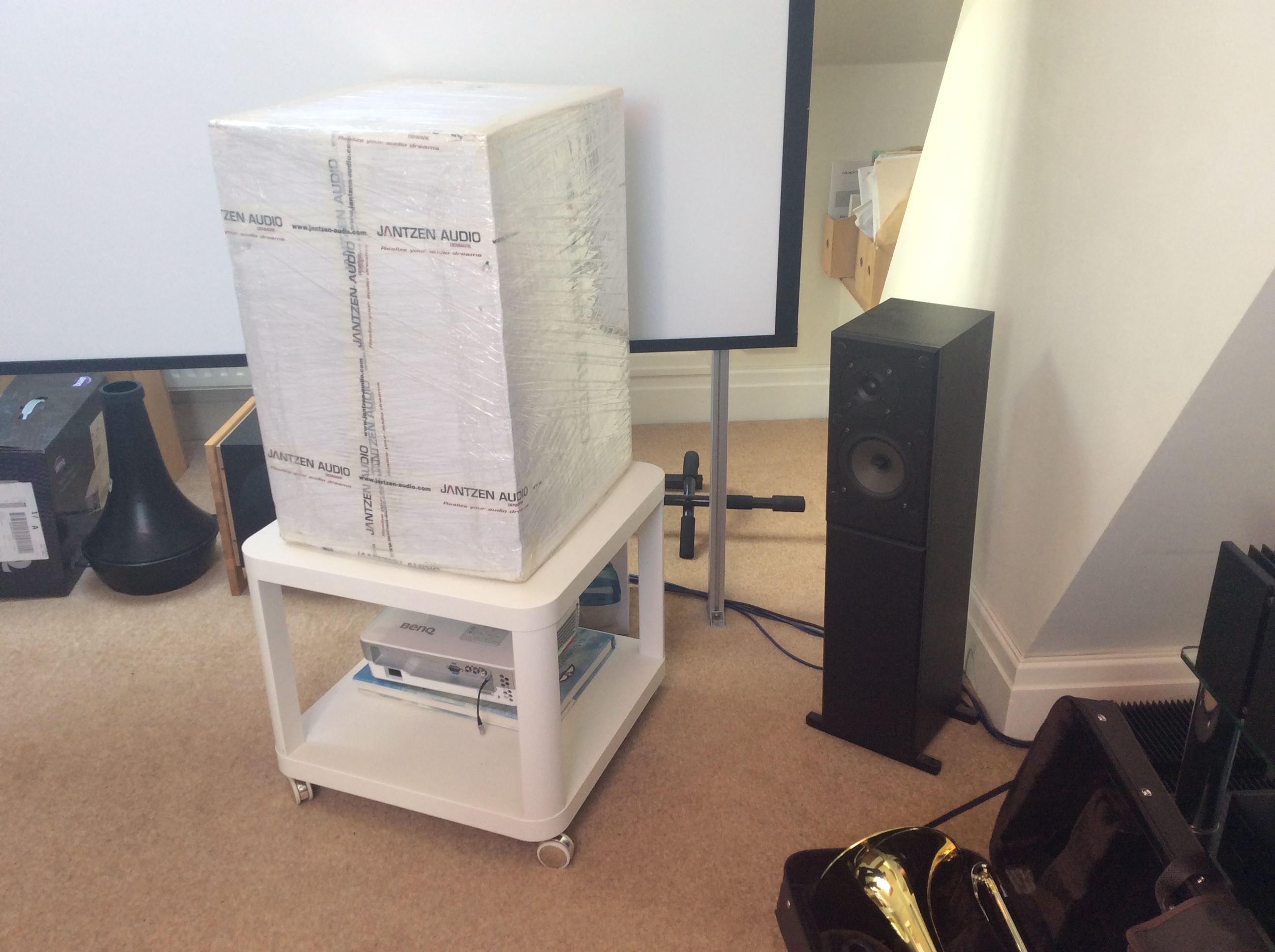

Faital 3WC kit box just arrived from Jantzen Audio. Oddly enough, the kit box is only 2cm over the 3WC width and depth, and 8cm less in height. So it gives quite a good idea of the size of this speaker. You can see that it dwarfs the Rega EL8 floorstander next to it. Yikes!
Yeah, those cardbox comparisons can be misleading, because the cardboard looks ugly. Just make a nice looking box and you will love it.
