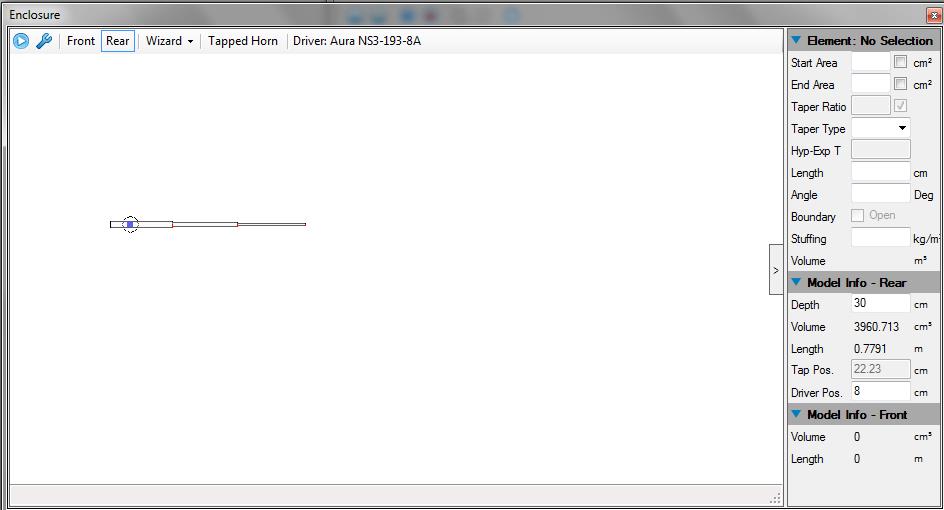

Hi schmeet,
I've just started using your software. So far seems great and pretty intuitive.
I have one question however. Sorry if this has been discussed somewhere else.
I'm trying to model the small folded TL in the first image and I assume I can just do that by having three elements one after the other as shown in the second image.

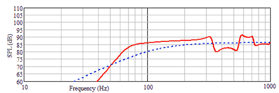

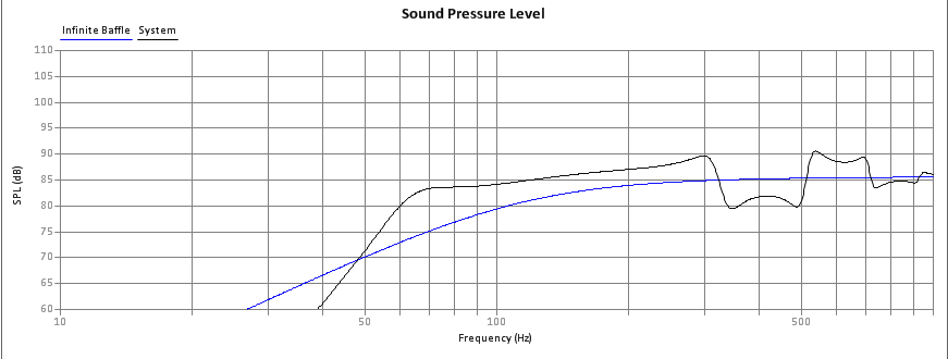

The simulation I get however is not quite the same as that by the tl's designer. The one parameter I'm not sure about in your tool is the model info- Rear ->depth for each element. Do I need to adjust this at all and if so what does it measure?

Russ, it looks like you are doing it right to me. Perhaps you could attach the model file and I can have a look in detail.
The depth parameter doesn't really do much other than changing the view. Because the view is 2D I need to assume so 'depth' when drawing the elements.

Russ,
I don't see anything immediately obvious with the design. I would say that it is usually better to model the center line of the folded enclosure which gives a slightly longer and slightly more volume, though it doesn't make too much difference.
Do you have a measured/modelled frequency that you think it should be getting?

Ok, so I had originally modelled it down the centreline (in the attached model) using the attached driver.
I'm trying to broadly replicate the response shown for the lance in this post:
http://www.diyaudio.com/forums/full-range/247904-woden-design-3-box-designs-2.html#post3753912
so I can then play around with different drivers and different line lengths etc.

I'd suggest getting planet10 (Dave) involved. On fullranges he's a master and knows specifically what changes /mods should be done.
Will have a peek and your model shortly. As Pete said nothing obvious wrong with what you have. Experimentation is easy peasy, but would suggest a removeable front baffle when doing so.

Ok, thanks schmeet. That looks pretty good!
I guess being a newbie to this I wasn't confident I was doing it right and the depth parameter threw me a bit.
