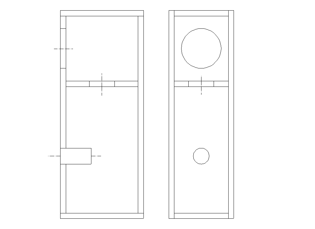

This is a double chamber reflex, modelled after a real speaker that was constructed and tested, and gave substantially what this simulator predicts. Posting just to make sure I'm correctly simulating the box as in the picture
View attachment file tlp.zip

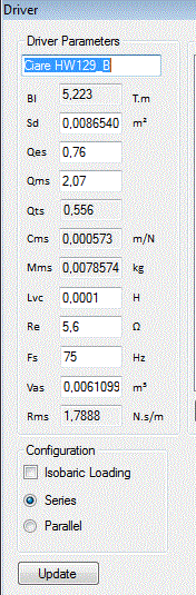

if i want to simulate two of them in series in a TL
IME driver position is important in a tuned pipe of any sort. How do you model for optimum driver Z with two drivers? Find Z for the theoretical twin driver, then, when moving into the physical realm of the build, mount the drivers straddling Z? What about tapered TL bipoles? Model once for the front driver, then for the rear mounted driver then combine the response graphs?

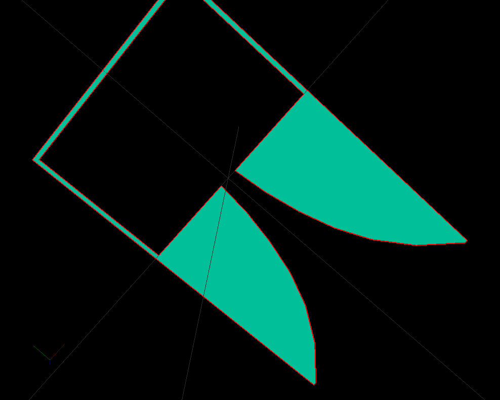

modelling a given shape.
Hi forum,
I just started to use the TL software by Leonard a few days ago, and it is brilliant! Thanks a lot for the effort 🙂
So, a question. Is it possible to model a backloaded horn with the shape of the attached figure using the software? I got the drawing from the manufacturer, and would love to compare their design with my own, more conventional TLs, before committing my self to wood 🙂
Thanks a lot 🙂

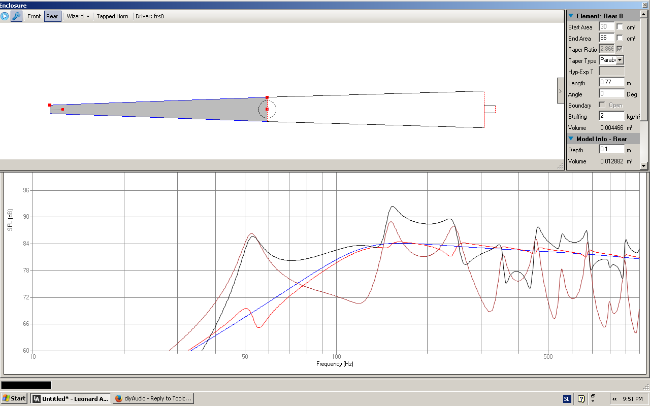

Hi guys,
I started to play with this software today, and must say I find it pretty simple... Anyway I would like to check with you if I got it right or at least partially right.
As an exercise, I tried to model the popular "needle" enclosure design with Visaton FRS 8. Since there are no folding examples in the tutorial, I played with it anyway, and this is what I ended up with...
The plan I used to make the model:
And the plot I get is in the attachment.
Although it goes pretty low, it looks kind of "choppy"...
Is this model okay and representative, or can anyone tell me what I did wrong?

My plot looks a lot like yours and other people's, maybe just a bit different because I did it for the Visaton drivers.
I, too, hear that needles sound notthing short of fantastic, and that's why the choppy plot looks so puzzling... I guess I'll just have to make these needles and hear for my self.
I'm still not sure about the proper way to "make the turns" when creating a model. When calculating the line length, one should draw the center line (in the corners also) and then measure it, but I'm not totally sure how to model the damn thing.
