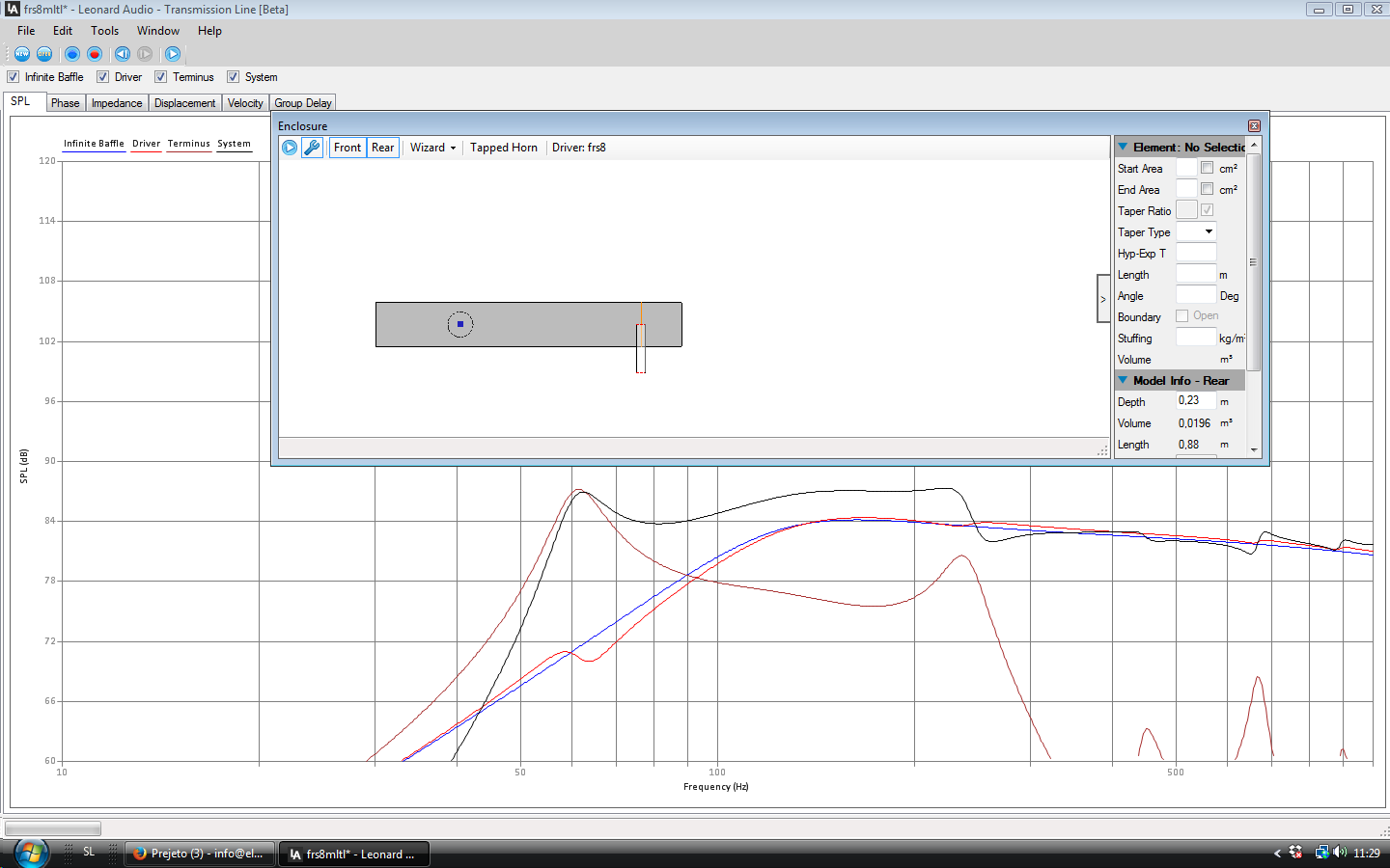

HELP - LEONARD AUDIO SOFTWARE
I am trying to use Leonard Audio to create an ML-TQWT enclosure for an 8inch full range driver, but after i've put in the driver and amplifier parameters, I'm struggling to get to grips with the enclosure building process. Are there any examples? or other help files other than the one given.

bug?
Hi, want to report a possible program misbehaviour.
I was trying to model a box for the Beyma 8AG-N, so I create an expanding tube, set boundary -closed-, then "split element", then "create branch", set branch "boundary -open-", and set area and lenght to define it as the vent.
Till this point, everything was OK, I was able to drag the driver, and the vent (ie the split line partition) back and forth, in order to find the best relative position along the enclosure main axis. But after a modification of the enclosure start area, the possibility to drag the vent was gone, It wasn't possible to move it along anymore. Any one else experienced this problem? (see the troubled sim in the attachment)
Ran your model and the driver position moves. Hard design to deal with as it is with expanding lines. For giggles ran a couple mods, didn't like the results. Driver specs.... Hmmm Beyma doesn't list the specs. Fullrange, 96dB effeciency 35w handling. You have the driver specs as

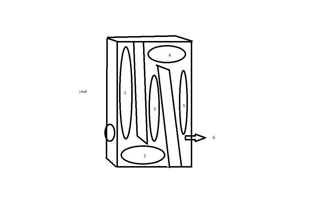

Folds
I recently started playing with the Leonard audio software. The ability to store driver TS parameters and easily plug them into a particular box is nice. I am still not sure how to do folds though. Suppose I had a box with a tapering line created by two internal baffles, the first of which starts at the top of the box and the second which starts at the bottom of the box. How do I divide it into areas or "elements"?
Can I do three areas: the area top to bottom in front of the first internal baffle, the area top to bottom between the first and second internal baffle, and the area top to bottom between the second baffle and the back of the cabinet?
Or do I need 5 or six areas: 1. The area from the top to the bottom of the first baffle, 2. the area from the front of the cabinet to the front of the second baffle with a height the distance from the bottom of the first baffle to the floor of the cabinet, 3. the area from the bottom of the first baffle to the top of the second baffle, 4. the area from the back of the first baffle to the back of the cabinet with a height the distance from the top of the cabinet to the top of the second baffle, 5. the area from the top of the second baffle to the bottom of the cabinet, and 6. the 3/4 inch or so area that exits the cabinet?
Also, I am not sure what to do with the ability to move elements to an angle.
