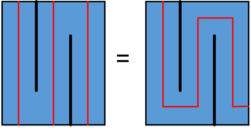

Both ways will do. As long as you do not change dimensions an path length, you can segment the first proposed design in any way you want. I've just simulated default driver in both ways (3 and 5 segments) by changing angles of segments by 90 degres to each other, as well as stright, and there is no diference.
If you look at the paths of the segments, it stays the same no matter how you fold it.
