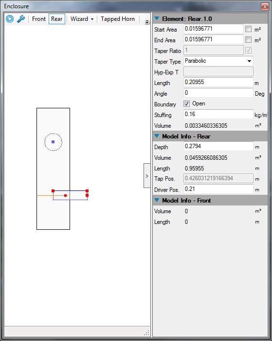

Thanks for your reply and help. Not sure what I was doing wrong with respect to entering dimensions. this program is a little different from bassbox pro. port is round 3 inches in diameter.
Can you reproduce the simulation I posted or do you still have a problem with entering dimensions?
Robert
This is what I originally had. I had same start and end area as yours but in sq.m as per defaults of program. But doing something else incorrectly with respect to dimensions which i based on the Length, Width, Depth, of enclosure and Width Depth of port. Round Port is 209.6 mm in Length and Width is 76.2 mm. I multiplied these together for start and end area of port? Not sure if i need to add dimensions for the front option in this program. maybe that is the reason? (port depth should say 0.20955 not 0.2794)

I assume you mean diameter of the port when you say width is 76.2mm. The start and end areas of the port are the areas of the circular opening. I calculate 45.6cm^2
The front option is used when there is some sort of loading on the front of the speaker. Not relevant in your case.
You can toggle any of the units by clicking on the unit symbol.

Yes, 3 inch diameter of port. Did change to your calculation but in sq.m. Port length is correct as is. Ignore my correction comment about depth change as that applies to the enclosure and is ok as is i believe. I still get the same mountain response. So what is causing this? something not entered correctly?
I tried inputting your port dimensions but I cant reproduce your response. Perhaps you have entered the speaker parameters incorrectly. Can you post the driver window showing the values you entered.

If you go up to the third post down from top of this page I have 2 Untitled attachments in my post. the driver parameters are in the first one. Also i have tried to change the area settings to cm2 in settings. does not change from m2. I have clicked apply and all update buttons. tried inches as well won't change. I noticed that sometimes I am getting a fatal error message for this program which says to continue or close. even uninstalled and reinstalled but seems to happen sometimes. not sure if that is to do with entering something incorrectly. This happened couple times when first opening the program after reinstalling would get faital error continue or close, it would freeze after clicking continue.
Hi
I checked the driver parameters you entered. The problem is the inductance which is 1000 times too large. The value should be 0.017mH. This explains the roll off with increased frequency.
Easy to make an error here. I discovered I had the wrong value for Qms entered.
To change the units of any parameter place the cursor over the unit next to the data boxes in the driver and enclosure windows. Clicking on the unit will toggle between units.
Robert
