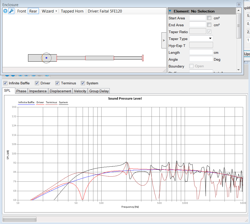

Stuffing, Lining Damping confusion (that's me..)
Hello Schmeet,
First of all, THANK YOU for this tools. REALLY impressive, I'm now capable of designing a base model.
I was looking from a distance for years at transmission lines and somehow never got to designing one. UNTILL your tool came along. I've been reading about this creature (TL that is) and understand at least the basic parts of it. So, started designing and ON PAPER, it looks promising. 😀
If I talk ********, feel free to correct 🙁
QUESTION:
There seems to be a general consensus about the "magic" part of the TL, being stuffing / lining the TL with damping material and that's the point I seem to get lost. In your tool there is a damping parameter, which holds some default values, from light to heavy damping. I do NOT understand how these number (specified in Kg/m3) relate to the values I find on some damping material.
Heavy (at least the highest value I found sofar in the market) is 30 Kg/m3. Than its lesser heavy version is 20 Kg/m3 and 1 Kg/m3. The lowest I found sofar is 0,8 Kg/m3.
NOW when I use the default values in LA, there is some damping effect visible. But when I use the market values, say 20 Kg/m3, I see REAL effect.
What I do to notice the effect, is split the line in a number of sections, at least a Closed beginning, the offset area for the driver, a mid section and the section at the open end of the line. Then add stuffing to one or more of these sections. Each section has its own effect, which makes complete sense regarding the ¼ wave principle of the line, its open and closed end and the driver offset.
Adding 20 Kg/m3 at the first closed section shows a decrease in SPL in the low end AND a nice roll-off from 100 Hz to the tuning frequency of the line of around 6 dB. It almost matches the infinite baffle line of the driver.
This is supporting a number of articles stating that a good designed TL show this kind of roll-off.
ALSO, adding 10 to 20 KG/m3 at the OPEN end of the line section shows a nice smooth mid-upper frequency range behaviour, removing all the resonant ripples.
THIS makes me wonder, WHAT are your default values and how do they translate in market Kg/m3? Am I using the correct values or not, IF not please clarify😕
I've added a design picture. It is a small 5 inch Faital Pro driver TL with 4 segments. Kind of the PMC DB1.
First picture is 1 Kg stuffing
Second is 20 Kg stuffing the first segment (half of it to the offset point of the driver) AND complete last segment at the terminus.

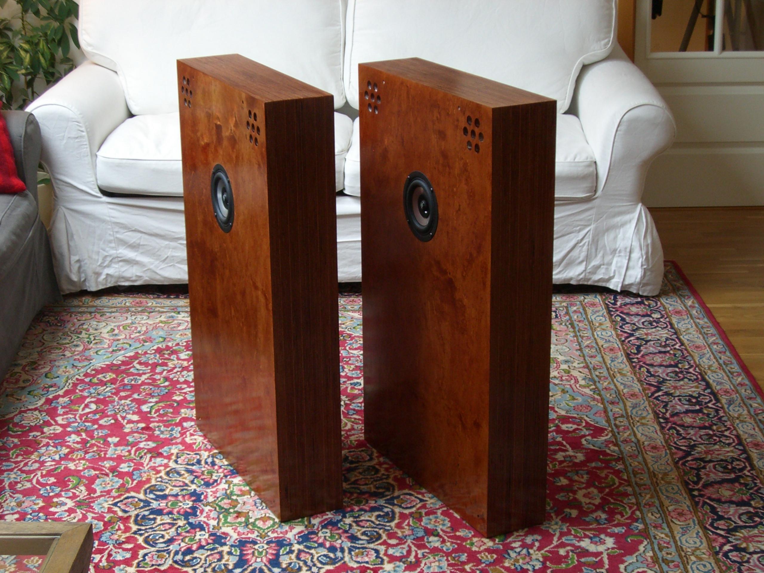

Hi Wae,
I'm no expert, but I found your question interesting so I decided to chime into the discussion anyway.
The way I understand the damping parameter it is simply just a measure of weight per cubic meter.
Say you have a design with an inner volume of 0.1 m3 and the simulation looks good at 3Kg/m3 damping, then you use 3Kg/m3 times 0.1 m3 equals 0.3 Kg damping material. The density of the material itself doesn't matter, you just weight it up. At least that is the way I understand it.
I used this method for my Jordan Eikona 2 design (picture attached), and it works well
Good luck!

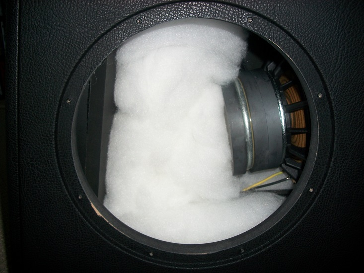

20kg or 30kgs per cubic meter seems extremely dense to me. The box stuffing I have here is light similar to cotton wool, and even a big handful of it doesn't seem that heavy, so I would urge caution on going for anything monster weight. Just because you car will perform ok with 2" taller tyres, doesn't mean it will be happy with tractor tyres on it. There could very well be a point where you start over dampening the sound and stop anything coming out. From what I understand the padding it to act like a shock absorber for the box. Think about a sheet of steel, if you hit it with a piece of wood, it would ring, but put a thin coat of rubber paint on that steel and the ring would be greatly dampened, put a rubber gymnasium floor mat over the steel and hit it with wood and you may not even get a sound out of the steel. The padding also aids to slow the sound wave down slightly but get too carried away and it could potentially stop it.

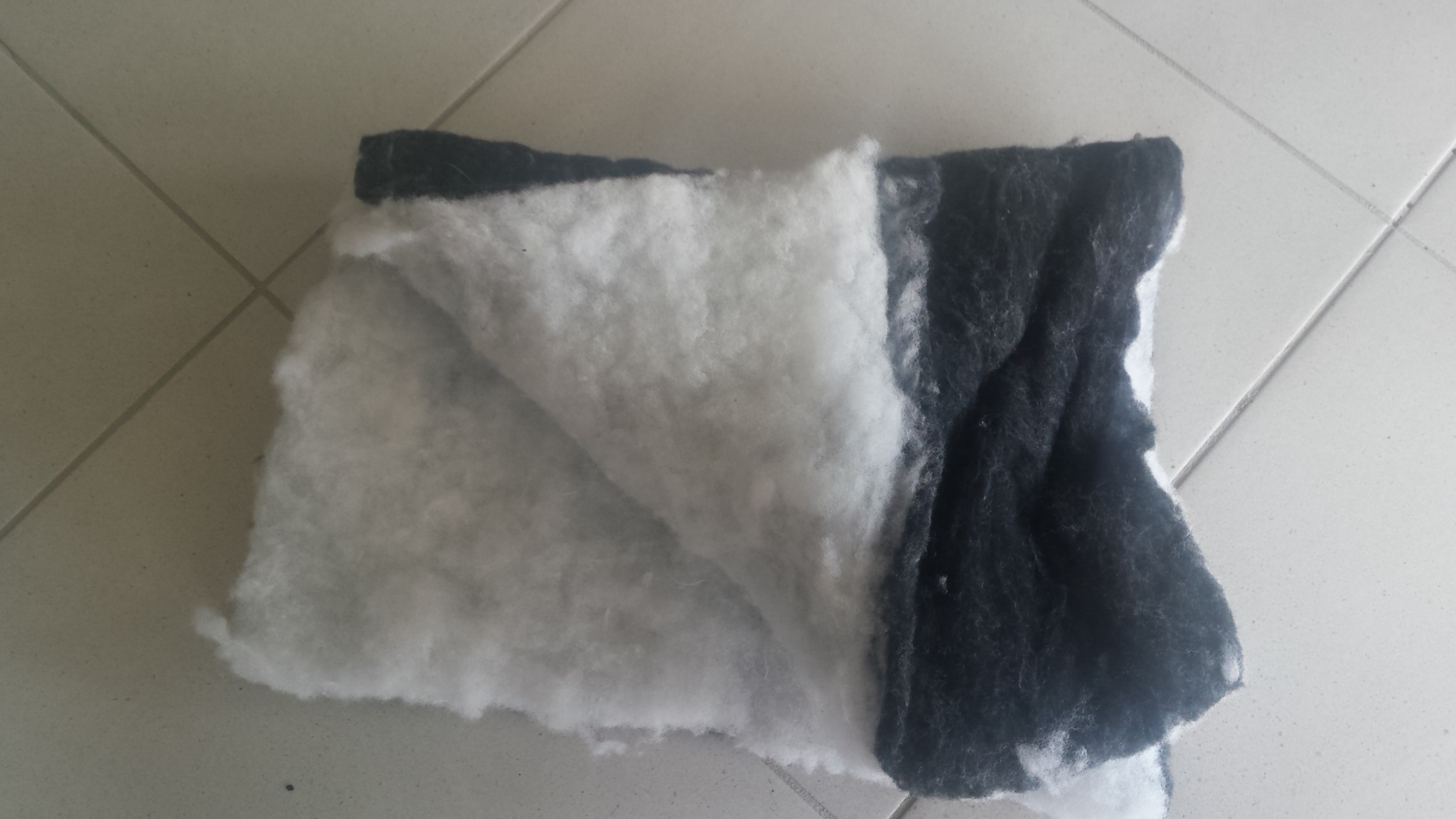

I'm not using the software in question, but I can probably shed some light on some of your questions. Firstly a couple of pieces of dampening are not going to weigh all that much, and that could very easily be quite deceptive. Remember the weight of a single piece that is 1000mm long by 1000mm deep and 1000mm high is only going to weigh 20kgs, so if you only have a few pieces think how much of a small percentage that is of a cubic meter (1000mm x 1000mm x 1000mm) and then times that percentage by 20kg and you will find the pieces you have aren't meant to be that heavy. The problem with dealing with something as light as cotton wool is that it is hard to gauge the weight of it properly. If I was to try and guess how much a cubic meter of the stuff I had was I would say maybe less than 5kgs.
You will find some stuffing / wadding / dampening (has many names) varies a bit, the stuff I have is black on one side that is slightly more dense for gluing to the cabinet, and the inside is white. Have a look at the photo I have attached (for reference the floor tiles are 450mm x 450mm) this piece which is folded a couple of times might weigh 100 grams.
The other thing I have learned with modelling software is you need to respect the parameters... For example you can have a single driver that works well in a .3 cubic meter box, but you keep trying to make the box bigger and bigger until you get the box looking better on paper, but you are now at 20 cubic meters, there comes a point where practicality gets in the road of modelling.
Think about what the padding is going to do to the sound. A box with padding has to sound different to a box without it, it would be an impossibility for it not to. You want enough padding to get rid of any unwanted characteristics like the steel example I gave, but you don't want so much that it alters the sound of the driver.
From what I have previously seen in modelling software, the padding reduces the size of the box and the more you use, the easier it would be to drift from the original design because a large portion of the time that is spent on the modelling software is geared towards making the box model like it is supposed to. The padding is an added extra and from a coding perspective will simply be a variable parameter that may very easily get further and further wrong as more is used.
Now how the stuffing works. In free air sound has very precise measurements i.e. 20Hz = x precise meter wave length, 30Hz = y precise meter wave length, but adding stuffing means there is a physical item now in that free air path and any time sound comes into contact with an object it is absorbed, think empty tile room verses a carpeted room with furniture. Same room size (can even be the same room) but very different sound because the carpet and furniture is absorbing sound waves and slowing them down.
Inside your cabinet is no different. So you don't want to be relying too heavily on the stuffing to get the right curve, you need to have the right box to do that, and just use a small amount to control any nasty reflections inside the box that are going to harm the overall sound. I hope this makes sense.
Yes some places do need different quantities but this just adds to the complexity of modelling the cabinet properly. I would advise against trying to dampen any cabinet to the point it looks smooth because you can bet it will severely dampen the sound that comes out. Unfortunately the padding will alter the size of the box needed, and you do need to make some consideration because of that, and you cant just add more or less like you can your coffee, but I would stay on the conservative side.

To add some context to the subject of stuffing I have actually owned speakers on the two extremes of this subject.
The first was a sealed subwoofer with two passive radiators that was absolutely packed full of padding, to the point where it was nearly touching the driver. Since the box was sealed with no sound flow outside the box (through a port) this was not a major consideration how all this padding would affect the sound, and it actually helped to make the box work like it was a much bigger box without changing the physical size. In this instance where you are trying to control all the sound trapped inside the box padding is your friend.
The other example was another set of Sonus Faber speakers that were full range ported floor standing speakers, and the padding in those was very minimal, for the reasons I mentioned earlier.

Hi Silent Screamer,
Your replies have been very helpful in more than one way. I was so focused on trying to tame the reflections, that it never even crossed my mind that this is just ONE aspect of damping. How it all sounds can most likely never be simulated or seen by a graph.
Other parts of your replies made me think a little different. Since the modelling software can "split up" the line in as many parts as you like, may be a better approach is to start with the barely minimal stuffing as a start. Design a TL as 1 line without any bends, split it in segments of say 20 cm over the complete line, a section at the driver location and a section at the terminus to be able to choose on each section to apply damping AND how much.
I found that stuffing placed e.g. at the beginning (closed end) of the line controls the lower (under 100 Hz roughly) of the TL. The usual big dip in the 100 - 200 Hz area can be tamed by driver offset, so no damping required here. The ripples in the "higher regions are (as far as I understand from reading) the result of standing waves / resonance. Since the SPL graph shows dips and bumps at frequencies that are visible IN the graph, it is easy to find the first order spot in the TL (¼ wavelength of the resonance freq.). A bump can be tamed by putting some damping at that spot in the line, if it is a serious bump.
The damping at the last say 1/5 part of the line near the terminus also dampens the ripples. This wil result in just a few spots with damping material. Question is still of course, which type of material and how much, but that I could experiment with by making one side of the TL removable to add or remove stuffing and listen to the effect.
By having all the sections of the TL, I could choose where to apply for What reason.
OOHH by the way, as of your question, the parameter I set to 1 is labeled Kg / m3 so weight of the stuffing / type of stuffing specified by weight (density?). The code should hold formulas of the effect of damping to that area, which is basically my questions, WHAT do you code here. The amount of stuffing, the density of the stuffing or.... If it is density, then 20 x 20 cm (0,2 * 0,2 meters) of damping material with a density of 20 Kg / m3 I currently have (it's 0,04 meters thick) weighs slightly more than nothing, 3,2 gram to be precise (0,2 * 0,2 * 0,04 * 20). Filling the complete line of 2 meters with 20 Kg / m3 for a line 20 wide would result in 32 gram of damping (10x the 20 x 20 cm amount). That's not really the whole world. 😛
Since you need to specify the width of the line as a contant and depth and length of the density this may well be the case here, So that parameter would be type of damping material by density. I hope I get an answer from SMEETH as the programmer of this tool. Maybe you could have a peek at it, it free (donations are appreciated).😉

I quick installed the program to have a look at it, since it is years since I last looked.
And yes it specifies the weight of the stuffing in kg/m3, and the amount used in m3, but weight and density are not necessarily the same thing.
I have looked at several pieces of modelling software and I have found that the stuffing parameter can have from a minimal affect to a huge affect depending on what the programmer coded.
The problem is there is no such thing as a standard stuffing and what you use can make a difference even if it is modelled perfectly.
Let me explain, we both have hair on our heads (or at least I do and I assume you do) I have very fine hair whereas you might have very course hair, therefore my hair might weigh half as much as yours (or less) but I might have twice as much, meaning that our hair has the same weight, but because I have more hairs on my head I am probably less likely to get a sunburned head.
Stuffing can be the same, remember our ears work by picking up vibrations on tiny hairs in our ears, what is to say if the stuffing that is super fine, might act differently to stuffing that is course, even if it has the same weight per cubic meter?
It is for this reason I would aim to design the box with the absolute minimum stuffing so any variation has a minimal affect on the final response. When it has all been said and done and measurements taken you might still want to have a play with different quantities simply to see if you prefer the sound.

I think LA tells you the internal volume based on your design, it is not necessary to calculate it manually. Once again, based on the damping material density in your simulation, just multiply with the volume LA tells you about your design, and, presto, you know how much material you need. Now you can measure with a scale.
In my experience, 1-3 kg M3 is about right. I agree with some of the other people here, 20 Kg/M3 sounds way too much. One of the benefits of a TL is that it offers a deeper bass (albeit with a steeper rolloff) compared to infinite baffle. For me, this is exactly the reason I love a well designed TL; it plays in a relaxed, resonant free manner. Super sexy 🙂

Question regarding TL software and driver offset.
In an MLTL.... example: Tabaq - parallel pipe with smaller port at the end.
To achieve suppression of the 3rd harmonic, the software indicates that the driver has to be further along the pipe (relatively) than with a simple open ended parallel pipe.
However, the software indicates that suppression of the 5th harmonic occurs exactly at 1/4 of the main pipe length.
I can't reconcile the two cases. Comments on the forums seem to indicate that the 3rd harmonic needs to be further down the pipe in the MLTL case. If that's accurate, then surely the 5th also moves?
J.
