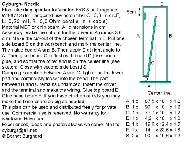

i recreated the Cyborg needle with the W3-871S
i used the sizes as given by the instruction. for easy working i did not fold the line, total line length 184 cm

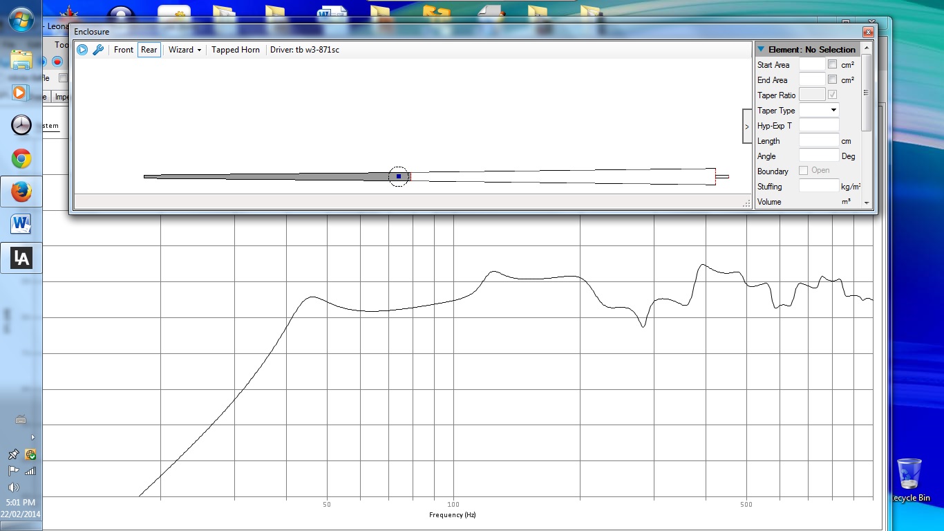

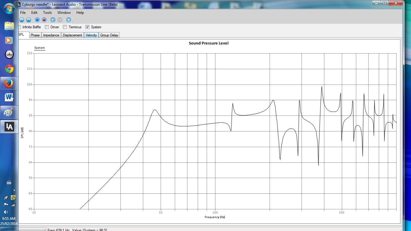

I am trying to learn the use of this software so I checked the model for Cyburgs Needle as practice. I am not an expert so someone with more knowledge may correct what I say
The main difference from my model to yours is the way you have treated the exit of the line . The exit port in yours does not appear at the end of the line.
I have attached a screen grab of my enclosure and the frequency response it gives.
The density of stuffing is not given in the design so I chose the maximum possible density

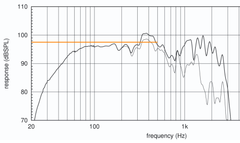

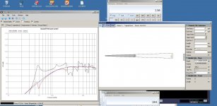

Hi, i do understand about the vendors SPL specs, & realise that they don't always test with the same bandwith etc, & why 😀 This was "supposed" to have been sorted out years ago, starting @ 50Hz instead of 100Hz. But some still don't do that.
Even so i find it "can" be an ok starting point, as in my screenie. This is a well known respected brand & an expensive 21" driver. Quoted as 97.5dB, 100Hz - 500Hz
Sometimes we need our designs to be Bass/Mid, rather than actual SUB's. So seeing that data is helpful anyway.

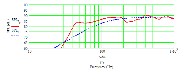

i think ur line is way longer as well. it loking better but still kinda crap compared to the sims i see from people using mathcad sheets from King. what i wonder is whos right and whos wrong. i mean if this raggged look would eb real life, i think its not even usable for a 2 way, maybe only a 3 or even 4 way. i mean above 100hertz the graph looks like bad already 🙁

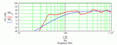

I checked my model. The length is almost the same as yours but your area at the wide end is 181cm^2 and mine is 154cm^2.

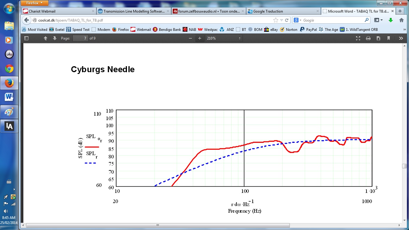

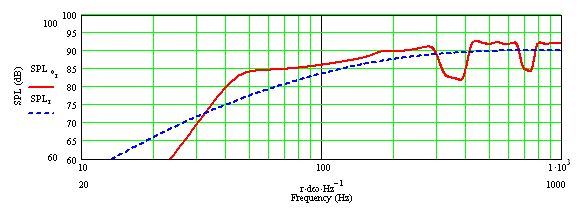

I found a MJ King mathcad simulation on another forum . It is much smoother but it has big dips between 300-400Hz and 700-800Hz.
I am not sure why the two programs give different results
WRT accuracy, Bob Brines and others have posted comparisons to show that MJK's software does quite well. Ditto Augspurger's and AkAbak.
FWIW, here's the sim I did of the TB W3-871S Needles with 0.5 lbs/ft^3 stuffing density from the closed end up to the driver back when it was first posted on DIYaudio. Considering how far below Fs it's tuned, +/- 3dB all the way down to ~45 Hz is quite good.

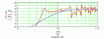

whats that HUGE peak way to much lows and allot of crap in the midrange
Undamped, a resonant pipe is mostly just a mass of peaks, nulls and a mass loaded one [vented] is even worse since the vent has its own resonant structure to complicate it.
Anyway, mine undamped has a similar resonant structure except its phasing is quite a bit different, though no clue why it would be, but lacking any more info I'm going to assume that MJK's is the more correct of the two.
