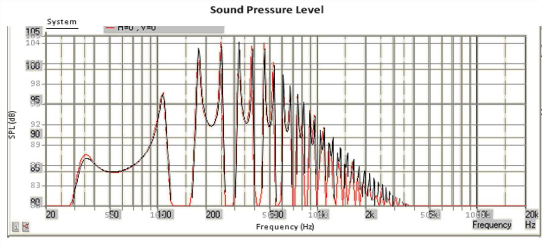

Since no one else seems interested in commenting on the comparison I just did I'll comment on it myself.
It looks like the TL.app results compare very favorable with all the other programs. Accuracy does not appear to be an issue here.
I'm still going to do a couple of other comparisons, maybe a complex front loaded horn and a simple tl with a branch but I'm not sure when I'll have time to do them. And based on the results of the first comparison I'm expecting similar (accurate) results.
I'm not going to bother doing a tapped horn comparison until the tapped horn feature is fixed.

Thanks for doing those comparisons J-a-G.
I'm glad there aren't many differences, I'll look into it in a bit more detail next year. I have made a slight improvement to the radiation impedance model but the effect is very small.
Differences will likely come up with more complex designs but its always good to know that the starting point (I.e. a simple TL) is modelling in an accurate way.
