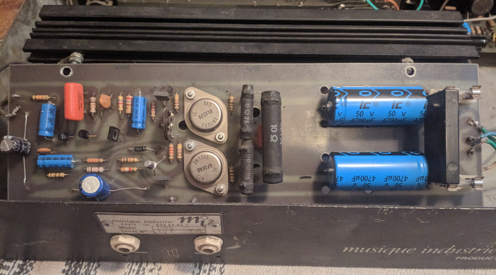

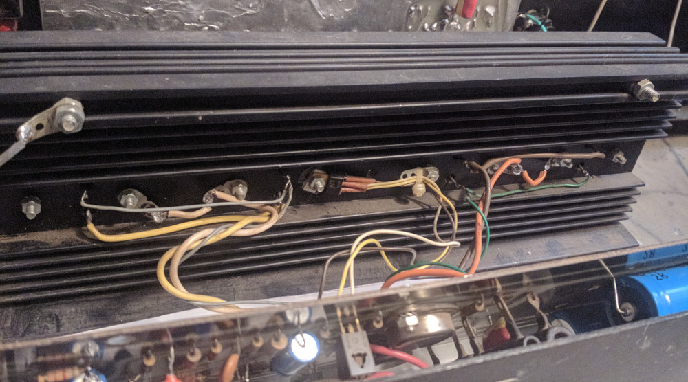

Here are the pictures!
i do have a scope and a generator but my scope is out of order - waiting for a new optocoupler !
All transistors have been unsoldered and checked on my cheap but effective chineese transistor tester...
the circuit uses only 2 diodes : one tiny black one with funny marking (SSC PLZ? can't find anthing related) and a BC109 used as a zener...

This Musique Industry 1945? is a bit odd with 2n3055 drivers? on board and 4 output transistors on the heat sink. Maybe the configuration is as Mr Fahey posted, the acoustic control 361, with the 2n3055 on pcb as drivers. But your predrivers are TO202 packages instead of TO5 40409/40410.
Somebody that ran sims on the ST120 with models of 2n3055, found that Harmonic Distortion was lower with TIP3055 which is a 4 mhz Ft part instead of 800 khz. I had no surviving 40411 so my ST120 runs with NTE60 copies of MJ15003, and is not high frequency limited with the 40409/40410 drivers. You may wish to replace your output transistors and drivers with something faster for better sound. MJ15015, MJ15003, or even MJ21194. If you do that, those can oscillate. The cure is putting a 10 ohm >=1 watt resistor in the base line from driver to output transistor. I put mine in the wire from the pcb to the transistors on the heat sink, flying out in the air. Did it to provide something to burn up instead of expensive drivers etc, but I've had no oscillation problems. Mooly had oscillation problems on his old 2n3055 amp with faster OT's and put the 10 ohm resistors in specifically to stop the oscillation.

so maybe i have bad transistors that still pass the test... i think i'm gonna give up !
ok, one last try...
power section : (4 2N3055 push pull )
now i have 20mV on one 0.25R, and 10mv on the other.
If i'm correct that's 80mA for one pair of 2N3055 (40ma each)
and 40mA for the other pair (20mA each)
Seems like a bad balance ? how much should i target ?
and for the driver section : 2x2N3055
0,6v on one 100R that's 6mA
0,9v on the other 100R that's 10mA

Out transistor idle current, okay. 80 ma is not dangerous if you have good sized heat sinks.power section : (4 2N3055 push pull )
The drivers, something is probably wrong in the preceding section or sections. Go looking up there for source of unbalance in drivers. 6 & 10 ma are not dangerous, but your VAS should balance out to the middle. May be a pot wiper, or even need a balance pot. No schematic, we're guessing.
As I said for 2n3055 On semi MJ15015 from an authorized distributor is your friend. Not using farnell, RS, mouser, digikey reichert? Even using those, did the parts go through customs where fleet fingers may substitute trash for real parts? Test every transistor for Vce breakdown current as detailed previously. At least at 12 v. UPS here is reliable since they have cameras everywhere & track everybody's every minute. Wasn't true in the early 80's.
is it ok to have 80mA on one power side and 40mA on the other?Out transistor idle current, okay. 80 ma is not dangerous if you have good sized heat sinks.

That is a very primitive amp. Apex AX6 would be better if you feel like making boards.
Which side output transistors, the plus side or the minus side have the 80 ma bias current? Since you got rid of the MPSU06 that might blow up with more current, you can inject some current in the Q3 Q5 R13 predriver input stack to move it one side or the other. If the negative side R19 has hotter idle current than R18 plus side, I'd put 270 ohm 1/2 W series a 5 k pot parallel R19 and pull the whole stack up a little.
You may want to put a heat sink on the MJE340 Q4. 1.5 cm of scrap window frame with holes drilled in it works fine, if you can't buy one without a E8 UPS fee. If you live in Ilse-de-france you may have a local distributor that would cost only a Metro ride. Don't forget a 3 mm or 4 mm screw & nut to hold it on, and heat sink compound is useful if you don't have to pay E10 for it. this position, VAS is not usually heat sinked, but people that fix amps find VAS & drivers blown up a lot.
Connect the new pot wiper to one end. Adjust the RV1 to lower currents to 5 ma & 10 ma then adjust new pot to center it. If RV1 won't lower the idle current that much then short the wiper to one end, and or decrease R6 and or R7 a little bit. You can parallel a resistor like 10k or 4.7k to R6 or R7 instead of pulling them out of the board to lower the value. (true of any resistor that needs value lowered).
Don't forget to replace each wire from driver pair to output transistor bases with a 10 ohm 1 watt or higher resistor. This "base stopper" is what mooly recommends for old amps that have slow homotaxial 2n3055 replaced by modern parts that are 8 times faster. Else the outputs might oscillate. I put a 8 turn coil in the wire running from heat sense transistor Q3 back to the base of driver Q6 Q7 for the same reason. Salvaged the coil out of a dead PCAT power supply, but I think it may be about a microhenry.
another try with my audio probe... good signal injected at F and B
sound is ok at base of Q1
sound is already badly distorted at base of Q2 !!!
and probing the 2 2N3055 drivers : there's a big difference in volume + sound is really bad
