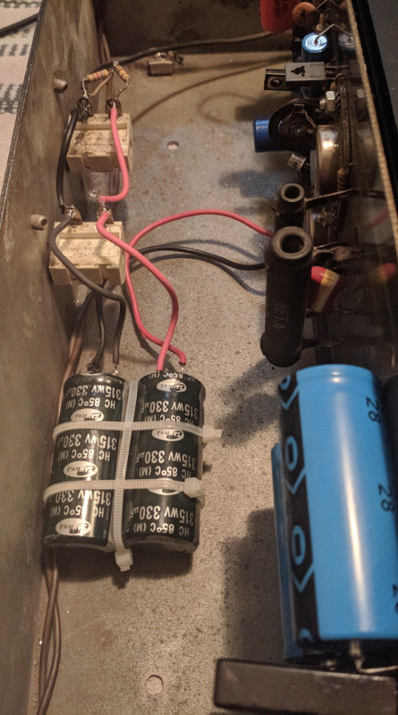

well i'm a bit ashamed !!!
I had given up on this amp and was back on a valve amp i'm building
had a bad distorded noise with that amp. Could'nt find the problem.
Rings a bell ? Bad fuzzy sound ? can't find the fault ? DAMN ! what if it's my f*** test speaker ???
BINGO !
My speaker is fried ! With another speaker my valve amp was flawless.
How come i did not think about it earlier...
Well, back to that SS amp.
I don't know why my speaker fried but it must have happened as i was working on that SS amp. Might be a coincidence or not, but i get 400mV DC on the speaker output. Is it enough to fry a speaker ?
Well, i don't want DC so i installed 2 big 330uF before speaker out. Now i get 0mV DC accross my speaker and i was able to test the amp with another speaker. Good sound ! That amp is working.
Now i have to deal with some slight "hiss" so it's not over but damn, what a fool...
Thanks a lot for your help anyway ! still need to get rid of the hiss !

About the hiss. This is so old it probably has carbon comp resistors, which hiss some at 100 k and above. I'd replace the 82k and the 100k with metal film resistors which were audibly quieter in my ST70 amp. Vishay, multicomp, welwyn have all been fine.
You may get away with 25 vac signal passing through a 315 WV electrolytic cap, but I put them back to back for speaker test. If the 330 uf capacitor has no + pin, it may be plastic film and hence perfect. Except for not passing much bass. 2200 uf speaker cap is more usual. My ST120 has 3300 uf at 60 W/channel. I've got 40 year old 6800 uf series a 10000 uf minus to minus I use for speaker checking amps under repair. It makes a little distortion at low volume on high frequency signals as top octave piano. Look at various speaker protection threads for better long term monitoring of your amp DC and disconnect. Dual nfets is compact, requires almost no heatsink.

changed my wiring so the 330uF are back to back (minus to minus) and one + connected to speaker + and the other + to amp out +.
On my first wiring one cap was useless (from amp ground to speaker ground...)
i'm good with the power amp now. thanks !
